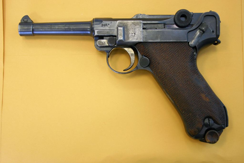

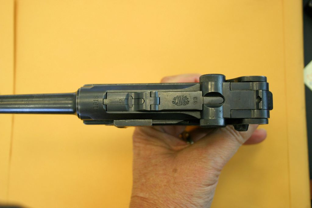

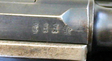

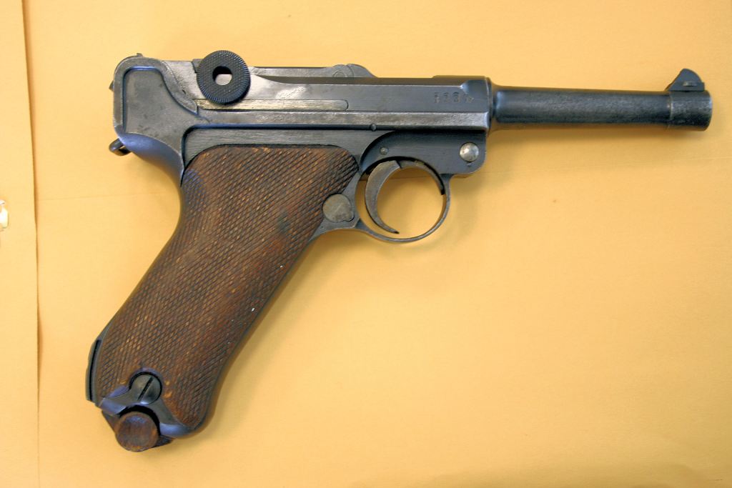

Thanks, Marc.
I am adding pictures for better information. My friend has this gun and we are discussing a reasonable price for it. My limited Luger knowledge indicates this a fairly common Luger (correct?), with no holster or accessories.
As I understand it, the right side proof marks indicate that it is German military. Are the left side proofs the same? I understand the far-right mark of that grouping is the Imperial mark...have not identified the other 3. I don't have a picture of the clip.
Opinions as to true value of this gun? Thanks for any help.

I think you are pretty much on the money with your own description. A fairly common WW1 gun in about average condition. I'm not sure if I'm ready to relegate it to the shooter column just yet, especially if ALL numbers including the magazine match. I'm thinking that a very good cleaning and oiling, AND having Hugh facelift the grips, could make it fairly presentable. But actual condition is hard to judge from these photos.
Regarding value, still unclear on matching mag. issue, but ballpark $750 as-is, to maybe $1000 tops.
Anyway, you have a nice Luger there, just take care of it and enjoy!

Can you post a picture of the bottom and sides of the magazine? If all correct, that would add some value to the pistol. More toward the higher of the values David quoted.
The grip does have the "million dollar chip" so would warrant having Hugh look at it to repair and clean them up. I would clean the rest, but never attempt to refinish or alter it.
I also agree that if all matching, it's at the lower end of collectable.

A member here, Hugh Clark, is an expert at restoring and making grips. He is, in many people's opinion, in the top tier of people doing this work.
The small chip broken away from the upper right corner of the left Luger grip in your picture is the "million dollar" chip. It considerably reduces the value of many Lugers. It happens when the grip is improperly removed.

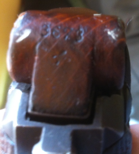

Now have the gun in hand. Seems to be all original/matching. Looks a little better in person.
Thought I would post a photo of the clip serial number, which matches.

I would have two doubts -
(1) Magazine - The base doesn't look too good, whether fake or not. I would not count on this 'matching magazine' as adding any value to this Luger (and might possibly cost more to regain functionality).
(2) Is this a real buddy or just a casual acquaintance? Maybe someone you know from the local gun club or corner bar?
If it is a real friend, a sale like this can impact the relationship for years...On either side...There are those who think any Luger is worth thousands...And that they are all 'rare'...And therefore worth whatever high value the seller can find on GB or GA...
The bottom line is that this is a common Luger with most likely a troublesome magazine; well worn, without accessories, and could use some obvious repairs (and possibly some not so obvious).
I would vote for the $750 estimates. If your friend insists it is worth more, wish him luck.

The wood bottom doesn't look fake..might just be the photo but beat up and possibly varnished.
More importantly..what does the body of the magazine look like?

Postino - I am not clear about the clip comment. I realize the photo is not real clear, but the numerals certainly appear to be original and well worn, with patina, and the clip fits quite well.
Number looks crooked...Probably the angle the pic was taken at...Font looks OK, as does the +...
Old Luger magazines are the most common cause of problems. The base of that one looks shiny...Does it look like it is varnished?
Post pics of the entire mag, including any close-ups of markings. Might be a desirable magazine in its own right.
Consider getting a Mec-gar magazine to shoot with. Display that one.
