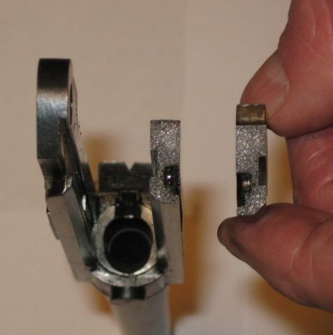

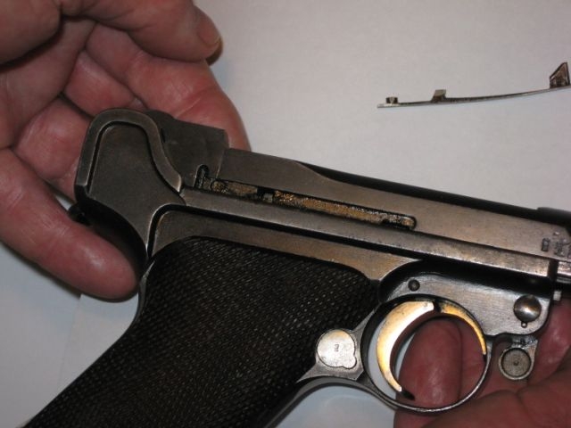

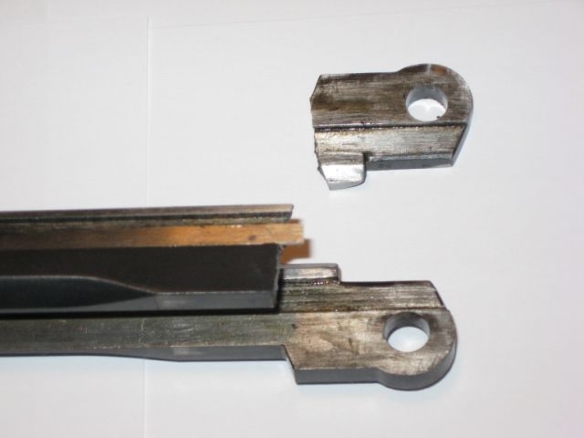

Unread 08-30-2012, 03:02 PM   #4
Can you see the pictures now? In answer to your question, no, it's not common, but as you can see, it does happen. Regards, Norm

Posts: 3,920
Extractors break too...
Blowback into breech blocks that don't have relieved firing pins blow out the back of the breech block that holds the firing pin spring retainer.
