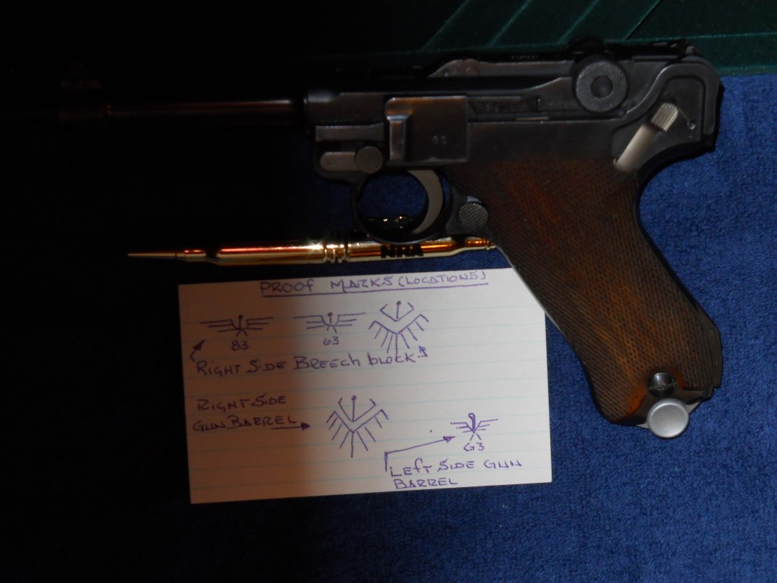

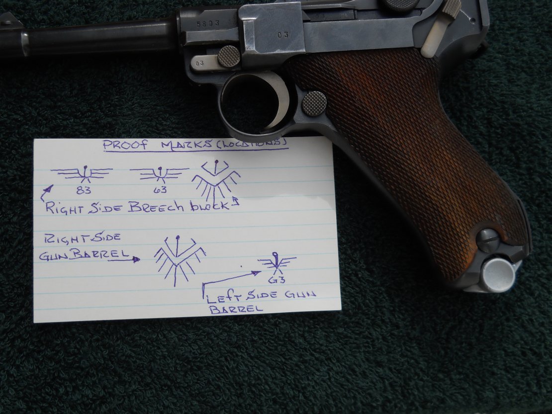

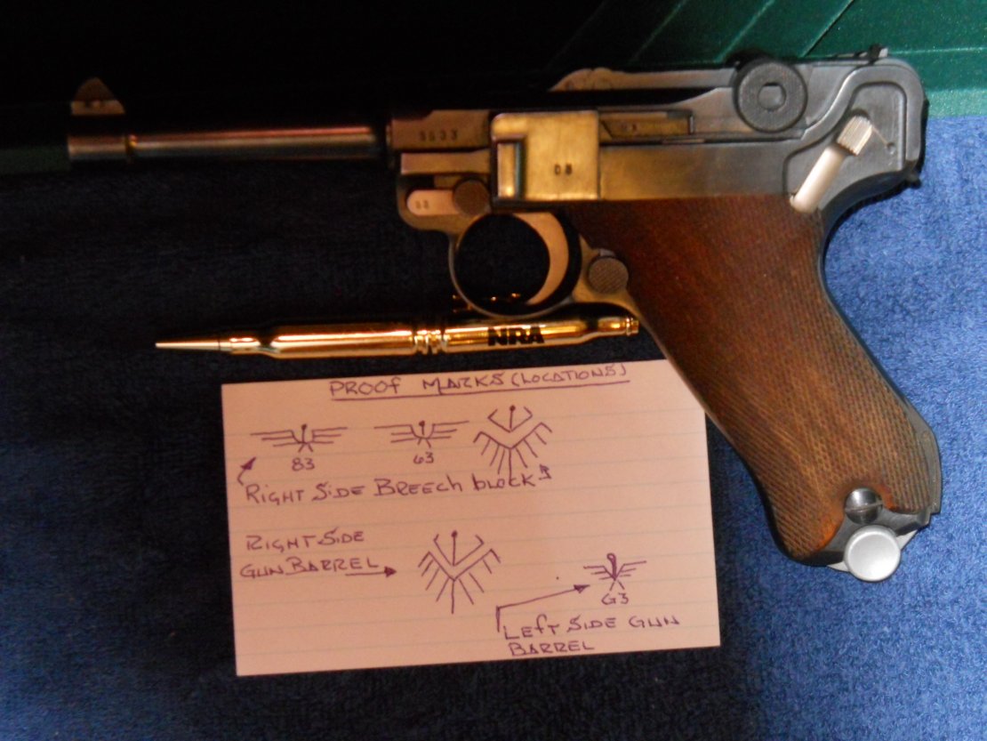

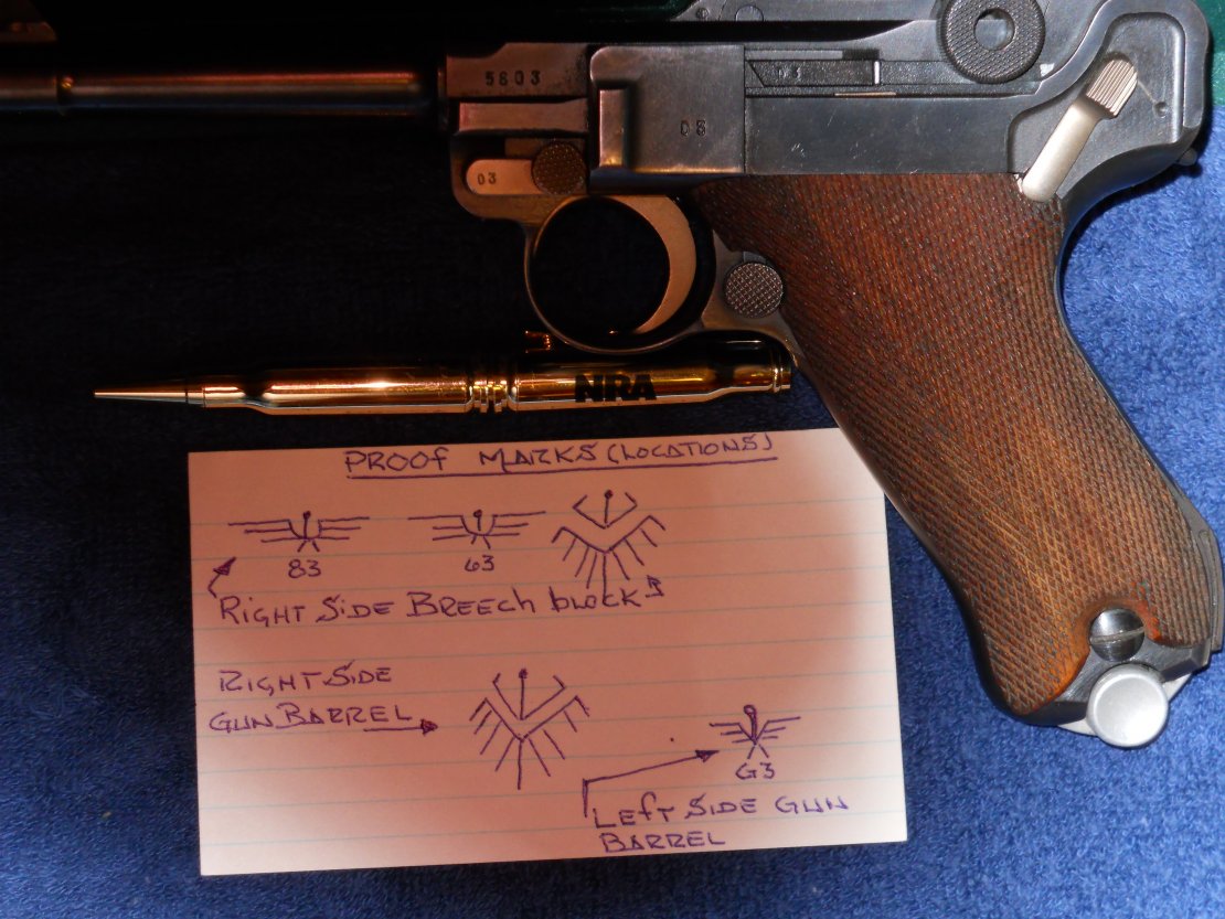

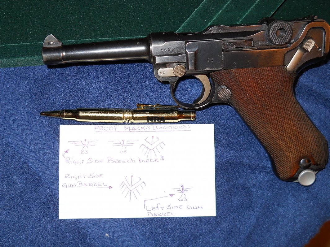

I am attempting to add a few photos that should help ID this Luger. Bubble bursting is OK if it results in information gained.

Unread 07-27-2012, 06:21 PM   #7
ok, the markings you are showing are the acceptance and proof markings, expected to find on a 1937 luger
What works best, is separate pictures of the top, left, right, and some close ups.
It would be good to show the bases of the magazines
One of the magazines is either a post war or a swiss magazine (the bottom one in top picture)
Unread 07-27-2012, 06:39 PM   #8
There is something about the straw coloring on the trigger and especially the safety lever that concerns me, sort of like they were bead blasted and then re-strawed. Too much smooth frostyness to their finish, lacking the tool marks.
Then it could be the glare of the lighting.
Some closeups of the gun might help my tired eyes.

Unread 07-28-2012, 07:52 PM   #12
Jim, Welcome to the forum.
Take your pictures outdoors using indirect (shaded) light. Use a tripod, and set the camera to the close focus mode (it usually looks like a flower graphic).
Use the self timer to eliminate camera shake. If you can control the focus, do it manually, otherwise try repositioning the camera until the focus on details is sharp.
The strawed parts do also impress me as having been redone in some way. You wouldn't expect the frosted appearance.
Unread 07-28-2012, 08:12 PM   #13
Hi Jim, As others have said, the strawed parts on this gun look redone. One almost always sees some blackening in the knurling on the take down lever and grooves on the safety on original straw, no matter how pristine. What is the serial number suffix of this gun? It's located below the serial on the front of the frame. Regards, Norm
