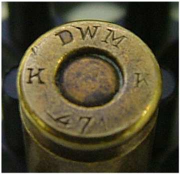

I have two original 7.65 Luger cartridges, headstamped -
DWM
K K
471
Both are round nose FMJ...
There is only ~.325" of bullet protruding outside the case; that doesn't leave much room for truncation...

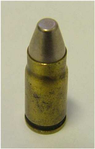

Here you go

Vlim, from what I can measure on the screen, that looks like about a 4mm(.157) flat on the nose. As always, thanks much for the great foto, I think many of us here on the forum have never seen a 7.65mm round with a truncated bullet.
I will definately use this info for the bullet. Again, thanks a lot..................RayT
