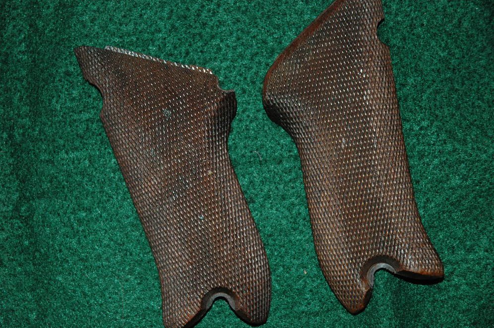

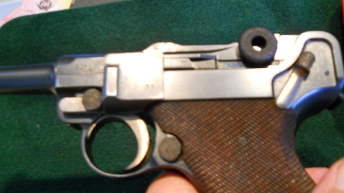

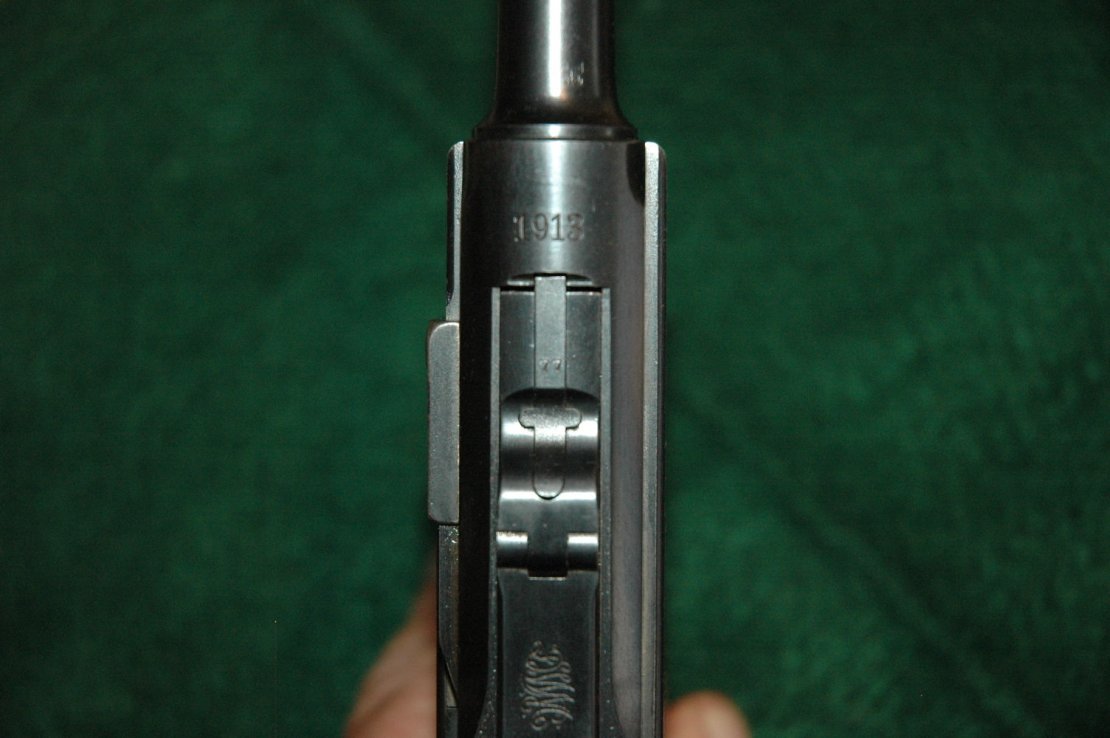

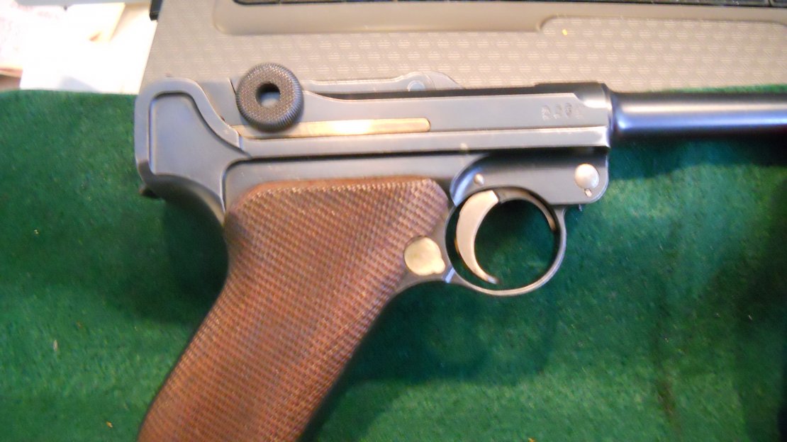

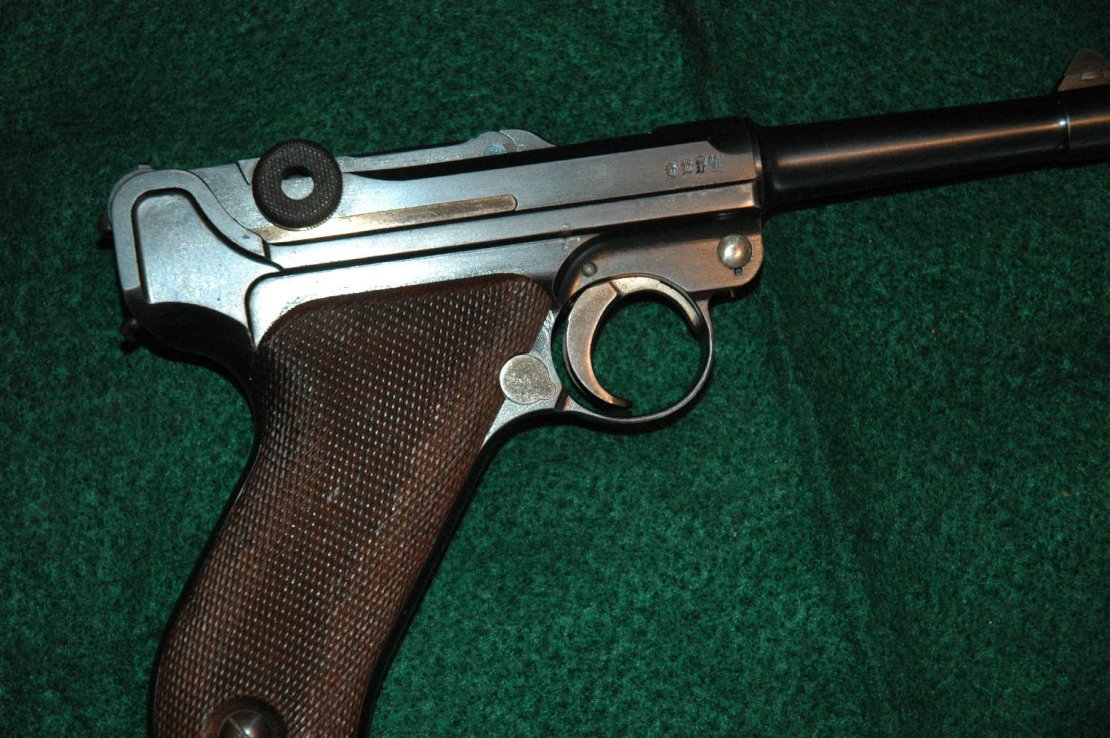

I just purchased my 1st Luger...... 1913 DWM with all match numbers except magazines.. Can anyone give me any info on this gun ???

Hi Larry, Welcome to the forum! You have a very nice DWM Military (not Commercial) Luger. When originally issued it had no hold-open, but was retrofitted with one. Regards, Norm

Wow! For a first Luger, you got a dandy.

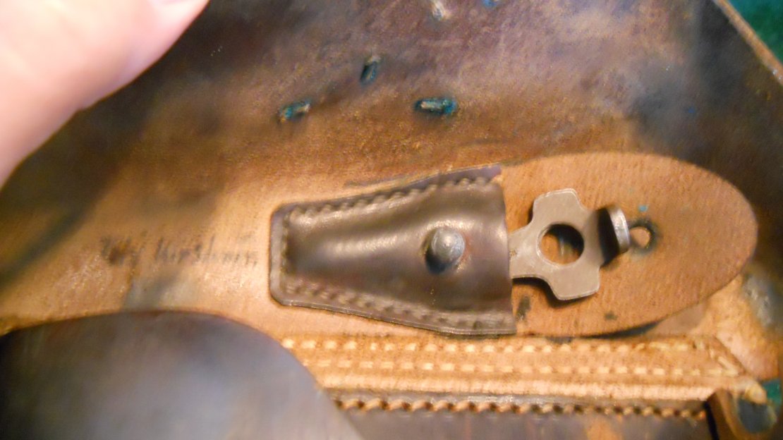

Thanks Guys, Makes me feel good that I did "good" first time out......The one pic is the back side of the holster that came with it. I'll try to post more pics of the holster and the mags..

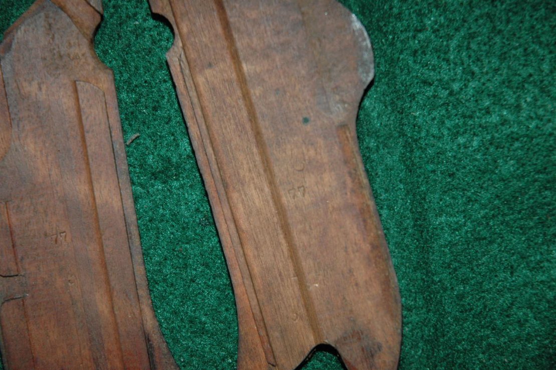

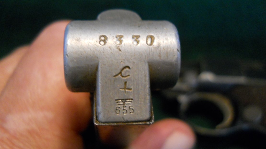

Here are some more pics of my "prize"............Any info and/or input is more than welcome. Pics are of mag bases and holster

Some 1913 dated Lugers have a unit stamp on the grip, may be yours, too . May I see a picture of the tool, please.

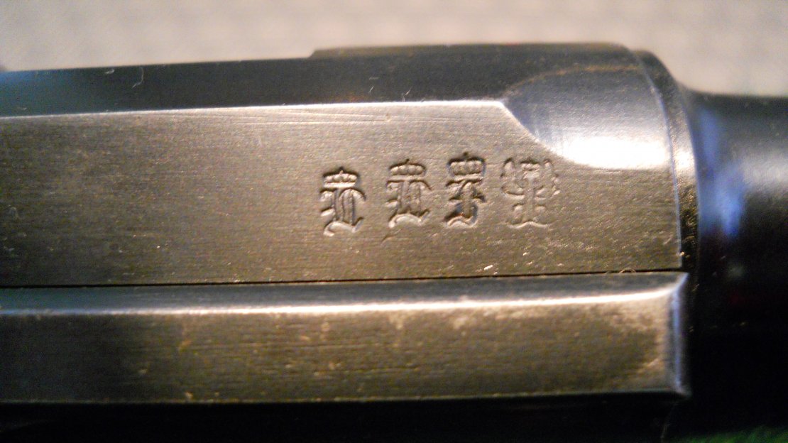

Looking closely at my "prize" with a mag. glass, I found on the bottom of the barrel below the serial number...a stamping that looks like 8,3 3. Anyone know what this means ????? I 'll try to get more pics.....Thanks, Larry

That number represents the measured dimension of the bbl. between the lands. They are usually in the range of 8.81, 8.82, 8.83. Since this I.D. is a little more than a tenth of a mm smaller than the 9mm slug, the lead or jacket gives way this much, causing the slug to ride the lands as it exits the bbl., establishing its spin. I think the middle number is actually a misstamped or deformed 8. Look more closely. On a refinished bbl. sometimes they have been worked down enough that the numbers start to disappear.
Unread 07-20-2012, 06:57 PM   #12
It is 8,83 and is the measurement of the bore from land to land, indicating it is a 9mm pistol.
Hah! David types faster than I do...by a whole minute!

I looked again. It is 8,83. Thanks for the info........Larry
