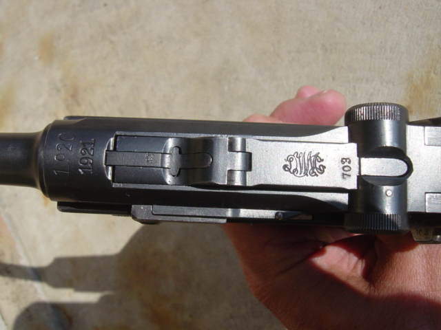

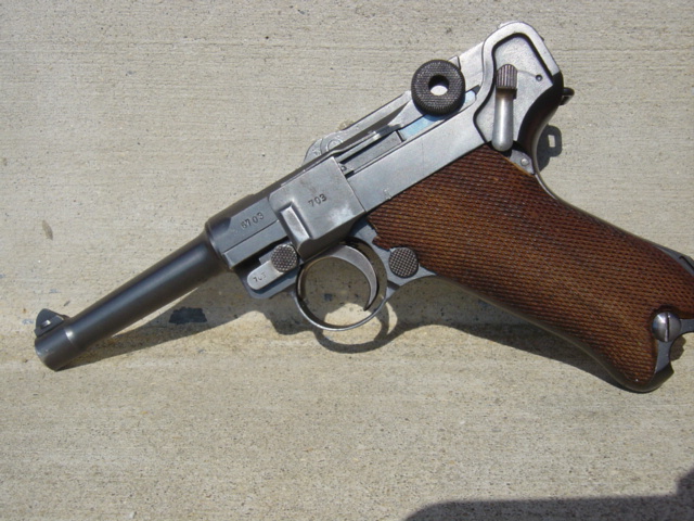

Here are pics of the Luger. I'm pretty sure my father got it from my Grandfather ( WWII vet ) but it looks like, from the bring back papers , he got it from someone else. I am interested in the history of the gun mostly, as I plan on keeping it , but an estimated worth would be nice for insurance purposes. I have the Bring back papers with it also, but not sure if I should post it with the names in view, ( probably doesnt matter )

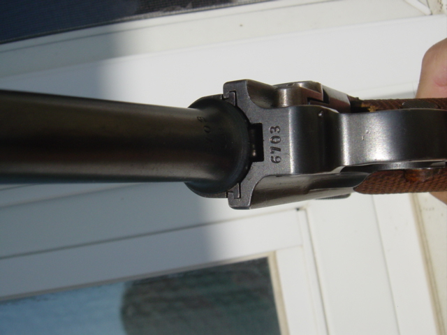

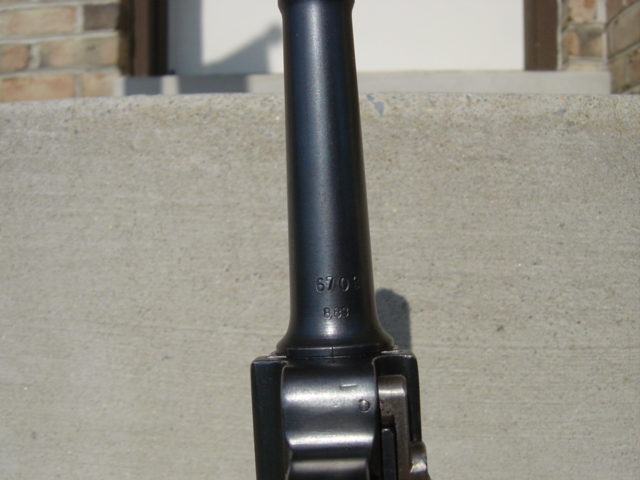

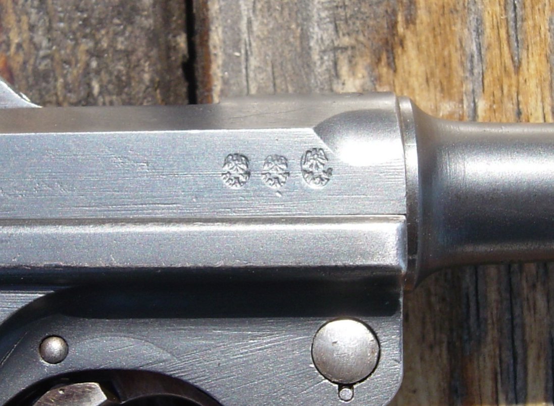

I'm particularly interested in the receiver markings, I couldn't find them using a google search. Also the serial numbers look like they all match , but I have not dissembled it yet.

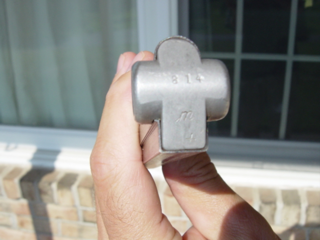

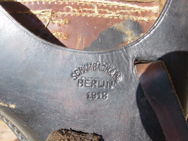

You have a post WW1 Police pistol made by Deutsch Waffen und Munitionfabriken in 1921. It has the State property mark of 1920 on the chamber as well. Very nice condition..
The holster is a late WW1 1918.

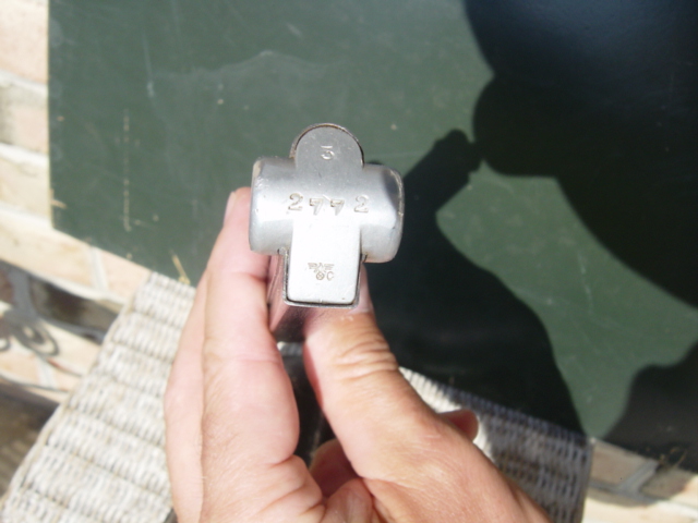

The magazine Eagle c 3 is a Police 3rd spare magazine. The other 814 m + is an Army spare mag.
This pistol was made for the reichswehr Government to arm the 100,000 man German Police force allowed at the time.
From the notch in the left grip it has had a magazine safety installed and removed. Might be remnants you can see inside when you take it apart.
Has the million dollar chip in the grip near the safety.

The notch Jerry is referring to is on the front/top of the left grip. This is where the trigger extension of the magazine safety came through. The pistol also has a sear safety, which is normal for police used Lugers. Good looking piece.

Is it common to see the mid section of the toggle train with the last THREE digits from the serial number? The same for the sideplate at such late pistol (I had seen on 1900 commercials though).
I don't remember to have seen it before, but I'm far from be an expert on Weimar Police Lugers.

I also made some headway on the receiver markings, The first stamp on the left is the" AYA4 Eagle is the 1920/21 Weimar Military Police Proof" meaning this was the first stamp added maybe?? The second looks identical , correct ? Why would there be two in a row? And the third is another type of Military Police proof?
I got that info here http://www.phoenixinvestmentarms.com...eimarpol21.htm
And why would the gun be made for the Military police, and then a policeman grind off the grip strap marking?
Thanks again for all of the info !

The missing chip on the upper right of the left grip just means someone removed the grip carelessly. Whether or not the gun was well cared-for depends on its condition.
The magazine and sear safeties were installed pusuant to an August 1933 order. The magazine safeties proved to be a bad idea and were ordered disabled in 1937.
The markings on the right side of the receiver are E/ArA4 and are inspection stamps of the Ausrüstungsamt which was the name of the military procurement office in the early Weimar years. The inspection stamps were applied at successive stages of manufacture. Your pistol was manufactured in early 1921. Soon after, this office was renamed Waffenamt and later markings on 1921-dated DWMs are E/WaA4. The third stamp may be a WaA but I can't tell from the photo.
The 1920 and 1921-dated DWMs were manufactured for both police and military and procured through the military. Your gun was probably issued immediately to the police and received the 1920 government property stamp unnecessarily.
As to why the police unit marking was ground off, my best speculation is in my earlier reply.
I would be very leery of historical explanations by PIA. They are way out of date!
Don

Douglas, I haven't seen three digits used on a toggle either!

BTW, I too thought the three digit numbering was unusual. Back to the reference books...
