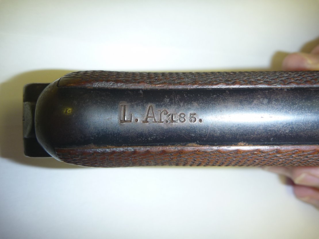

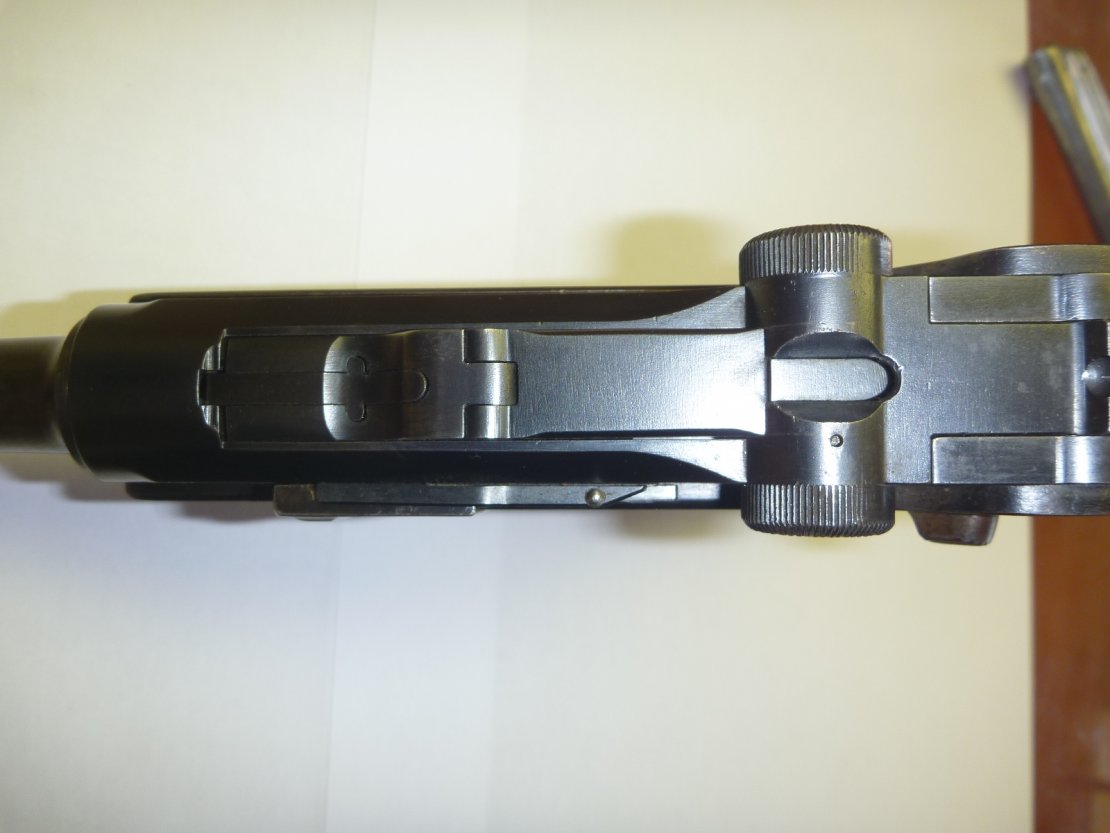

I was just shown a nice police Luger with the following Unit Mark;
L.Ar.185.
This appears to be a Wiemar era commercial Luger. The only marks on the gun are the following;
Proof: Eagle, Wa, Eagle. Eagle Proof on Barrel

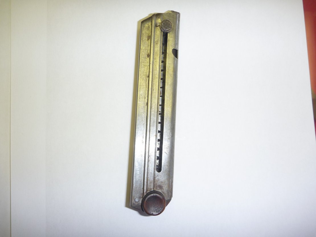

Serial number is 3313 u on frame and barrel. "13" on last toggle back. Toggle axle marked "13". No nitro proof, no manufacturer on toggle, no chamber marks. Matching wood bottom Mag 3313 (no u) and number 1
Sear safety present, magazine safety removed. Wood grips look correct, period but no marks inside
Finish is original, (nice halos on barrel and unit marks) with only typical holster wear and some additional wear on the sideplate. Straw is strong on ejector, takedown and trigger, less so on safety but all appear original.
Initially I need an answer to the unit mark. This gun will be for sale but I am looking for an honest valuation as soon as I get photos up.
Thanks, gents!

Landjägerei Arnsberg.

It looks good to me, especially with the matching mag. While I wouldn't call it rare, it is desirable (to me, at least --- I own one). See pp. 198-8 of HWIS for other examples.

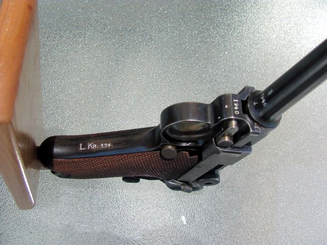

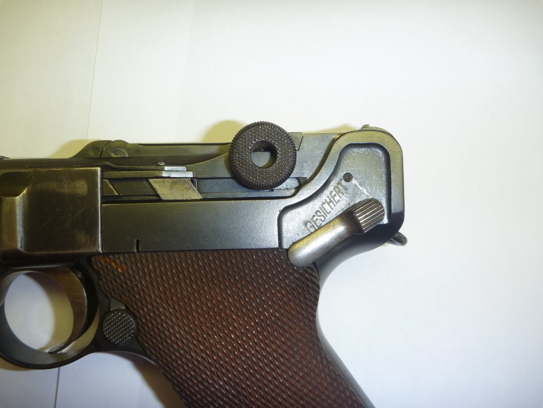

Unread 06-15-2012, 09:55 AM   #9

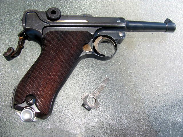

Default Is my police luger related
I wanted to submit mine for comparision..

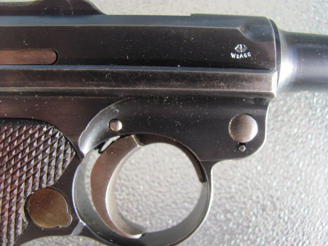

Called a "Sneak" in marketing / collector parlance. A 1929 BKIW ( transition from DWM to Mauser) found in s, t, and u serial suffix with WaA66 proof. They are found with both, blank toggles, and DWM toggles.
The term "Sneak" was coined as a marketing ploy to add mystique. Supposedly produced without a date to keep the Allied Commission from knowing that Luger production had started again.
The current general consensus is that they were simply assembled from parts in inventory, and no date was thought necessary.
While not rare or scarce, but not extremely common, and desirable to unit mark collectors. I've seen them priced from $1400 to $2000+ based on condition, and scarcity of the Landjägerei unit mark district.

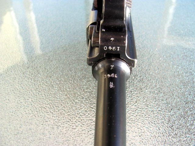

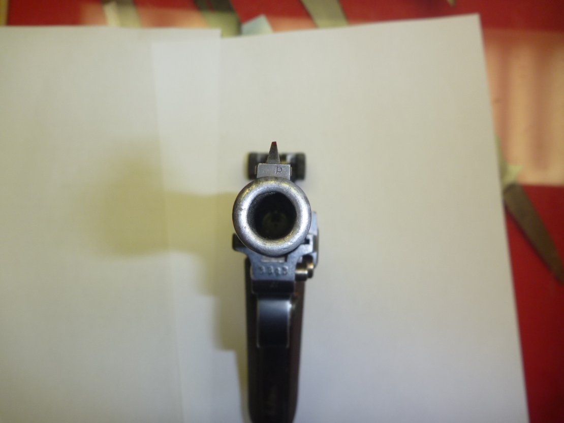

Unread 06-15-2012, 08:50 PM   #13

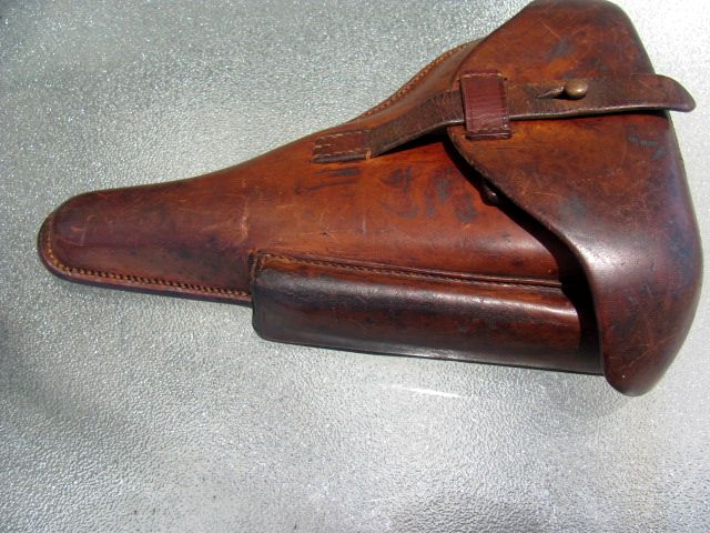

Default You have a great opportunity
Your matching mag it proved this was probobly own by a Police Officer.The one I have was not as lucky. Instead you can make out an owner very light name. What history. Their values can only increase. Donald Maus and His sources has done so much to increase the collectablity of each piece yet often bypassed. Once 'Lugers At Random appeared a whole market appeared. Collectors feel more confortable with a Policeman then a nazi brand. Keep it. Add a police holster and your golden. Eric, Esq

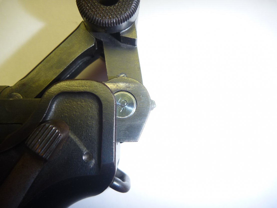

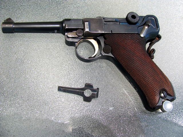

Unread 06-17-2012, 08:28 PM   #18
Default I Took A Picture of the cute little proof
Were they on all police guns?
