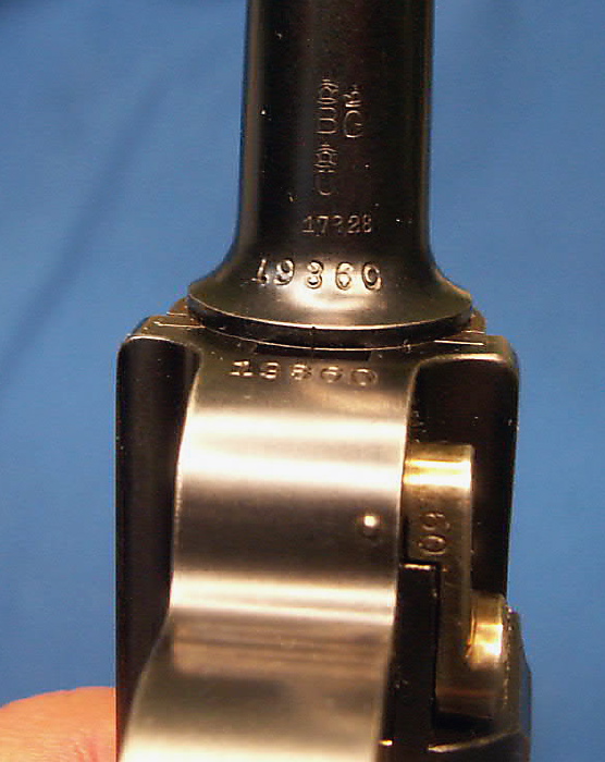

The show was light on lugers. Mostly civil war and old west. One a KI, not a KU, was represented to me as a 1933. Mauser frame, KI on the chamber, Erfurt toggle. Pretty beat up.
What????
But I had 'Luger Lust'. Gotta buy something... so I made a beginner's move. Bought something without studying the books first.
So, now what do I have? My reference books have little on info concerning these.

Unread 05-21-2012, 11:10 AM   #25
Thanks: 1,123
Fred,
Got your email. I am away from home right now and can receive but not send emails. I'll respond when I get home. First impression...looks loke a very nice late production 1900 Commercial.

Fred:
According to the data that I could find, Ron is correct, which is what we would expect. The 1900 commercial serial number range was 50-19,627; so your 19,360 fits in there nicely. According to the data, there were only 5,750 of this version made. So, besides being a beautiful example, it is apparently very rare and desirable. Hopefully I read the data correctly and haven't made another stupid mistake. Good catch.

Thanks all. Where/what should be marked? How does one remove the extractor? How does one remove the toggle lock? Or should these things be left alone?
Unread 05-21-2012, 12:40 PM   #28
Thanks: 1,123
There is no point in removing them. They are not marked internally.
The extractor is removed by lifting up on the forward end until the little lug on the bottom of the extractor clears the corresponding detent in the breechblock, then pulling forward out of the breechblock. Very easy to damage the extractor in the process.
The toggle lock is removed by drifting out the pivot pin in the toggle knob. The lock has a small spring inside at the top that can easily be lost and it is really fiddley to try to hold all the parts together while re-installing the pivot pin.
I highly recommend leaving them alone. Even for someone experienced with their removal, chances of marring or damage are high and IMHO not at all worth the risk.

Super nice 1900.
Why is there another number under the barrel? Is that standard practice in this serial neighborhood?
I mean, the number below BUG, 17x28 (I could not read the middle digit)....
Unread 05-21-2012, 11:34 PM   #32
Thanks: 1,123
Alvin,
That is the early designation for caliber...it is 178,28 or the number of lead balls of 7.65mm diameter necessary to weigh a pound.
