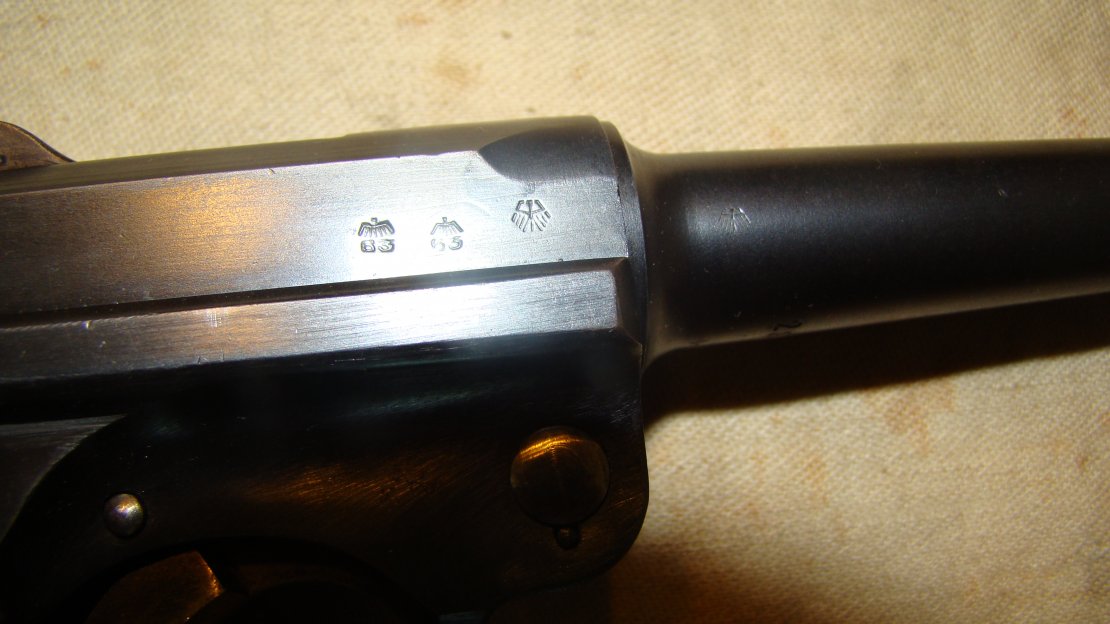

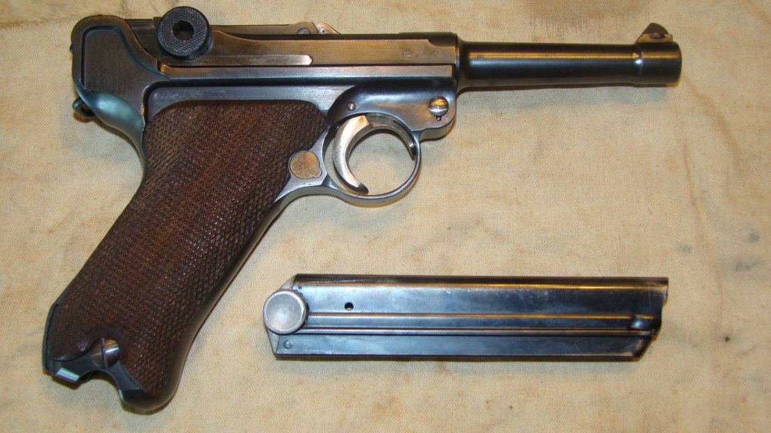

I have a Luger with a few proof marks that I need help identifying if anyone could. I have attached pictures to show the proof marks. Besides what the pictures have in them this pistol also has 8.83 stamped on the barrel as well as S/42 on the top of the pistol. I know it means Mauser was the manufacturer and it was made specifically for the German Military. Also I know the 8.83 is the ID of the bore which would be 8.83mm. Is that a .380 or 9mm? Finally what is the best way to clean this pistol without damaging it? I was going to just wipe it down with gun oil. Any help identifying the stampings on this pistol would be greatly appreciated. If you would like more or better pictures let me know. Thank you very much! Also under the two sybols on the side of the pistol is the number 63 any ideas what it means?

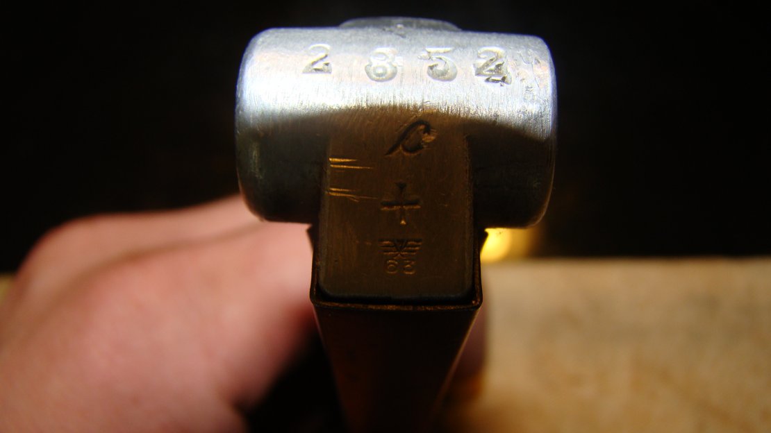

Check Youtube for disassembly videos, using great care when lifting the left grip panel. Clean and light oil is fine, no oil where it will soak into the wood grips. I'll let others comment on proof nmarks, but he magazines look to be "boosted" or "force-matched" to me. More pictures would be nice.

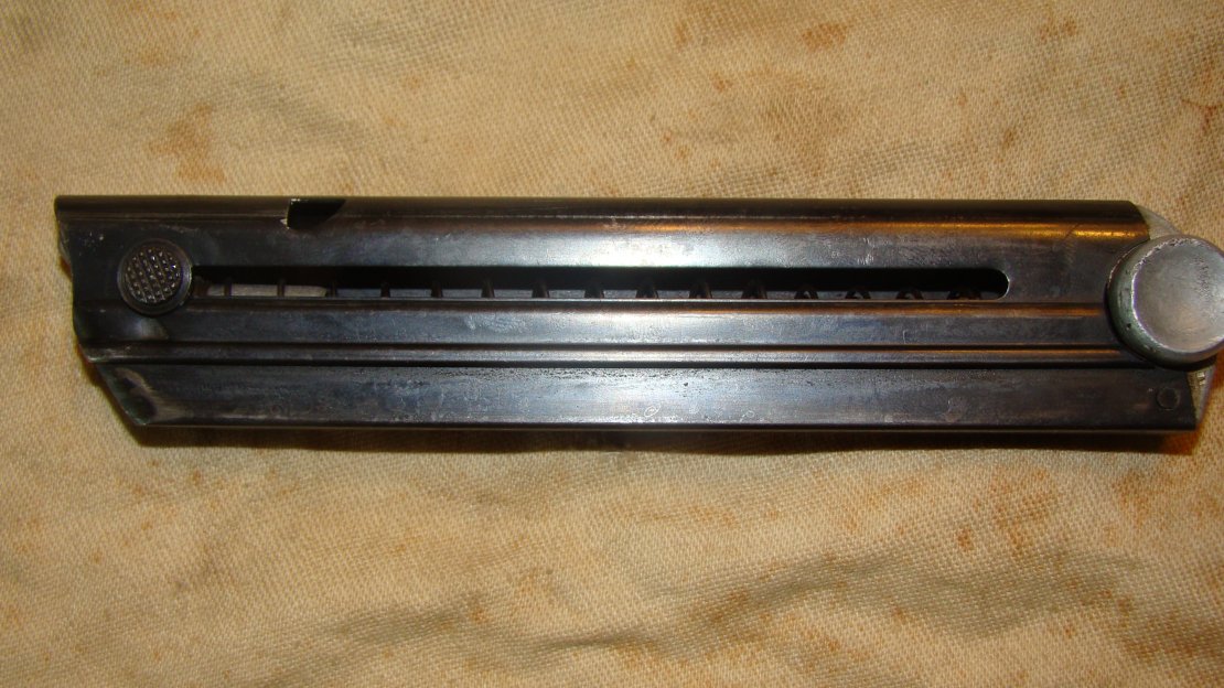

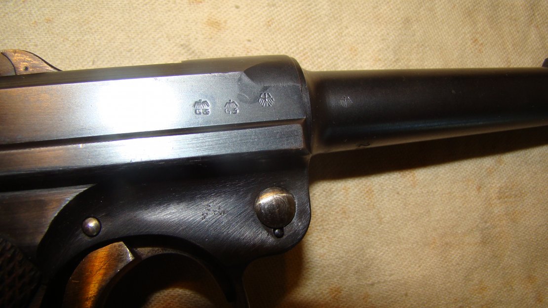

Thanks for the cleaning tip I will look into it. What makes you think this clip is boosted? I am just curious about it. Thanks for you help if there are any specific picture you would like to see of this pistol please let me know other than that here are a few more. Any idea where I could find an owners manual or if they even made them in 1937? Thanks again.

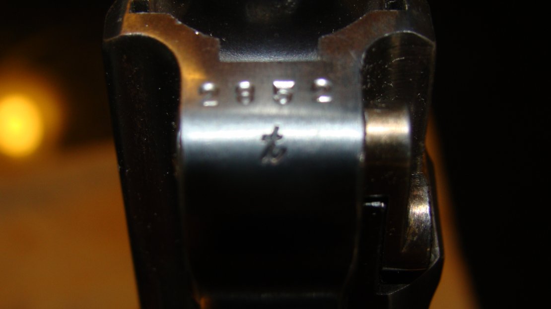

The magazine is "boosted" because at the very least the last two numbers, it not all, have been overstamped to match the gun. You can also see where the magazine bottom has been sanded down to try and make a clean job of it. Unfortunately, the faker did not know enough about Lugers to realize that the Letter Suffix is part of the pistol's serial number and these do not match. Your pistol shows a "T" suffix and your magazine shows a "C" suffix. Thus, it is not matching to the gun and now worth less than if someone had just left it alone.

What exactly does the "T" suffix mean? Any idea on the proof markings or the 63 below the proof marks on the pistol? Thanks for the help.

The "t" is part of the serial number of your pistol. Every 10,000 pistols, (as they went from 1 to 10000) the suffix letter changed. S/N 10000s was followed by S/N 1t.
The proof marks on the right side of the Luger's receiver are the result of proofing the Luger with a high pressure round and overall inspections by the Weimar military weapons inspection office accepting the pistol. The number "63" refers to a specific inspector.
Your Mauser manufactured pistol (made in 1937) has a frame with the Mauser "hump" at the rear. That hump was introduced progressively during that year.

Perhaps I am misinterpreting a scratch at the top of the base as a number one. The magazine is real. It is an early model that is stamped and folded, rather than extruded. The base has a proper Eagle over 63, (e/63) acceptance stamp. The "+" indicates it was the spare magazine for a pistol made in the "C" block of a particular production run. The original serial numbers have been removed and it has been re stamped to "match" the gun.
If it did have a number 1 at the top of the base, it might have been issued to the Weimar police, but since your gun does not exhibit any typical police characteristics, it is doubtful. (The police used "1" and "2" to indicate primary and spare magazine, versus the Army's no mark on primary and a "+" on the spare magazine).

The weapons inspection was generally done at the factory. The government office put an inspector in charge (who was identified by the number). The inspector had a small staff of people working for him that did the actual testing.
Mauser also had their own inspectors working along the manufacturing line as the process proceeded to a finished and proofed pistol. You may see a very small rounded "WR" stamp on internal parts surfaces. Before this unified factory inspection mark was used, quality control employees had their own personal dies.
