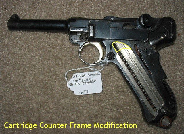

Hi Alvin, I don't collect these guns but I do know that their frames differ from those of regular AEs. The internal web has been machined away so that the slot in the magazine is visible through the grip. Regards, Norm

Like this:
Unread 04-29-2012, 01:24 PM   #23
Thanks! Frame modification a great point. I feel this CC is most likely real.

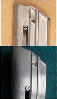

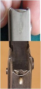

Thanks: 340
Thanked 143 Times in 48 Posts
Cc mag on GB legit? Item http://www.gunbroker.com/Auction/Vie...Item=284341470
Unread 05-03-2012, 12:06 PM   #28
Nope. Might be for one of the 1970s Mauser commemoratives since the index pin is so far down from the top of the magazine. I don't think the frame of the Mauser repros were modified. It certainly isn't a $1600 item.
