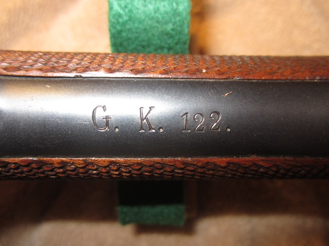

I've received the gun and wanted to post a picture of the marking. The seller provided some interesting information from Reinhard Kornmayer and Major a.D.hans-Rudolf v.Stein suggesting that the Garde-Kurassier would not have marked their pistols in the traditional "Eskadrons" order but rather continuous within the regiment. Is there any way to tell the difference between the Police style of grip marking and military? I'm not doubting Don's Police identification, it's just with the duplicate initials being used it does create a bit of a question. And following up on what Klaus wrote, would an entire regiment have 122 Luger pistols or would this number be too high?
Thanks again to all, this has been very interesting
Nick

Unread 04-28-2012, 10:13 AM   #17
klaus 3338
Join Date: Jun 2009
Location: Germany
Posts: 519
Thanked 417 Times in 162 Posts
That is interesting news that the Garde Kürassier Regiment had not stamped their Lugers according the stamping order. I can accept it because I remember Hans Rudolf von Stein very well as THE expert for German unit marks. I visited him some times because he lived only 35 miles from my home. He died about 20 years ago.

Unread 04-28-2012, 11:18 AM   #18
Don M
Don M's Avatar
Join Date: Aug 2004
Location: Houston, TX
Posts: 1,429
Thanks: 67
The marking on Nick's Luger has the identical font & sizes as G.K.128. illustrated in HWIS on p. 258. While there is no documentary proof, I continue to believe these grip strap markings are most likely those of the early Weimar-era Hessian Gendarmeriekorps and the chamber G.K. markings are Imperial-era markings of the same force for the reasons enumerated in HWIS. In addition, the inventory numbers on the grip strap markings are significantly larger than was specified in the 1909 instruction (2.1 mm). Even if the Garde Kürassier did not include squadron numbers, I suspect they would have used the specified font size for inventory numbers.

Unread 04-28-2012, 06:13 PM   #19
klaus 3338
Join Date: Jun 2009
Location: Germany
Posts: 519
Don,
at first I thought that it would be a Police unit mark but with the information from H.R.v. Stein AND Jans list :
1913 Erfurt, sn 321a, marked G.K.29.
1913 Erfurt, sn 403a, marked G.K.47.
1914 Erfurt, sn 2515 marked G.K.74.
1914 Erfurt, sn 2446, marked G.K.122.
with the numbers so close together it think that it could really be a Imperial unit mark.
The numbers are too close together .....
Best regards
Klaus
