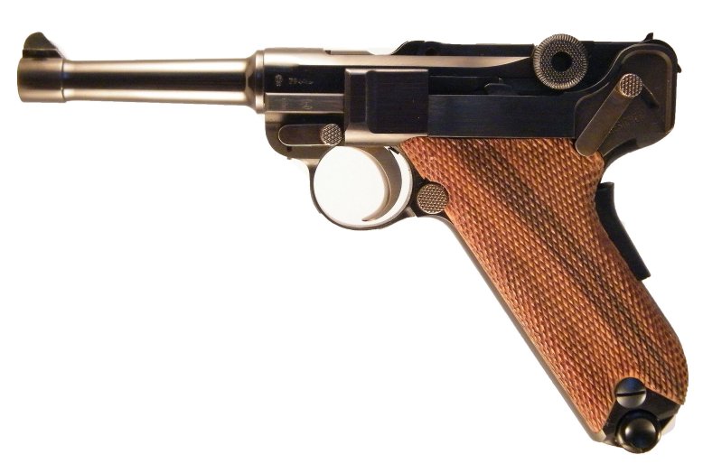

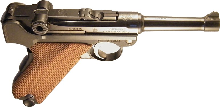

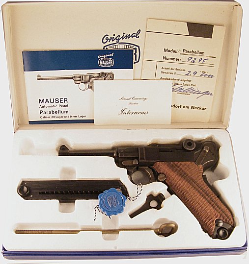

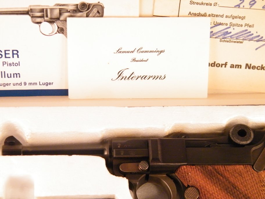

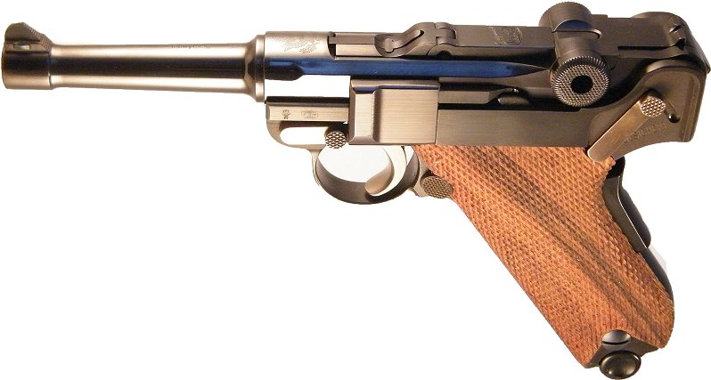

Here is one that never went to the USA. A 9mm Interarms contract that was made in 1972, proofed in Ulm in 1979 for sale on the European market. It ended up spending its entire life in the box. Curiously, the box also contained Sam Cummings' business card.

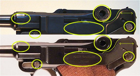

Gerben, how 'bout a quick pic series of the frame variations for a sde-by-side comparison? Interesting that there were 2 variants of the 29/70, and now I'm curious as to which mine belongs... Is there a difference in this curve between the 06/29 and the all Swiss Bern?

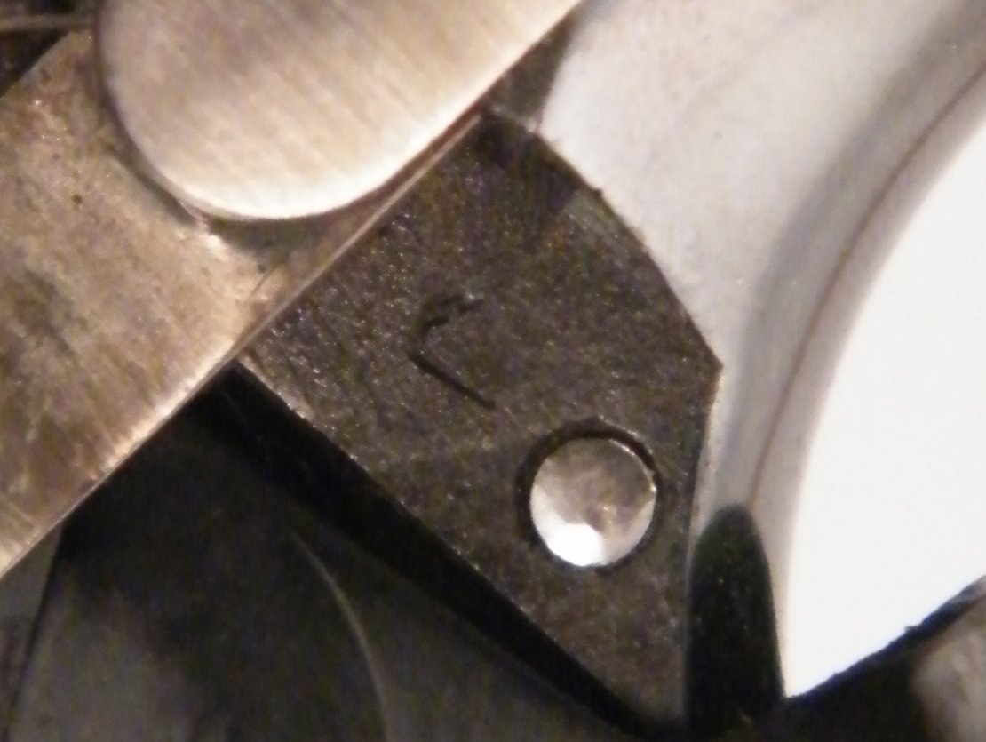

Yes, there is. The original 29/70 frame was a one-on-one copy of the Swiss 06/29 lay-out. Mauser overlooked the fact that the Swiss had played with the opening curve, tuning it to their standard barrel length and .30 luger army ammunition.
Mauser needed to produce different barrel lengths in different calibers, causing functional problems. They did some comparative tests with Mauser and DWM p08 pistols, and found that the Swiss had altered the curve which caused the toggle to break at a different moment.
They discovered this when the first 1000 or so frames were already being produced. The decision was made to reserve those frames for the .30 luger version and to mark the remainder with a heart shaped symbol just below the safety lever, so that they would not be used in other variations.
The top comparison was used to identify the differences between a pre-series Mauser Parabellum (bottom) and a 29/70 - 06/73 transitional pistol. So the other differences can be disregarded. The difference marked with the arrow is the one we are discussing here.

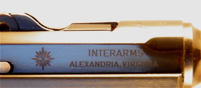

I don't know how to tell Euro from American? It does have a big Interarms logo on the right side of the barrel extension. I can post pictures if needed.

Hi, it's quite simple:
Euro pistols have no Interarms marking on the right side of the receiver.
US export versions have the FBM proof.
