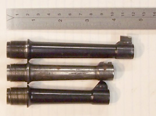

Most Tika arsenal replacement barrel are 5" long including the threaded area that screws into the reciever.
Tom didn't post a price [coff *Tom!* coff] but I thought it would be interesting to post a pic of three barrels I have lying here...Top is a Tikkakoski [9mm] 120mm barrel; middle is a military [9mm] 100mm barrel; bottom is a commercial [7.65mm] 96mm barrel...
(Macro pics tend to 'fisheye', so I tried a long-range shot so the ends wouldn't appear 'warped')
