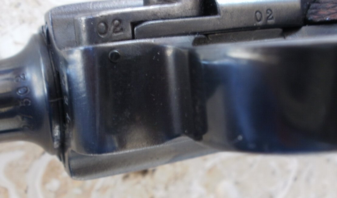

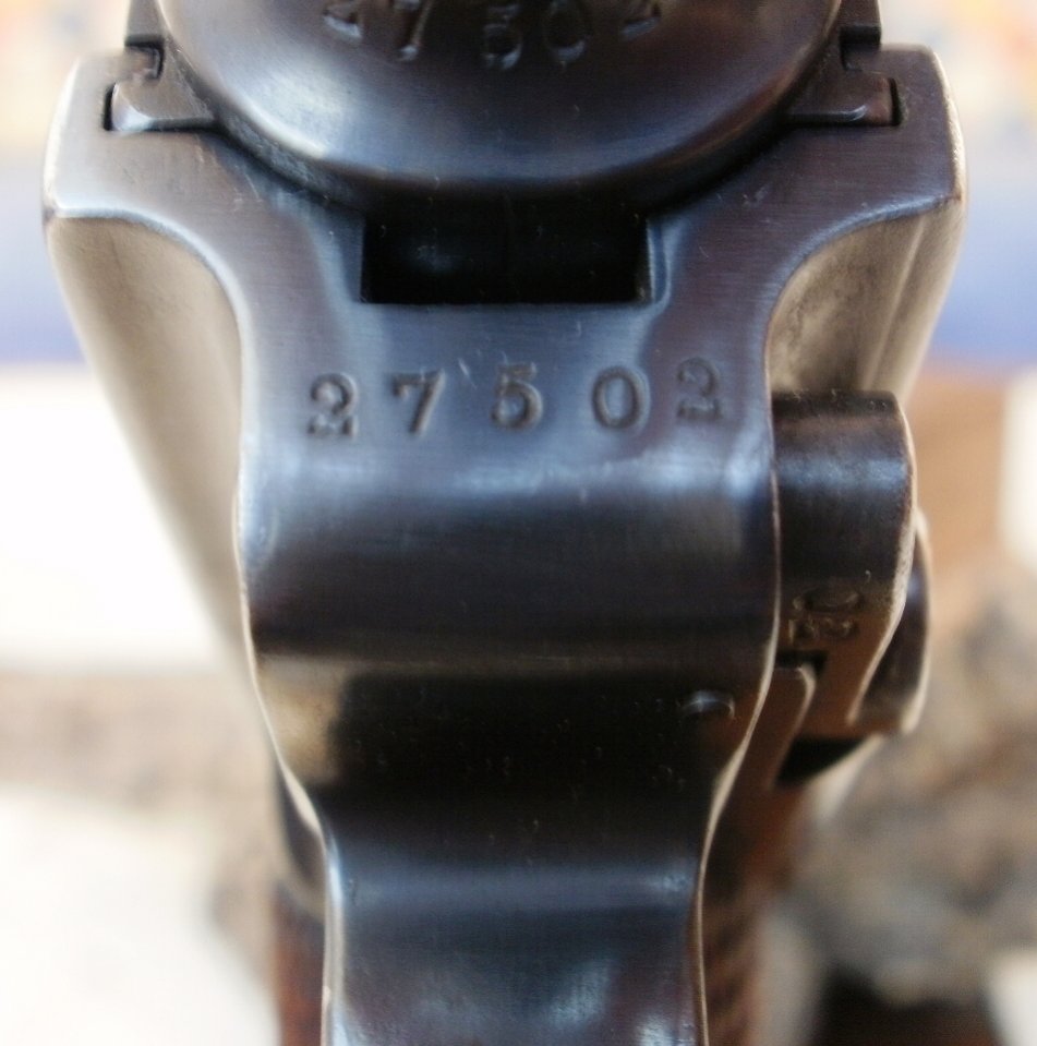

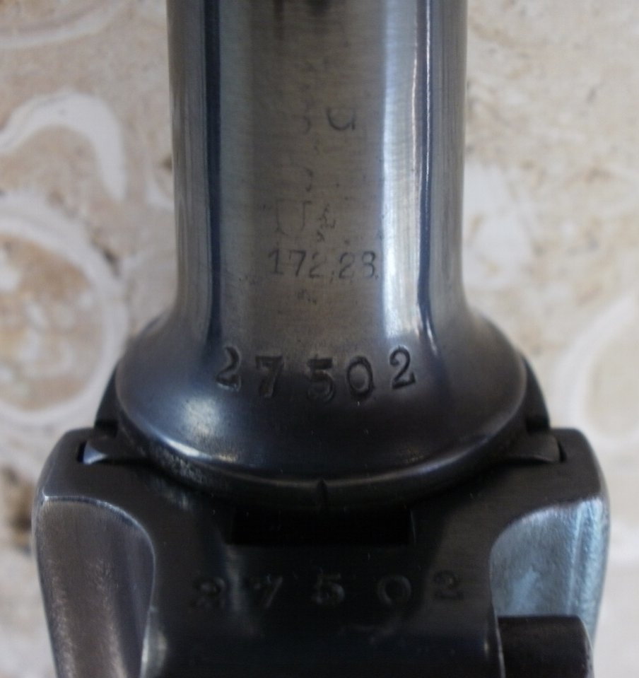

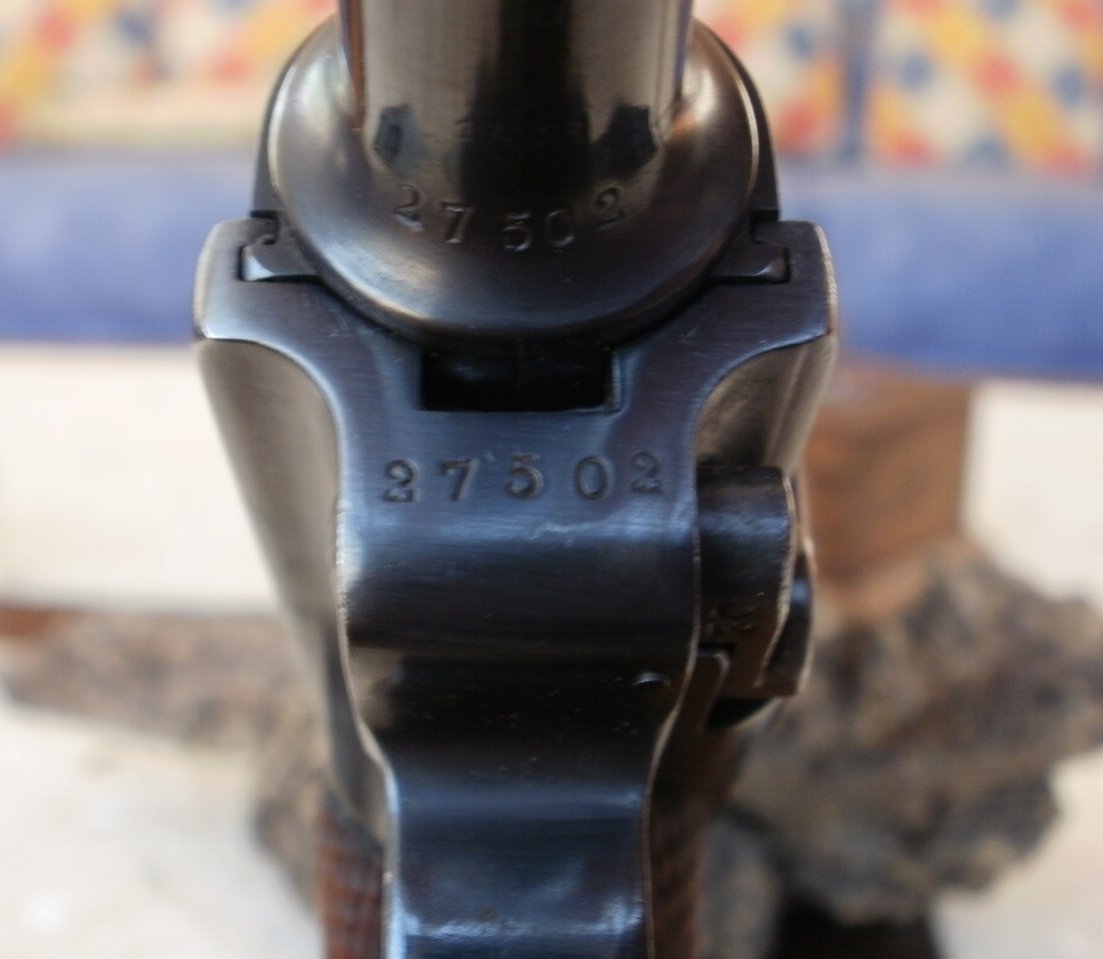

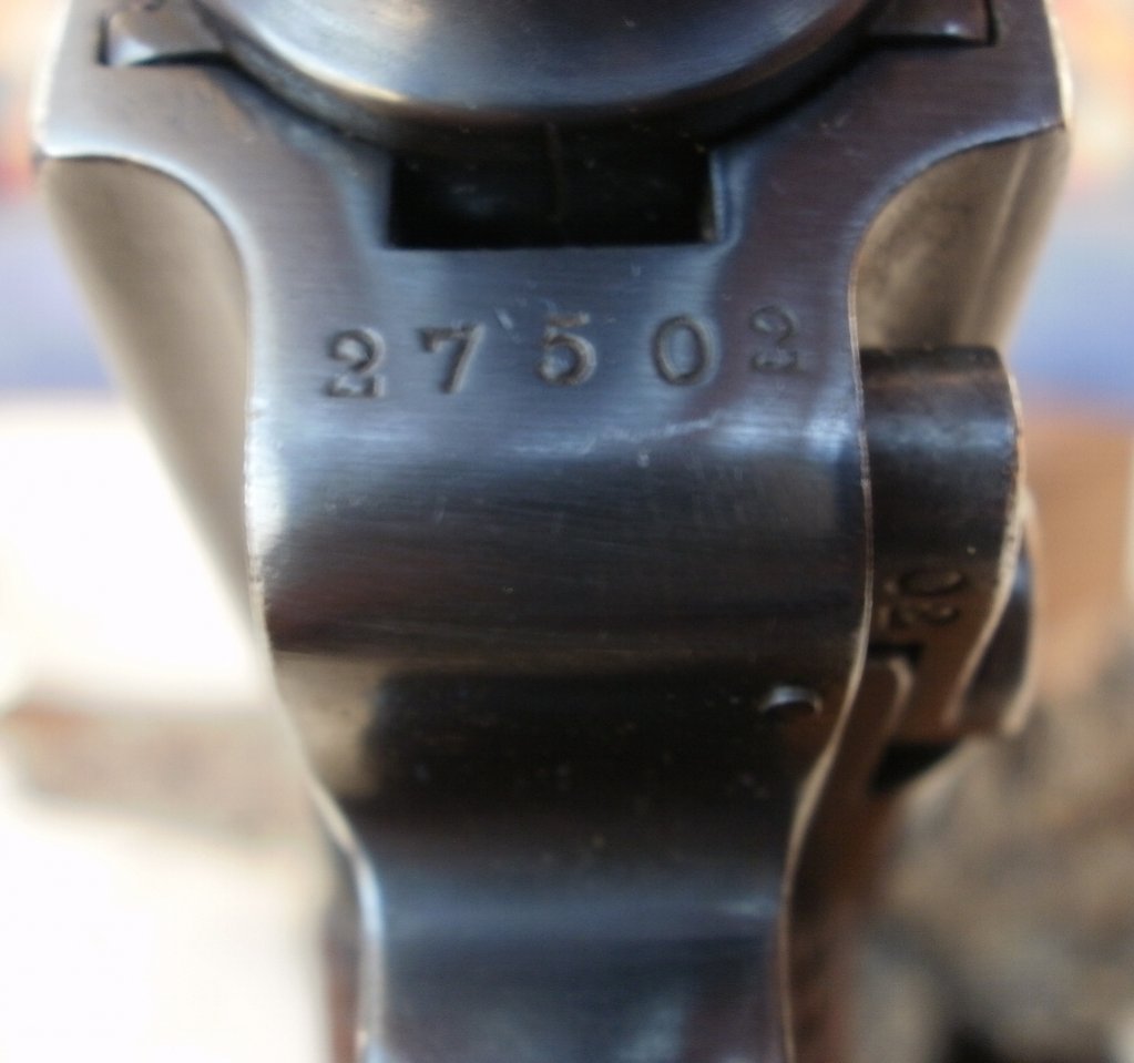

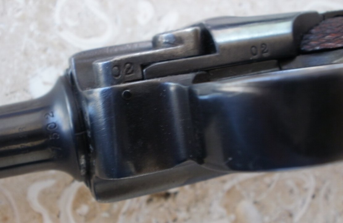

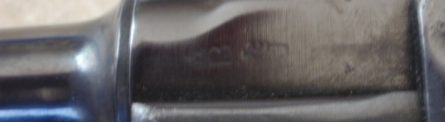

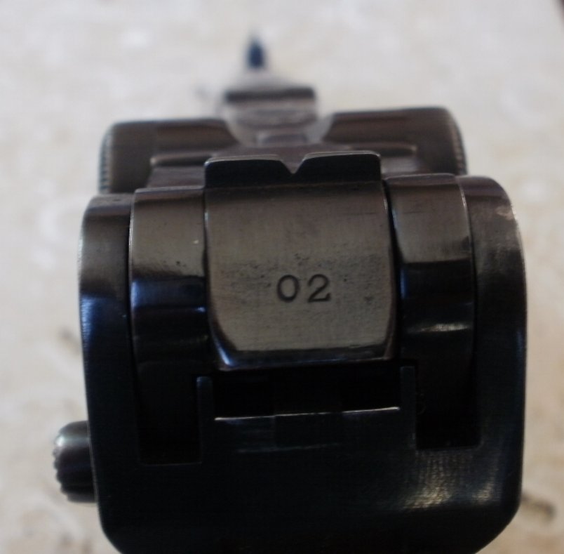

I have just received this pistol serial number 27502. Older reblue, numbers matching. Hold open is broken. No magazine (I threw it away). Your opinions would be greatly appreciated.

A little bit too shiny. Many years ago, an American expert summarized German pistol's finish being "edges are crisp, but not sharp. Surfaces are smooth, but not overly polished".

nice grips, the g on bug is polished clean off

Magazine was the worst immitation/excuse of a Luger magazine I have ever seen. I have sustituted for an original I had on hand. The disassembly lever (hope I have it right) falls off when the pistol is disassembled although it has the retaining pin (again, hope I have it right). Any ideas? Thanks to all for your comments. I believe the pistol was manufactured ca. 1907. Pinwheel and flaming bomb marks are present.

Sounds like you are missing the little L shaped spring that keeps the takedown lever in place when it is lowered.
Or it is so worn it no longer puts tension on the lever (I had one like that)...
Luger Doc will have those.
...or it is broken. Lugerdoc is your man. I think mine was $35.

Rugger et al, I do have new European made (just like the originals) PO8 TD lever springs available @$25 each + $3 S&H. TH
