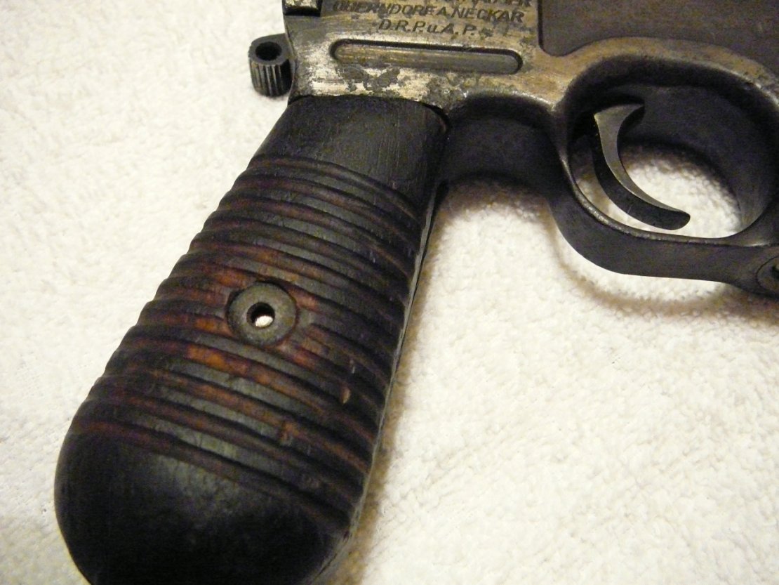

Found a 1923 Broomhandle for sale about 3.5 hrs away. He is only asking $750 so I am thinking it might be worth the drive. Just wondering your thoughts on this one.

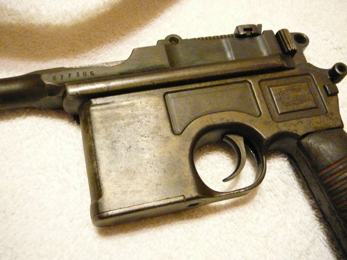

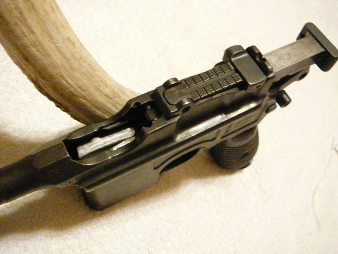

Sorry, here are a few pics.

Pretty rough shape for $750...and you can bet the pitting under the grips is even worse...
Locking block area looks OK...How's the bore???
Can't quite see the barrel...Is it an "M30" ('step' in barrel)???

It looks to be an M30 or 1930 Broomhandle by the step on the barrel. Looking at the back of the pistol as if fireing it, there should not be a serial number on the lower half or the pistol. The M30's supposedly have the serial number stamped on the barrel/cannon assembly and the rear upper half. Also take off the grips and look at what is under them. This can be a real sensitive area for rust. Also the frame under the grips should not be stepped.
Hope this helps
Peter
+ 1

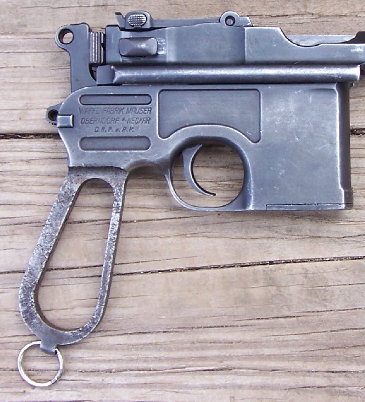

Here's a pic of my M30, which *I* consider to be in very good condition...except under the grips...

Thank you for the info. I will be requesting pics with the grips off.. From the sounds of it, doesnt look like I will be making the drive after all.

Well, it's a Model 1930 (by the serial number, stepped barrel and style of letters).
The gun, as mentioned above, is in rough, "shooter" condition. Loooks like it had been refinished or touched up with cold blue - note the difference of finish shades on the mag area.
However, the price is not that wrong. As said, you might get a better price with cash. But you need to check if everything is working properly. Try to get a three day inspection.

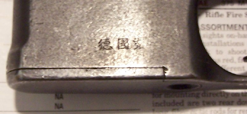

It's probably made in 1933-1934. Some M1930 in 88xxxx range were marked "德國製" (made in Germany) on magazine well, I would assume those Mauser were made in parallel with "日國製" (Made in Spain) marked Astra 900 in 27xxx range. They were so marked upon the request of an importer. And it's known Astra 27xxx were made in 1933-1934, so Mauser 87-88xxxx should be in the same period.

Some M1930 in 88xxxx range were marked "德國製" (made in Germany) on magazine well...
My 885460 has 3 Chinese characters on mag well; can't read them (I am dummie), let's see if I can bring it out...
(Mine is a Keng's import)

I can't read the third character but the first two stand for Germany, so it is probably 'Made in Germany'. I just don't want to be super assertive since it's hard to see the third character due to the slight glare.

After asking to see how it looked under the grips, he replied "it is pretty rusty". Thanks for all the wonderful info, saved me a road trip. I'll keep up the search.
