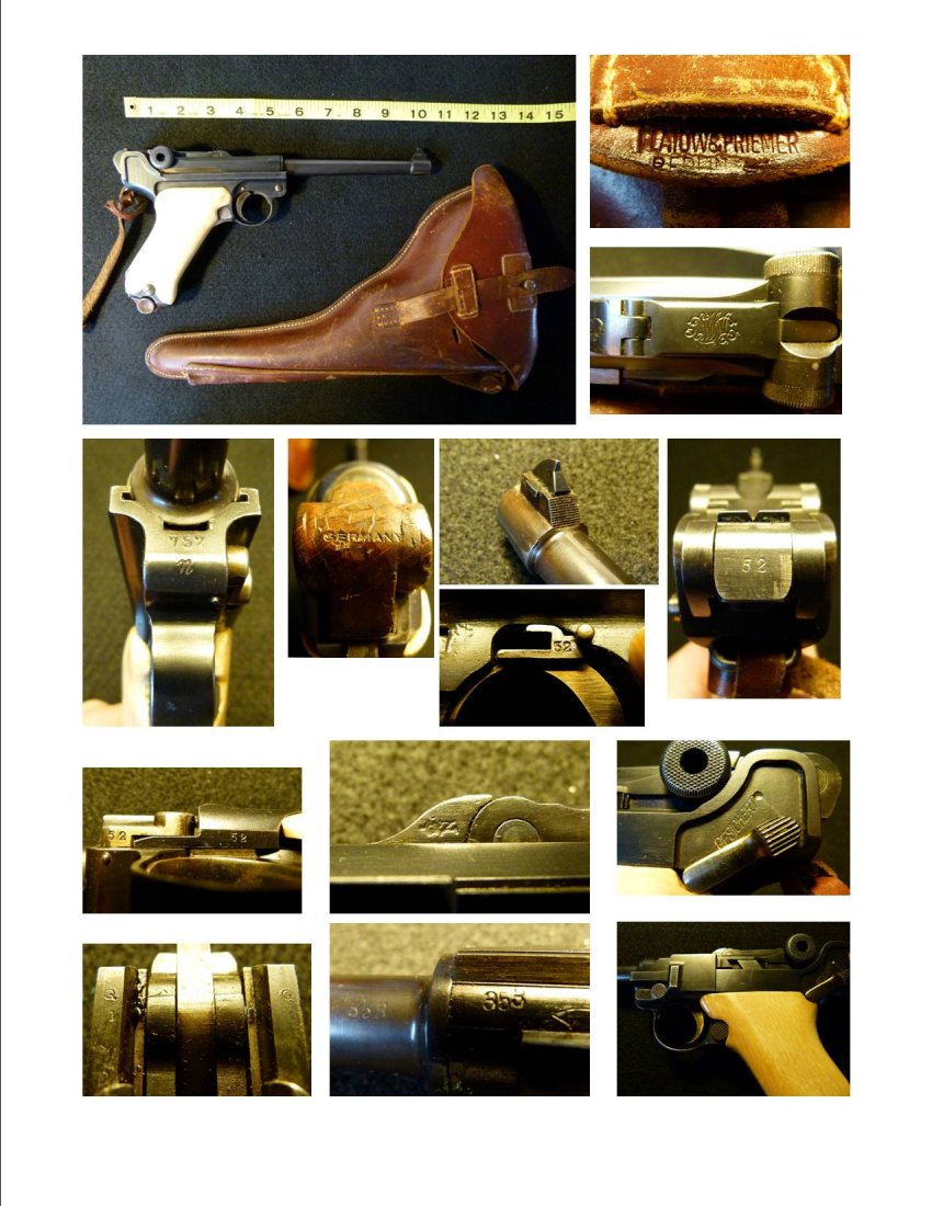

I recieved this Luger from my grandfather for my birthday. The only history I have of it, is that he inherited it from his uncle after he passed. His uncle was A.R. Wheeler, who was a Captain in the 312th Infantry, A.E.F., during WWI. how he obtained it, I have no idea.
I'm hoping to get some expert help in identifying this Luger and getting whatever background information that might be available.

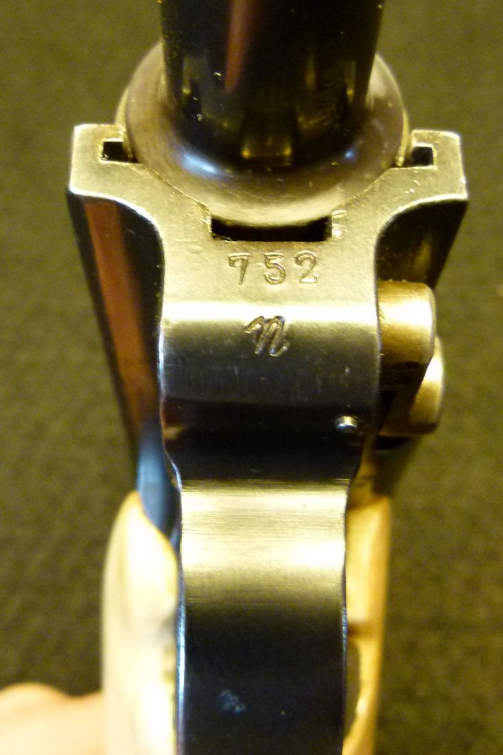

I believe it is a commercial Luger, owing to the lazy "N" with a crown over it. All the numbers match (752 N), with the exception of the barrel (353 A).
Any help you could give me, would be greatly appreciated.

You have a rebarreled commercial gun and a modified Artillery holster. The gun is not assembled properly, as the toggle is protruding out the back. This happens when the gun is assembled without the toggle link hooking onto the mainspring rocker.

Made in 1924 or 1925.

DWM exported these to the USA in the 1920s. Export guns have "Germany" stamped on the receiver like the stamp on the base of your magazine.
Before you take it out to shoot it, double check that you have the correct ammunition.
It is very likely chambered in .30 Luger rather than 9mm Luger.
You can test it by taking a number 2 pencil. If it fits down the barrel, it is 9mm Luger. If the barrel is too small, it's probably .30 Luger (a bottle neck shaped cartridge).
Both ammo sizes will fit in the magazine.

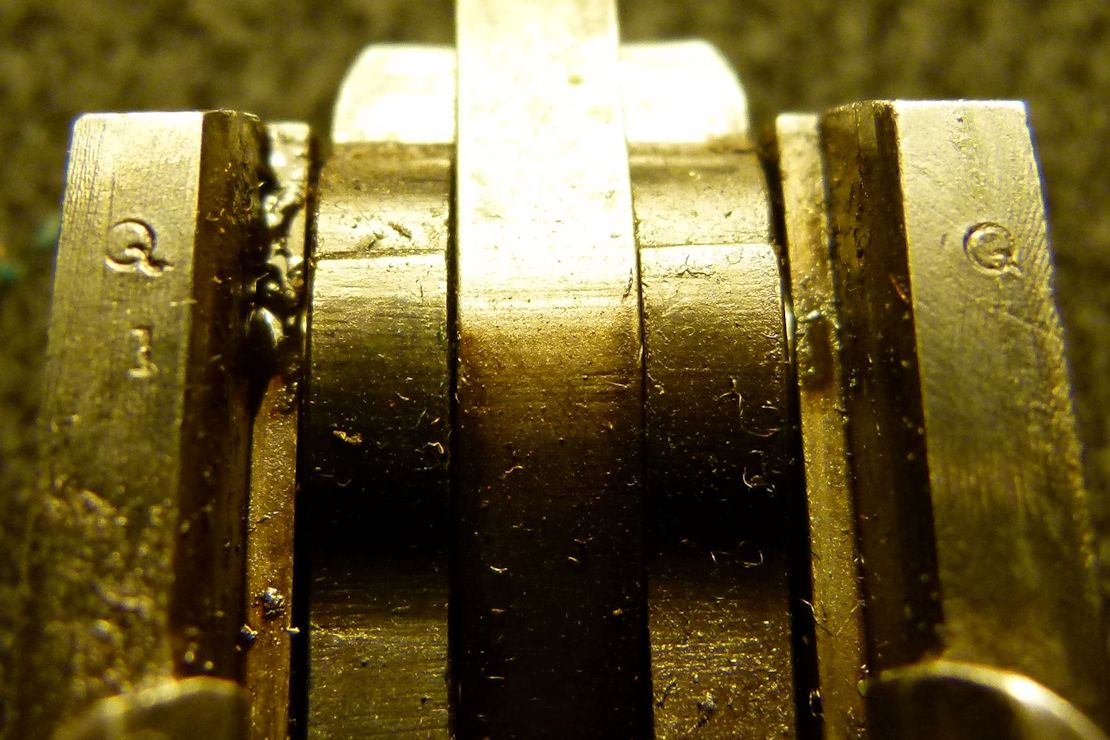

Hmm...no Germany stamp anywhere on the receiver. Just those curious little "Q's" with the number "1" on the left side.

The ivory grips are an aftermarket add on. They were never an issue item.If you are interested in getting this back to original you will need to purchase some wood grips and barrel. Bill

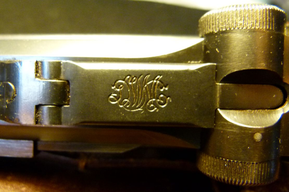

Post a closeup of the receiver proof marks and any other marks as individual pictures.
Some of these were re-barreled by dealers for customers that desired longer barrels.
Your pistol was put together from parts from multiple guns. It's hard to say when it was assembled.
For your records, document the serial number with suffix letter that is on the frame just above and in front of the trigger guard. That would be considered the full serial number of the pistol.
The ivory grips are not factory, as Bill says. You can get reproduction wooden grips, or original grips to replace them, or just leave them as a memory of your great uncle, your grandfather and his generosity.

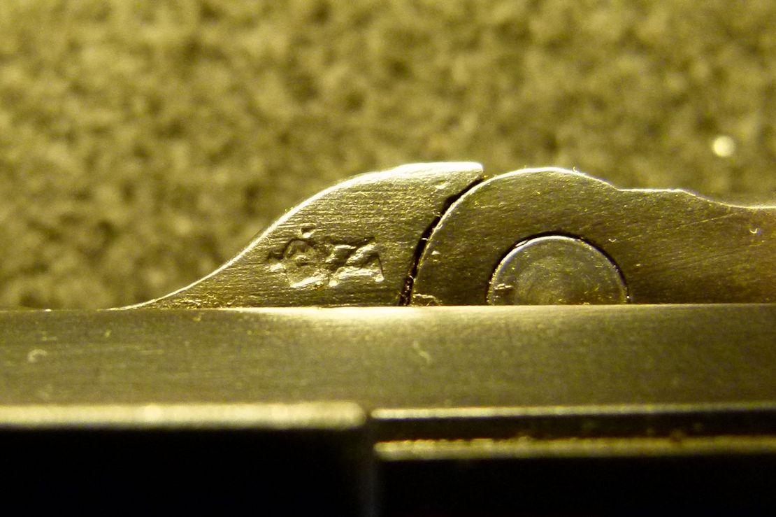

Here are some close ups of the markings, including those funny little "Q's" on the underside of the slide.

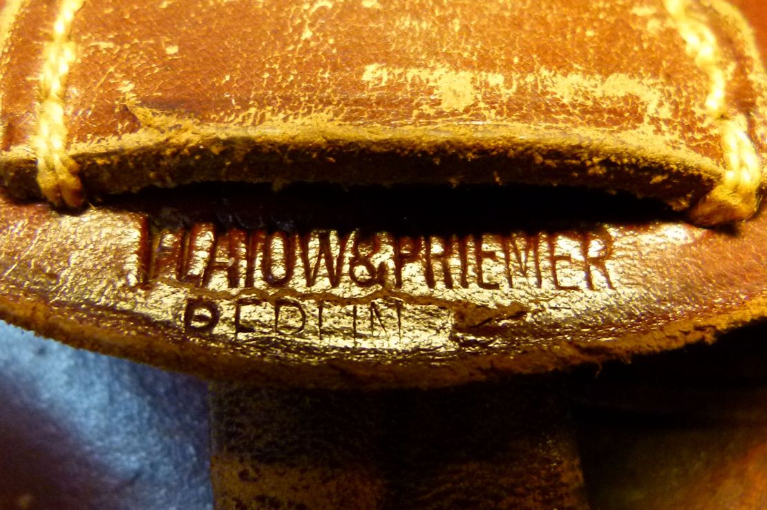

Oh yeah, and notice the double stamp of the "N" on the trigger guard, in the first pic.....

It would be interesting to see a closer look at how the closure stud was added to the holster flap. Your Artillery holster also has some value and if the modification is reversible, would be worth more.

I have never seen stampings in the location where the "Q" letters are on your receiver. I don't think that the factory would have stamped work marks there.

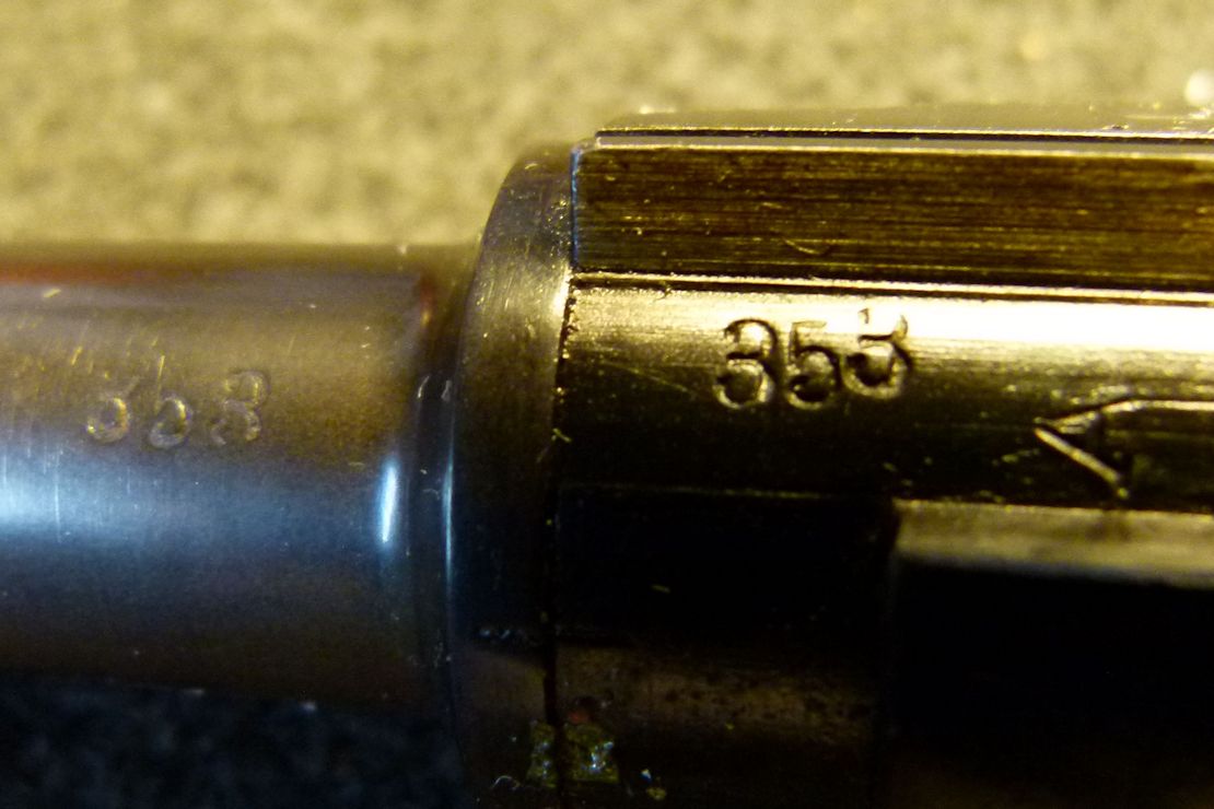

Also, the "353" on the barrel and receiver don't look like DWM dies to me.
My best guess is that the gunsmith that fitted the barrel to the receiver may have put the "Q" markings there to "sign" his work...
