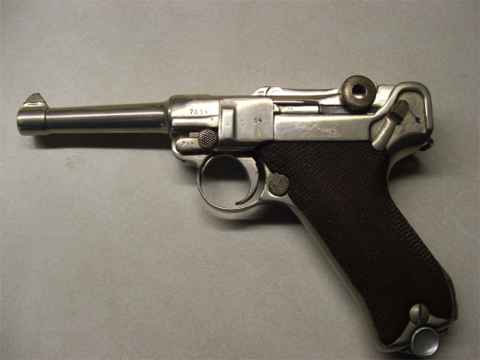

Default Nickled 1918 Erfurt!
Mine, a great shooter in 9mm, wouldn't think of changing it.
