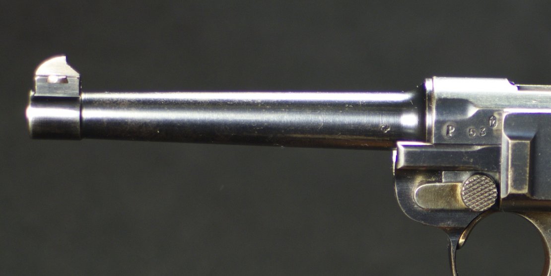

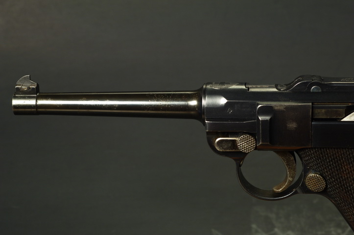

Hi, Here are front sight profile pictures of my
(top) DWM Swiss 1900/06 (with U shaped rear notch sight):
(bottom) And W+F 1906 (with "V" shaped rear notch sight):
Are these both the original (not replaced on the 1900/06 DWM) front sights?
Both front sights are blued, just the way the light reflected in the second picture...

Unread 03-22-2012, 05:09 PM   #6
MFC
MFC's Avatar
Location: Louisiana
Posts: 1,237
Thanks: 183
Marc.
It is easier to see from an angle but, I beleive the profile shows they are both original front sights. If they are wider at the bottom of the blade than the top (inverted v), they are probably original.
Mike C.
