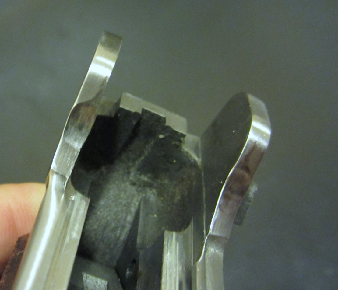

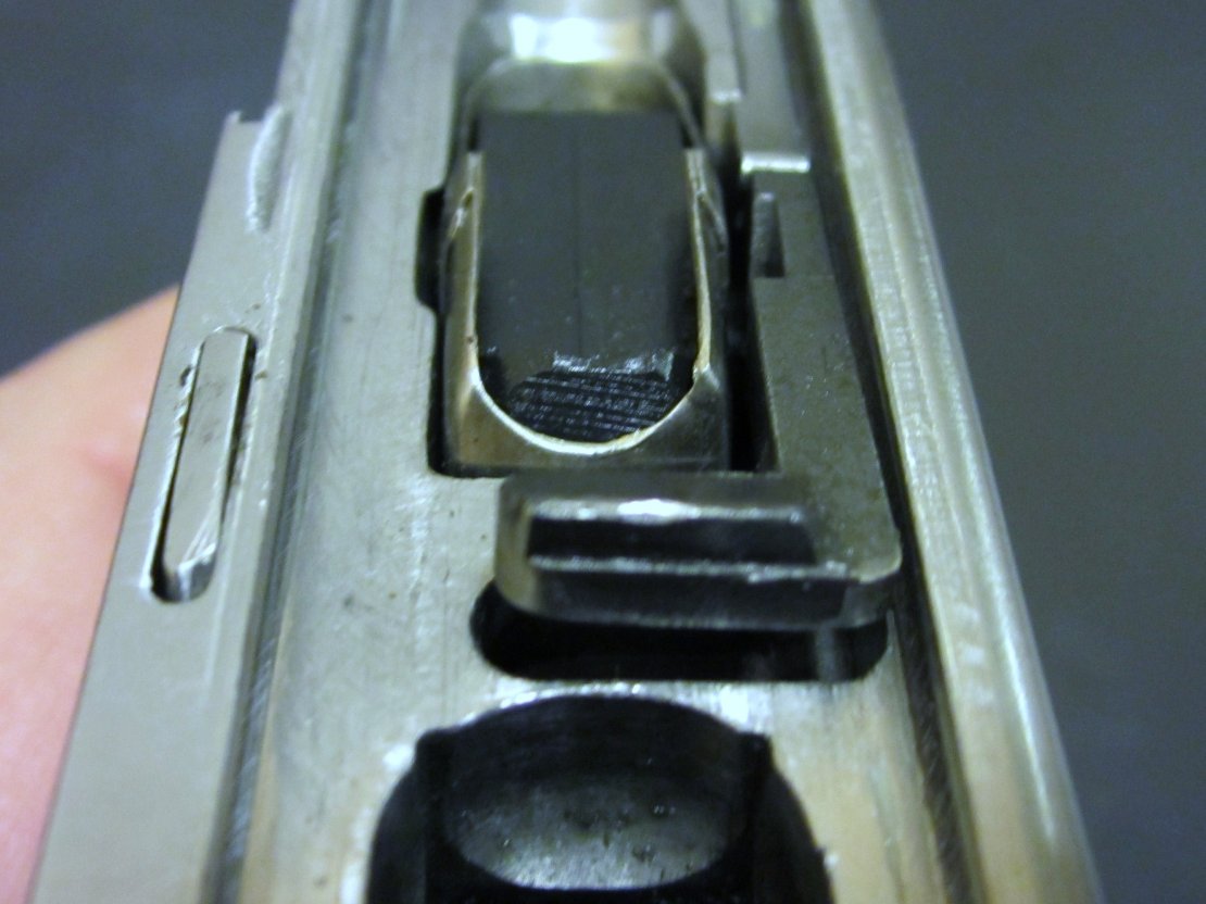

This discussion of hold-opens on the Mitchell SS Luger prompted me to go look at mine.
Here is a pic of my Mitchell hold-open with the magazine inserted. I notice mine sticks up alot more then the one previously posted.Mine never seems to have a hold-open problem after the last shot.Looking closely at my hold-open,it may even be a steel replacement?
Awhile back there was some discussion about the metallurgy of these guns. As you can see mine does have some deformation on the ears. I can't find any other areas of metal problems.
My deformation probably happened when I was taking the advice of so called experts"only shoot hot loads of 9mm,that is what gun was designed for!"
Bob
