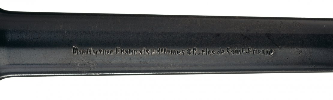

I was finally able to photograph this lugers so-called 'halo' effect. It is pictued in Kenyans however copies have surfaced. Once and for all what is the 'effect' all about Serial #51872 "Manufacture Francais d'Etoines & Cycles de Saint Etienne"

Eric,
The marks on a Luger are applied after the gun and its parts are finished, if I am not mistaken. What happens, whether the marks are stamped by hitting a marking die with a hammer to drive its harder tip into the pistol's somewhat softer steel, or rolled on with a lot of pressure, is that the the pistol's steel is displaced by this action. Iron and steel's molecules structural arrangements are changed by this physical influence--basically when the mark is struck or rolled on, the pistol's material is mooshed out of the way by the harder material of the die's face. During this trip, the molecular alignment of the steel (its "grain") is changed in the area affected.
I think what we're seeing in the halos is the different ways the pistol's steel behaves over time. You may have noticed postings about variations in the appearance of rust bluing among all the parts of the Luger--some turn plum color, some are blacker or bluer than their surrounding parts buddies. This varies by hardness and by specific alloy. Lets not worry about differences created by temperature, formulation, and duration of the bluing process, which I think is not relevant here.
Since we've changed the hardness of the area hit, it will behave differently from the same material around it which has not been whomped with a die, when exposed to the air and other elements over time. I'm thinking that there is another aspect that makes the steel around a stamping behave differently. Imagine painting an empty balloon, and blowing it up after the paint has dried. The paint will crack and slough off the surface as the balloon grows. My thought is that, other than changing the grain alignment, the displacement of surrounding material may work in the same way: The top coating of (literally) rust on a blued surface is not very flexible, and I think some of it will be found to have been lost during this movement. At the very least, the die strike will move the struck material is a way that swells the steel around the mark; but it does not move the top coating to cover this swollen area in the same way it is covered when left untouched, thereby leaving thinner rust bluing around the stamped figure. In turn, this exposes the white steel beneath as the rust blue is stretched thin and more translucent.
A halo happens after first stamping the mark, then waiting several decades for the effect to fully establish itself via ambient corrosive elements of the environment in which the gun spends that time. You can't re-stamp a refinished gun and get anything like this effect because 1) you won't be moving virgin, freshly finished material of original hardness--its temper was already changed the first time and 2) it takes time to enhance the effect.
I don't know if forgers can duplicate the halo effect on a gun. It may be possible chemically.

Wow Now That Make Sence. You the only one that had any idea, It was my first so I have a special attachment, Many Tks PS Its my first only virgin!!

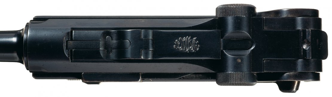

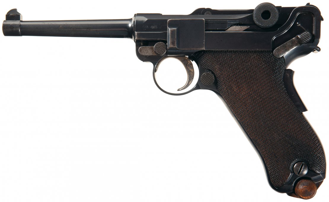

Default Rock Island Arsenal auctioed a socalled Frenchy
That is on its face bogus auction serial #47695 You decide:The inscription had to be post production. Auction date Feb 18 & 19, 2012 It sold although it didn't say how much!

Unread 02-21-2012, 04:49 PM   #5
Default This Is My Legit Incription
Theres looks applied after production. The buyer didn't do theeir homework!

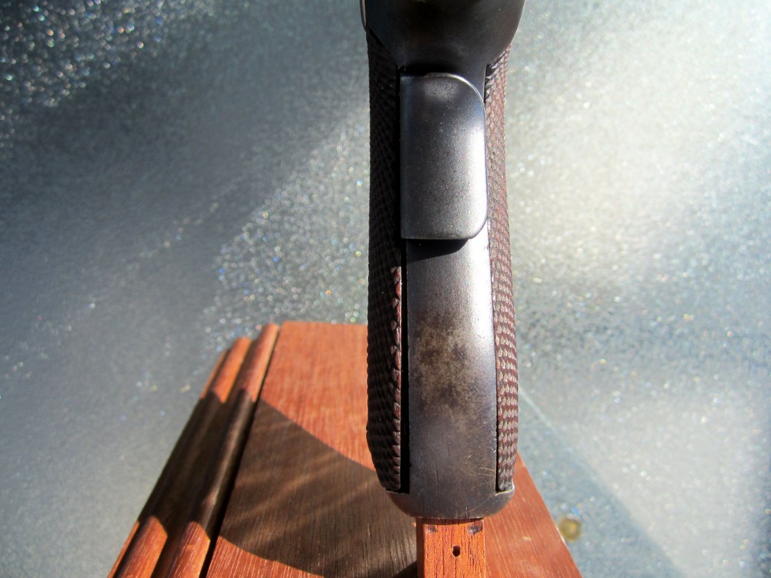

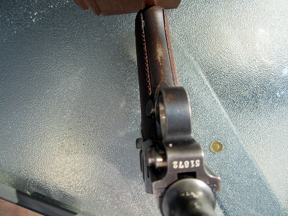

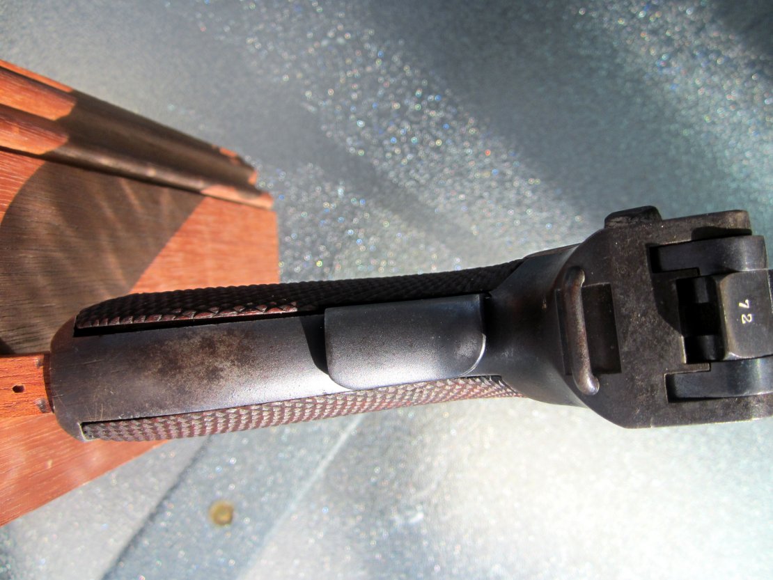

Eric,
Is there a number stamped on the toe of the front grip strap?
Unread 02-21-2012, 11:33 PM   #7
Dwight I'm sorry I don't know where or what You are referring!
Unread 02-22-2012, 02:59 AM   #8
Eric, with regard to Dwight's request, look at the bottom of the grip strap on your 1906 French Luger. The "toe" is the bottom front of the grip strap below the trigger guard where the little finger of your hand would be if you were holding the gun. Is there a number stamped there?
Unread 02-22-2012, 11:27 AM   #9
Default I hope this is it
I dont thinks the grips original!
