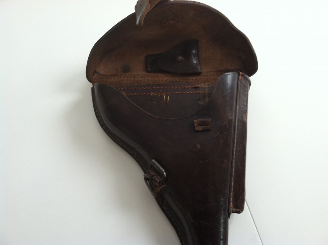

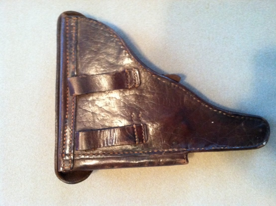

Welcome to the forum! A really nice WW1 Luger in way above average condition! Nice holster, (it would be nice to see photos of the markings on the back of the holster).
Is there a tool in the little pouch under the holster flap? If so, is it marked?

Attached are a few more pics. I don't see any markings on the back of the holster. I do see a mark on the inside of the holster flap but it's worn from rubbing on the gun so I can't make it out... No tool, and honestly don't ever remember there being one when grandpa used to break the gun out to show me when I was a little tot.

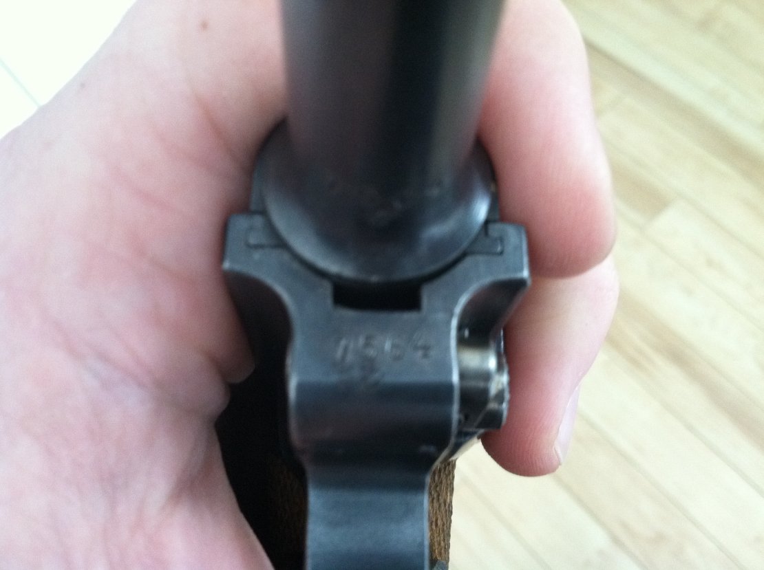

Nice gun! I am certainly no expert, but parts of it look refinished to me.

Hi Drew, I actually have to disagree with fellow forum member Balder, the finish looks original to me. The barrel serial number shows halos and the small vertical pin in the left rear toggle is "in the white", both signs of an un-refinished gun. The only part that looks a little off is the trigger plate, but this is not uncommon. It's thought that the heat treatment this part receives somehow affects it's ability to retain finish.
The holster looks very nice indeed, and has construction features that identify it as Imperial. I think that the marking under the lid might be a partly legible 1916. Regards, Norm

In my opinion the finish is 100% original.

Also interesting is the pigskin construction of the tool pouch flap versus the cowhide balance of the holster.
Unread 01-23-2012, 04:49 PM   #13
Not pigskin but rather pebble grain calf.
