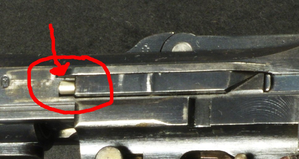

Hi, There is a small round plunger at the forward end of the sear bar.
Those sometimes get stuck in due to dirt and congealed lubricant.
Does that round plunger freely move in and out of the sear bar? It is the disconnector. If it's permanently stuck in, the trigger mechanism would be permanently disconnected...
It's also possible that the trigger plate fit is keeping the disconnector compressed after the pistol cycles. This would happen if the pin doesn't clear the trigger bar to properly reset.
The Trigger Bar (lever) is brittle because it's been hardened. Don't try to bend it. It will likely break before it bends.

I believe I got it fixed. I did alot reading on this site and took into consideration all of the informative responses to my post. The more I thought about it I figured that the disconnect may not be fully releasing even though it moves freely in the sear bar. So I went ahead and polished both the trigger lever face and the disconnect plunger face and now it goes click and I can actually see the sear bar moving as the trigger is pulled. The real test will be at the range. Thanks for all the help. Wish every one here a Merry Christmas and Happy New Year.
