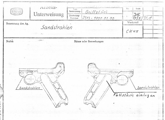

Several parts of the 1970s Mauser Parabellum were actually sandblasted during production.
Production step 735, part 1, shows that the front parts of the frame were to be sandblasted (Sanstrahlen).
