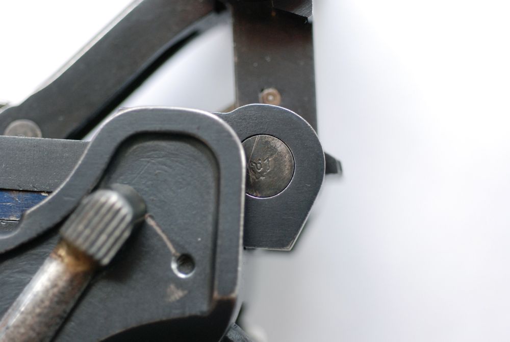

Hi Dave, Your 1912 Erfurt has had a long history. Despite the shortcomings mentioned, it's an interesting gun and looks to be in decent shape. The rear toggle axles on 1912 Erfurts were unnumbered, but were stamped with the Erfurt test eagle, as shown in the photo. The holster, which I think dates from Imperial times, is worth repairing. Jerry Burney, here on the forum, can replace both the closure and pull-up straps. Can you post photos of the back of the holster and the marking inside the cover? Also, do the grip screws have inspection marks on them. Regards, Norm

Dave..Hard to say what you might mean about a pivot pin..If you are talking about the pin at the rear of the pistol that holds on the toggle then it is not supposed to match... Norm is correct....no number but stamped with the Erfurt test eagle.

Yes, that is the pin I was talking about....it is definitely stamped with a non matching number:

Dave..I have an imperial Army pistol here that was worked over by Mauser after the war and the toggle pin was numbered to the pistol. So was the fireing pin.
