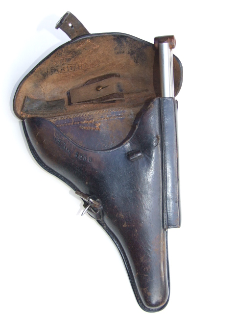

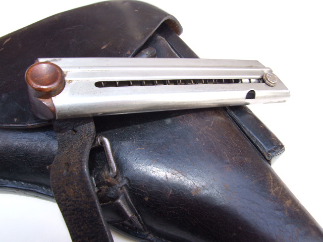

Can anyone tell me what year the transition started from a wooden base to the magazine to aluminium. I have 1936 dated S/42 which came with both a very nice nickel wood base magazine and an fxo aluminium. Is the wood base appropriate?

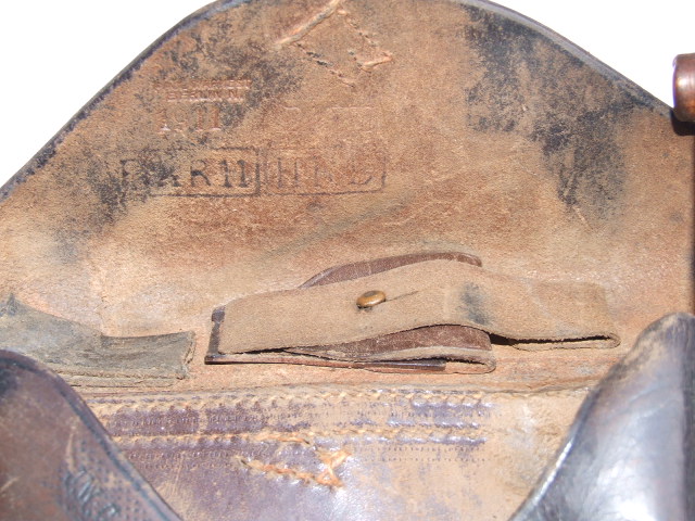

Also, were these guns issued with a holster of similar date or was it common for them to be matched with older examples. I have one dated 1911 with later Weimar alterations. Many thanks

Simon, It was sometime during the Weimar era. I sispect around the early 1920's. I believe Simson may have been the first to make some but certainly by 1926 the Aluminum magazine was in effect.
Your pistol sounds like a Ploice with the 2 different mags. Is it a Police pistol?
What is the configuration of your holster? Army or Army converted to Police? Is it serialed to the pistol?
later Weimar alterations? What are these?

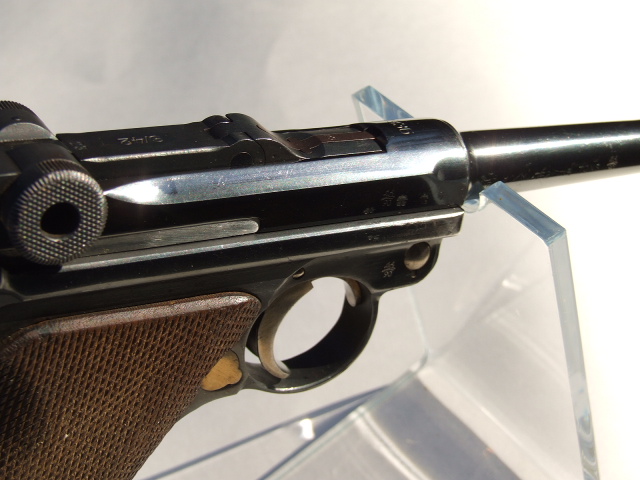

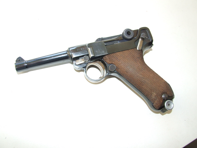

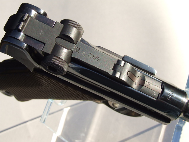

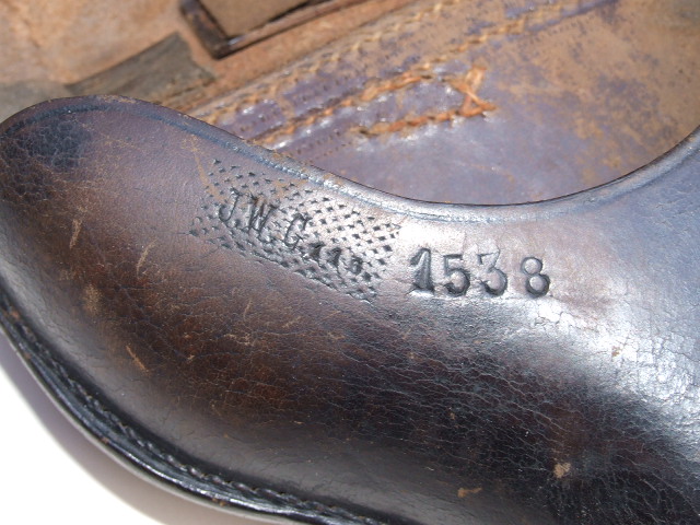

Hi Jerry, many thanks for the swift reply. The gun is an early British deactivation. Sad I know but the only way we can now own these in the UK. At least I suppose it saved them from the crusher.
I grew up in British Channel Islands in 50's and 60's when no kid was anyone without a luger in the post German Occupation years...they were everywhere. Buying this is a trip down memory lane for me but I have forgotten most of what I knew, so any information would be appreciated.
It hadn't crossed my mind that it might be a Police model and I would also be interested to know if it's been re blued or not.
I did put some images on the forum for help with the regimental markings and the forum members suggested that some of the markings might have been Weimar period.

Hi Simon, Neither magazine is correct for the gun. The wood based one is too early, and the fxo type is too late. The correct magazine, called an Army Type 2 by collectors, would be made of folded and crimped blued sheet steel, and the aluminum base would be stamped with a droop eagle/63 inspection mark. Both the gun and holster look very nice, by the way. Regards, Norm

Simon..The holster was an Army..converted to Police. Are either of the magazines numbered to the holster?
The pistol is not Police but rather Army from what I can see and Norm is correct..neither mag is correct for the pistol but may belong to the holster.
Can you show good photo's of the bottom of the magazines and perhaps the story will unfold a little more.
Doug..at the time aluminum magazine bottoms were developed aluminum was not scarce. Aluminum was far superior to wood and once the change was implemented there was no going back. Plastic was used later maybe for the reason you mention..the value of aluminum.
