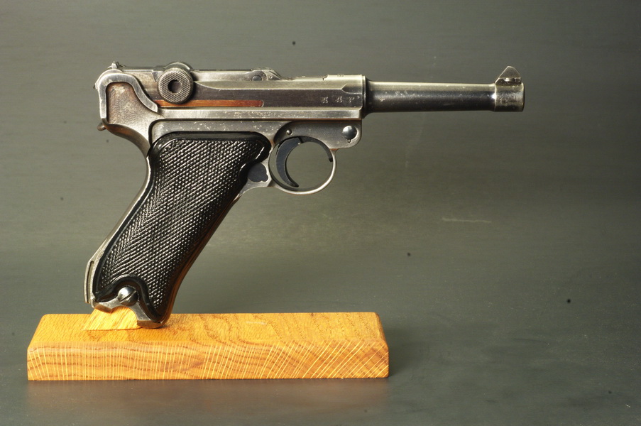

My 1939 42 code Mauser Luger has a finish that is quite a bit more thinly blued than my other salt blued Lugers. The appearance is almost translucent.
Were there periods when the Mauser factory produced more thinly blued pistols, or is this likely the result of someone trying to clean it and removing the bluing?
I've attached a representative picture of the receiver top and toggle. The tone of the bluing darkens depending on the angle of light...

I would vote that there is a pretty wide range of bluing finishes on the WW2 guns, some with purple parts, some not, some with a very dark blue, and some lighter. And I'm not certain if it is a matter of wear, or cooking time, or how "used" the salts were, etc.
More pictures would help, but I'm not scared, yet.
But, do I see a strawed extractor?

The extractor isn't strawed... it just caught the light that way.
Here is another picture... The tone changes as the light angle changes... \/\/\
This was sold to the prior owner by Ralph, and Ralph had apparently added the bakelite grips... I've since replaced them with correct period wood grips. I should take some new pictures...

There could be a couple or so different reasons. Salts were weak (used too long) , temperature was too low, or the duration in the tank was too short. Or possibly a combination of these factors.
The tank temperature being too high will result in a plum color, as will high nickel content or leaving it in the tank too long.

This one actually looks better in person than in photographs. It is unique among the Lugers I've examined. I am confident that it is the original finish. The blue-black color shifting toward purple/plum would be consistent with the process variables mentioned.
It was, after all, 1939 - and I am sure Mauser was under pressure to produce these in greater quantity.
