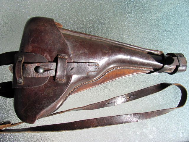

Default Listen to jerry
The reason this 106 year old holster look so good is because it never was treated by chemicals or other abuses and this lived through all of world war one. PS I never have seen a reverse upside down strap!

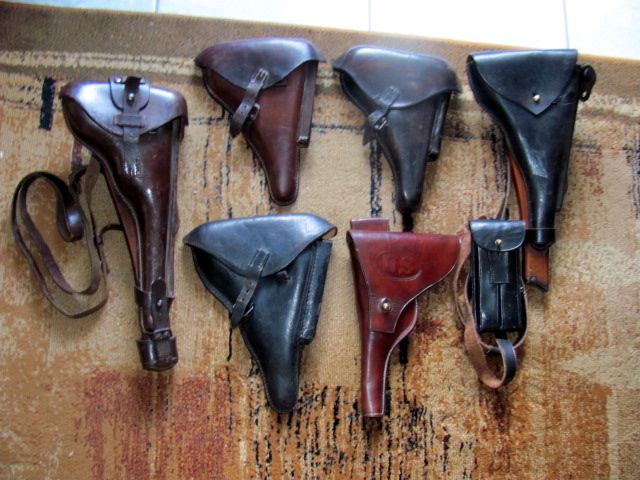

Looks like I will need more than one! IN 2003I fell in Jaco Beach Costa Rica, bashing my head in my majogany bedframe resulting in 3 month of deep coma.My present wife Debbie prevented my second from pulling me of life suport and collecting $300,000. in life insurance. Now all of that had to happen for me being here hanging with You my friends! We are all very lucky. Yes The Dear Lord has a sence of Humor! At least my lugers survived one divorse!
