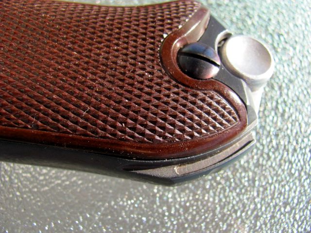

Unread 11-08-2011, 03:13 PM   #6
My 1937 Kreighoff has a stock lug. In fact in Gibsons' book the 1945 has a stock lug yet nowhere in his book is picture an attachment anywhere! Here is my 1937 as an example never used!
Unread 11-08-2011, 05:06 PM   #7
There is some evidence to support that the stock lugs were left intact so that they would serve as an assembly fixture at the factory. The frames could be placed in a jig while assembling or other activities. The cost of leaving it intact I imagine was minimal
Unread 11-08-2011, 05:09 PM   #8
Thats what its looking like!
