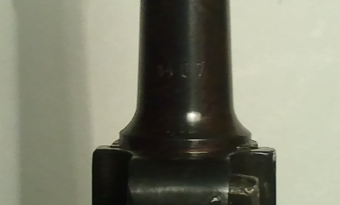

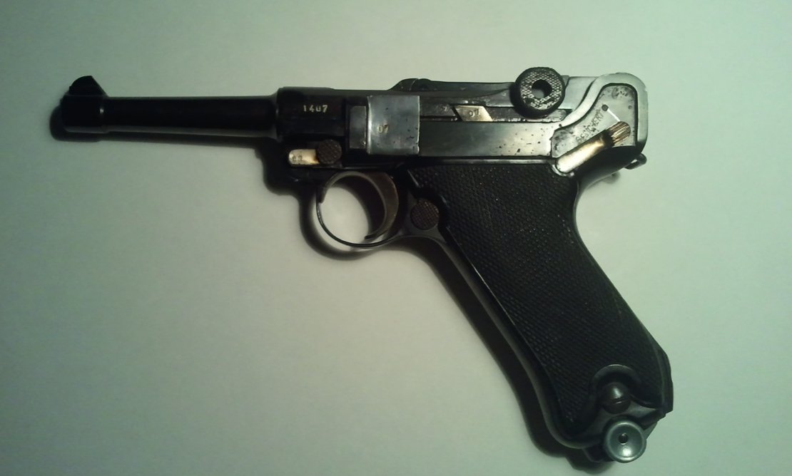

i have a luger from 1914 nr:1407 for sale including the gold mothers cross from his wife and a kriegsmarine band from the first owner i would like to know its value and some more info on the pistol

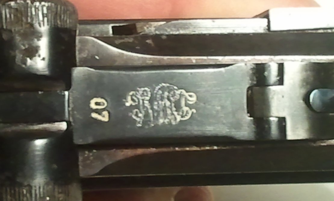

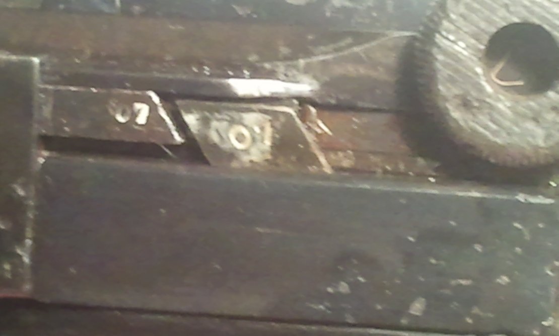

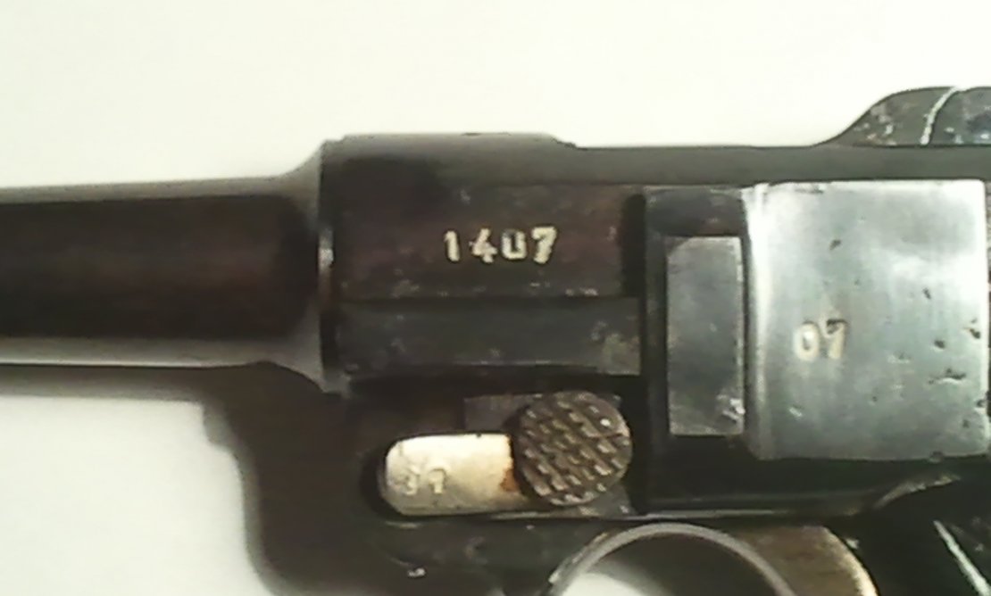

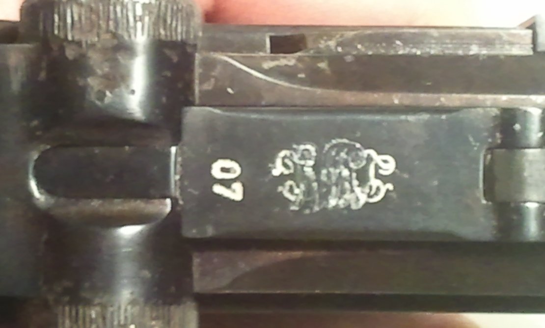

It looks like a converted Navy? with some saltwater or other corrosive exposure. The gun has been refinished and the takedown lever appears to have had either work done to it or it is a gunsmith's replacement. Neither the grips or magazine are original to the gun. The grips, if authentic, are worth some money.
The sideplate also makes me nervous. It appears to have a full length raised lug but may be a gunshop special as well.
Unread 11-05-2011, 09:26 AM   #7

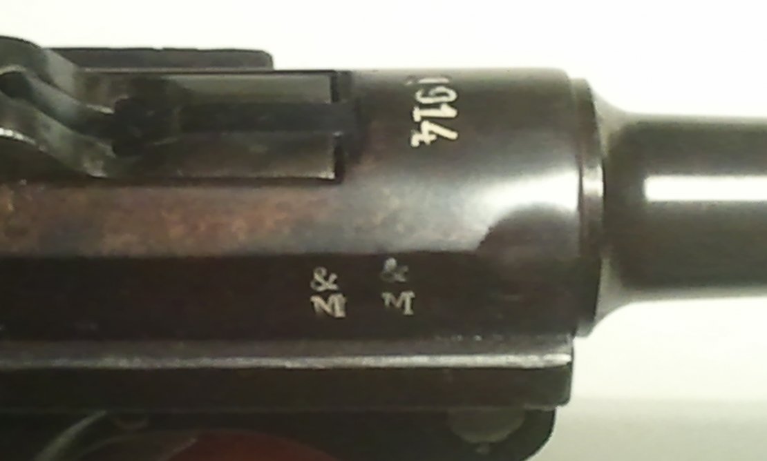

Why is there an ampersand ("&") instead of a crown above the "M" on the right side of the receiver?
Unread 11-05-2011, 09:32 AM   #8
Marc, why is it on the right? (good eye)
Unread 11-05-2011, 09:42 AM   #9
This pistol has had a lot of rust damage. Quite a lot of metal has been taken off here and there and it seems that the &M markings are just an attempt to 'recreate' the buffed away imperial markings.
The side plate has had material welded on, and reshaped. This makes it look funny.
Unread 11-05-2011, 01:32 PM   #10
The gun appears to have been kept working over the years by hand making or repairing a number of parts on it. In any event, it is a shooter and worth maybe $500.
