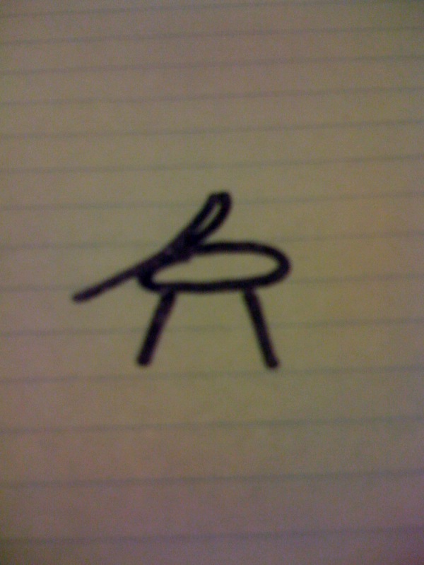

Default Luger DWM commercial ID help
Hello all -- brand new to the forum and I would like to get help in identifying my newly-purchased pistol. I have been looking through the forum for hints, but I don't have much to go on. The serial number is 8344 and right below the serial on the frame and above the trigger guard is the only proof mark/date on the pistol (other than the "crown nitro" proofs.) I cannot get a good picture of the mark, but I did do a rather primitive drawing, which I will upload. I'm interested in the manufacture date and anything else interesting. Thanks to anyone who can help. Pete

Unread 10-29-2011, 10:58 PM   #2
Pete, welcome to the forum, but I am unsure what the marking is, it could be about 3 different markings.
The crown N is the commercial acceptance markings usually seen, the marking above could be a suffix letter or it could be an overstamp of something.

MFC
MFC's Avatar
Location: Louisiana
Posts: 1,237
Thanks: 183
Looks like a lower case cusive 'k'. It is part of the serial #. Sounds like you have an Alphabet DWM commercial. #8344k was made in 1922. It was made for the commercial market. Should be a 30 cal. If it has a 'Germany' export stamp somewhere on it , it was destined for the US.

Unread 10-30-2011, 12:46 AM   #5
cityboy50
Join Date: Oct 2011
Posts: 8
Mike. Thx for chiming in! Yup. After u said it I can see where it IS a cursive "k". And it is 30 cal. I was close with guessing 1923. Mystery solved. Hey, do I need to add the "K" to the serial number in my FFL book? When looking at the serial, it isn't obvious that the "k" is a suffix. Opinions? Thx again. Pete

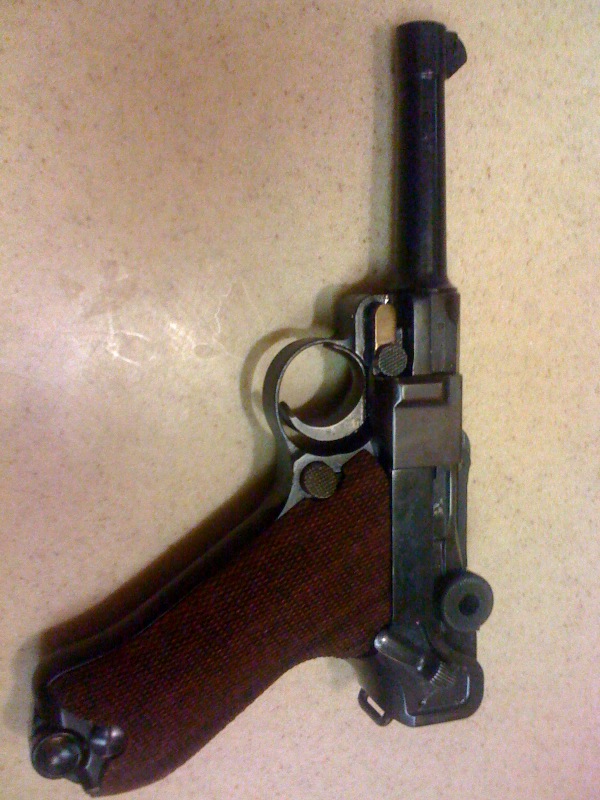

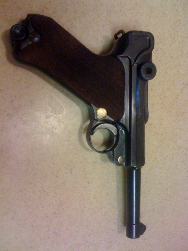

Unread 10-30-2011, 01:24 AM   #8
cityboy50
Join Date: Oct 2011
Posts: 8
Ed. Only have iPhone quality pix which I uploaded. Some parts look like they have been replaced (trigger, mag release, take down) , but all numbers match. After market magazine. I paid $650. Did I get an ok deal? Pete

Unread 10-30-2011, 01:32 AM   #9
Any nice looking luger is worth that

Unread 10-30-2011, 02:00 AM   #11
Thanks: 1,119
Smokin' deal! If all the numbers match, why do you think the parts have been replaced?
Unread 10-30-2011, 02:17 AM   #12
cityboy50
Join Date: Oct 2011
Posts: 8
Hi Ron. The color of the parts that I mentioned (above) are slightly lighter than the rest of the gun. Same with the sideplate. I guess only an in-person inspection by a knowledgable expert can tell for certain. I wuz just guessing!! I like it alot. Can't wait to by ammo and hit the range. Pete

Unread 10-30-2011, 02:33 AM   #13
Posts: 3,400
Thanks: 7,555
Welcome, Pete, here's the good news: The color you describe--and it does show in your photos--is correct for your commercial. It's called "straw", and is applied to the parts by heat treating. Search the site for threads about this to learn more!
The side plate should be rust blued to match the rest of the pistol; however variations in the hardness/alloys of different areas of the gun are said to affect the tone of the rust bluing, and over time different components can become different shades or hues.
Here's the bad news: Though the 7.65 Luger is sweet to shoot, you'll find that the ammunition for this caliber is difficult to find, or expensive, or both.
