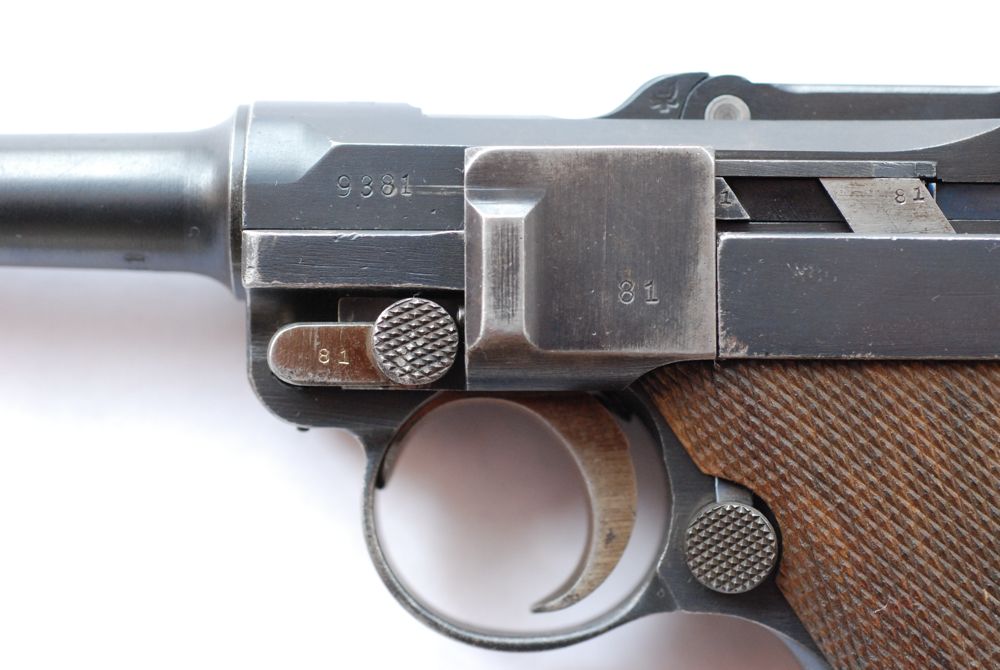

Unread 09-04-2011, 04:47 PM   #10
Heat treating definitely affects bluing, and not just on salt blued guns, but on earlier rust blued ones as well. Here's the side-plate on a 1916 DWM. Regards, Norm
