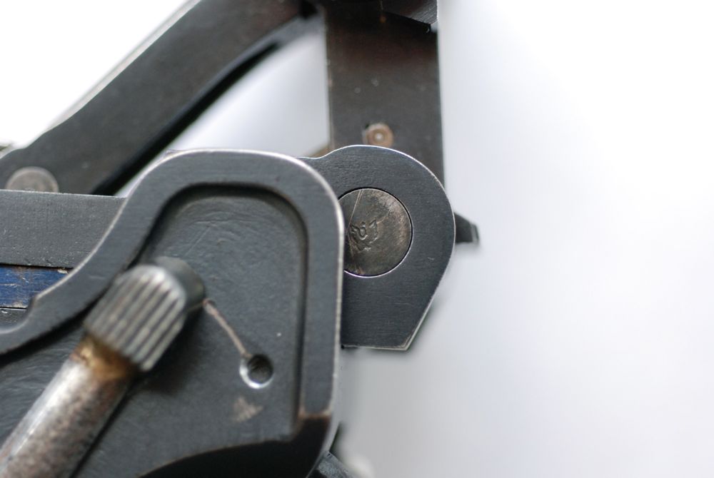

Unread 08-17-2011, 10:08 PM   #2
Hi Guenter, We would really need to see photos to evaluate your gun, but $1,000.00 sounds cheap. As to that rear toggle pin, Erfurt pins were un-numbered, but they were stamped with the Army Test Proof, as in the photo. Regards, Norm

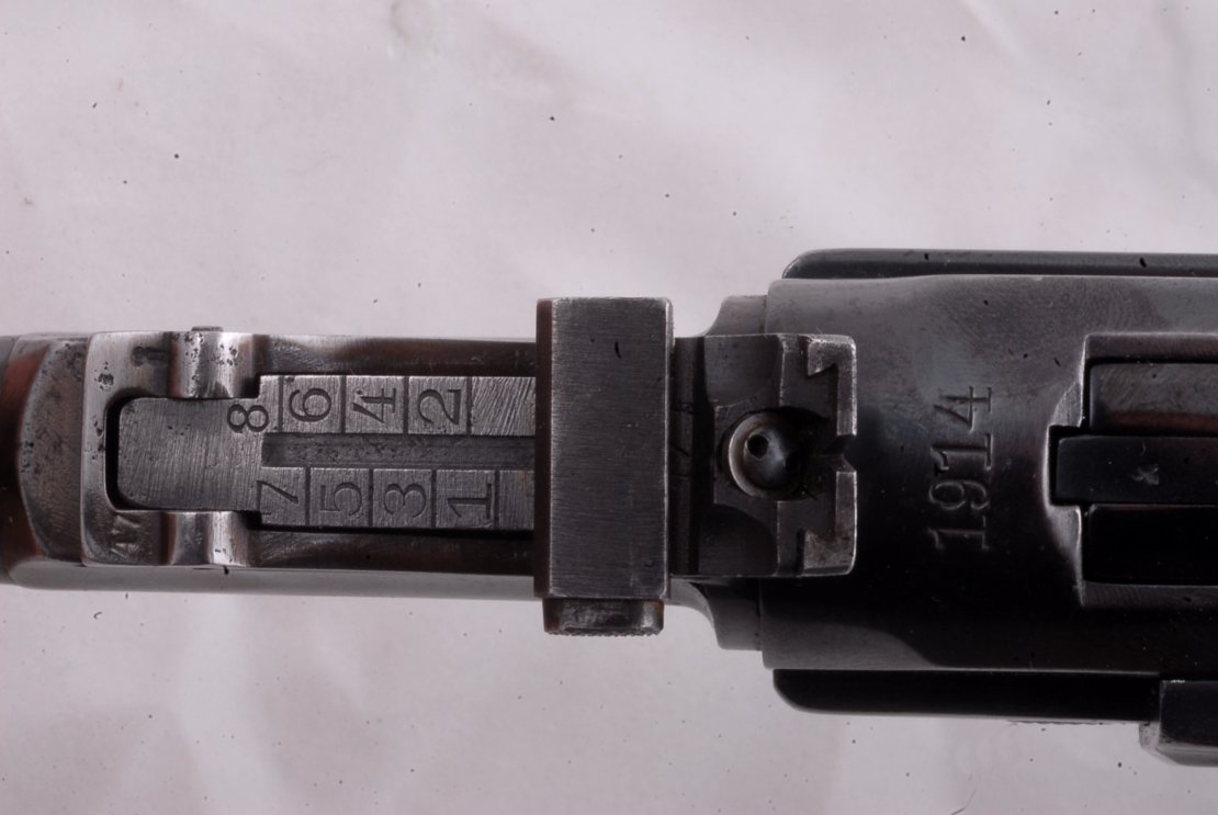

Default Photos of Artillery Luger 1914
Hi Norm,
attached are some photos of the Erfurt. My toggle pin does not have the proof mark. My bigger concern is if this luger started out as an artillery luger. I would appreciate any information.
Greetings,
Guenter

Unread 08-18-2011, 07:49 PM   #4
Hi Guenter, Assuming the front of the receiver has been bevelled to provide clearance for the tangent sight (not visible in your photos), I'd say it's a legitimate Erfurt Artillery. As you said, it's had an old re-blue, but Erfurt Artilleries are hard to find in any condition. I'd say you did OK. Regards, Norm

Hello Norm,
Thank you very much for your help. Yes, the receiver is bevelled.
