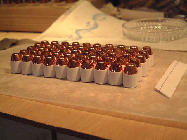

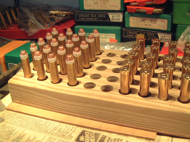

Just for giggles and grins, here's the .500" Ranier 335 grain bullet I use in my Purdey .500 BPE. I patch them up to .515".
Curl

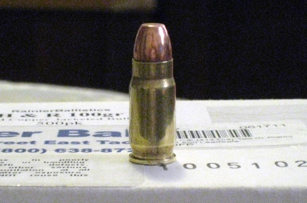

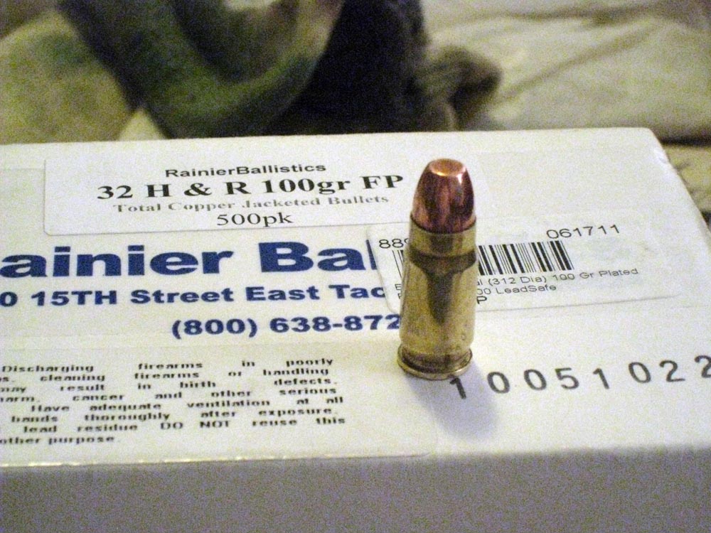

I made a very quick trip to the range yesterday evening to try out my loads with the Ranier bullet. As stated above, my loads for this try are:
Fiocchi brass;
5.3 grains SR4756;
CCI 500 primer;
Rainier 100 grain .312" bullet;
1.123" OAL.
Here are a couple of quick photos of the little guy:
