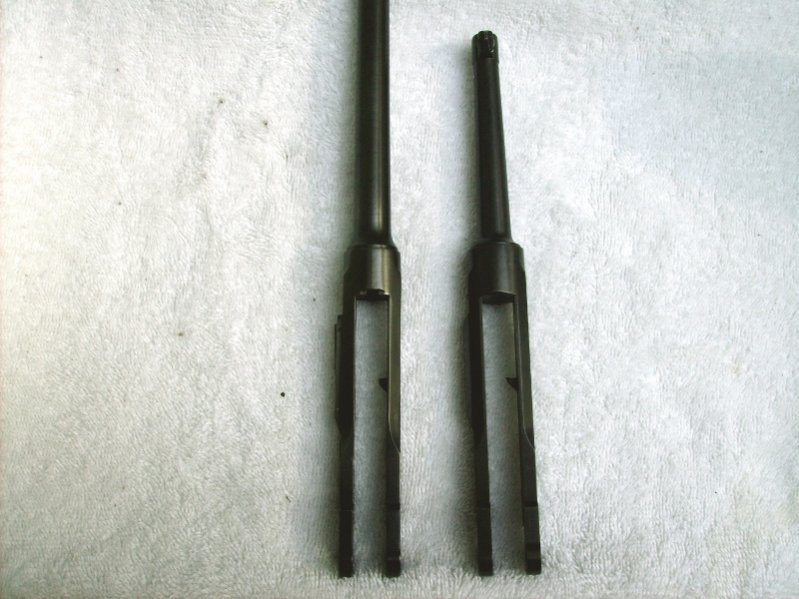

Default Ok...preview
here's a comparison between 2 rust blues...on the left is Brownell's Classic rust blue...on the right is my concoction based on chuckc's formula with modifications....I realize everyones monitor and my camera might not be reading in absolutely "true" color, but a relative comparison between the two can be seen. Is it my imagination, or is the one on the right "bluer" and closer to the old DWM color?

Can't tell the color/hue difference from pics, however I can see a difference in what a Hollywood DP (Director of Photography) would call the "Spectral Highlights" between the two. Notice how the white glare of light is soft on the left, and crisp and hard on the right. The reason for that is ... ??? Please re-take your photos in direct sunlight with the sun to your back, I don't think you are using the correct color balance setting for you camera with these.

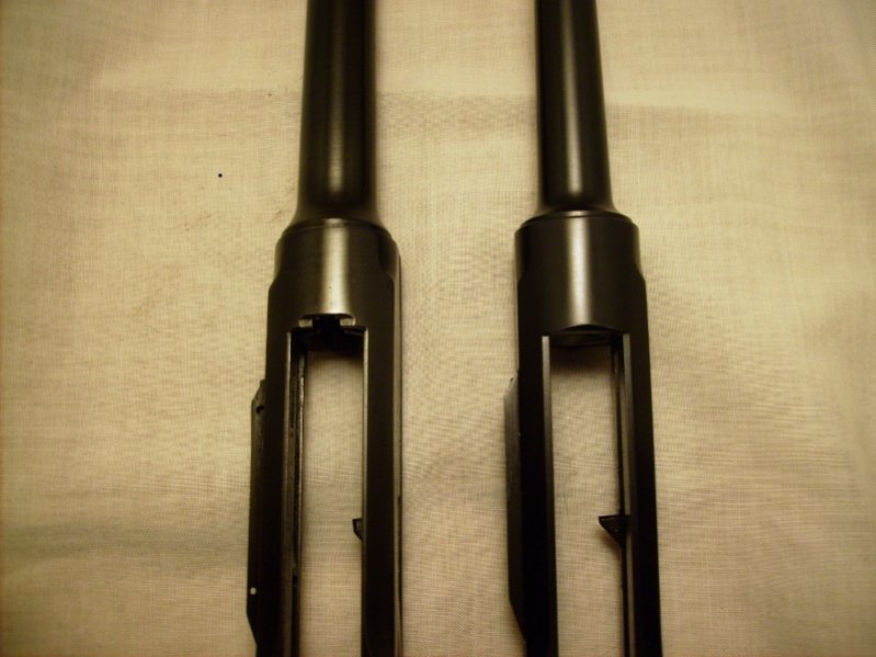

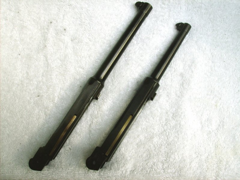

ok...a little cloudy out today, but here's two outside

Bob, the indirect lighting conditions of a cloudy day are exactly what you want for these photos.
The one on the right does look more deeply blue/black to me.
