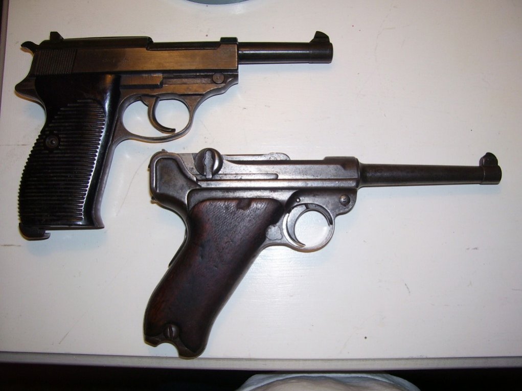

hello all
i have what i believe is a test luger .30
it is in rough shape and i wasn't looking for it, it found me (people needed money) elderly gentleman told me his father gave it to him and he thinks grandfather gave it to father
i have attached a link with photos near the bottom
http://www.ar15.com/forums/topic.html?b=5&f=44&t=112025
ser# 63xx the number on the right side of the takedown lever matches the last 2 digits. unfortunately the 2 digits on the back of the bolt do not match. not shown in the pic i have 1 magazine.
finish....gone
grips.......bout gone
mechanical......when you point the muzzle up and shake the gun the toggle unlatches
i have spent a couple of weeks on the net , in my spare time,
looking at auctions, luger restoration sights, etc.
from the dedicated Luger people i ask............
what would you do with this firearm?
thanks,
John
p.s. i acquired the P38 also

Hi JMO; here at LugerForum.com we ask that you post your pics directly to the Forum, not to an outside site...
I'll do it for you in this instance...
The experts here will require more pics, and better ones, but this should get them going...

I would leave it as is (but fix the toggle latch)...Lugerdoc should have the parts you need...
An unrestored original Test Luger *should* look worn...I doubt the Army pampered them...
Restoring would destroy any collector value...

It is not at all unusual for a Test Eagle to be mismatched. Both the Army and Bannerman cannibalized parts to make complete, functional guns.
If the toggle just "falls" open it probably indicates a broken or incorrectly engaged mainspring. Another possibility is a damaged or missing S-shaped link that couples the toggle to the mainspring.
Above all, do not restore the gun. It accomplishes nothing and will not enhance the value. Replace the mainspring if necessary and enjoy an important piece of American Luger history.
Like Ed, I would very much like to know the serial number(s) of this piece to add to the detailed data base that I maintain on US Test Trial Lugers.

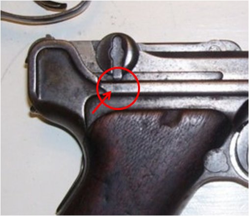

George is right. This pistol has no ledge on the lower receiver for the toggle latch to catch on. A 1906 lower??
Unread 06-14-2011, 10:19 AM   #18
Kitkat041836
Kitkat041836's Avatar
Posts: 195
Thanked 21 Times in 18 Posts
Thumbs up
I do not think this gun is a test eagle.Does it have Germany
stamped on it,if it does it is not a test eagle.
Thanks George
Kitkat041836 is offline   Reply With Quote
Unread 06-14-2011, 11:05 AM   #19
I am confused. You guys are seeing something I can't. The catch for the toggle lock is mounted on the frame, not on the receiver, and when the action is closed you can't see the top of the catch because the lock covers it up. If you look carefully at the photo of the right side just below the toggle lock you can barely make out where the bottom of the catch is inlet into the frame. It is a 1900 frame.
Unread 06-14-2011, 12:10 PM   #20
I guess the quality of the photo and a lot of squinting is required. Not as clear as this view;
http://forum.lugerforum.com/attachme...7&d=1305580820
