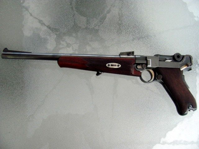

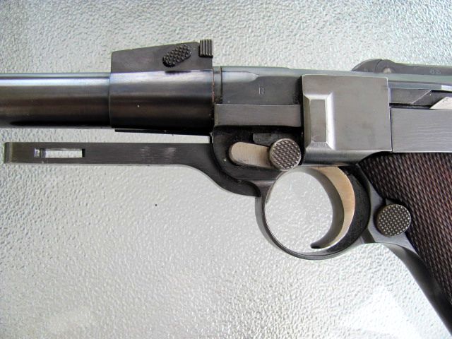

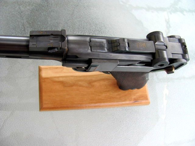

I got up the nerve to take apart my 1920 luger carbine. All matching. Simply beautiful. No inport markings anywhere for whatever that means!

Interesting that the Luger carbine provided a sight on the rear toggle while the artillery did away with this due to the barrel mounted sight.

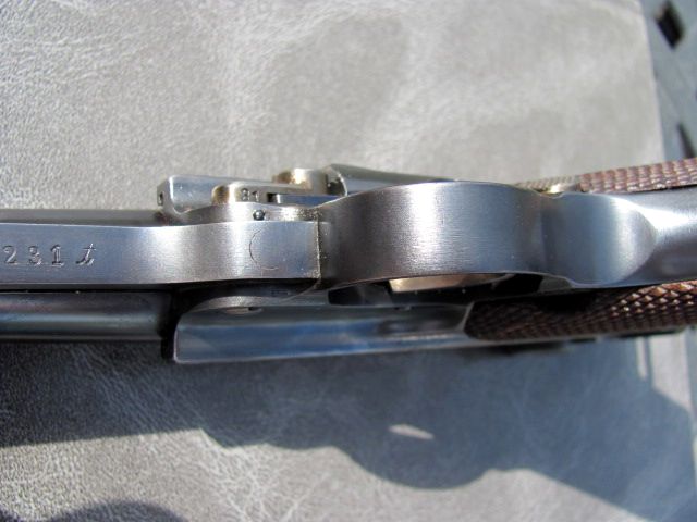

I'm trying to research this serial number to find out where it fell and any significantce it might have.

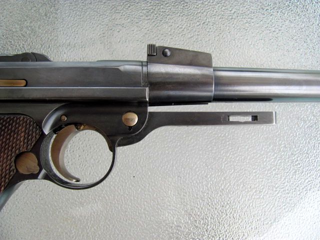

also interesting it is long frame with short receiver and what looks like a spacer between the barrel mount flange and the receiver
does # on the receiver front lug ( bottom of the slide at front ) match last part of the frame serial ? ie = 31 or 231 ?
thanks for sharing pictures

Every single one is '31' including the stock. I'm not exactly sure to what part you reffering but I'm sure its '31'!

Stock irons on 1920 carbines I have seen or had never were numbered. No DWM numbered stock was ever numbered with just the last two digits unless it was a two digit serial number gun.

George you may be right do you notice any more modifications? You opinions are priceless especially You can smell a rat and at the very least question what you feel are questionable! I will fiurther investigate your very valued concern!

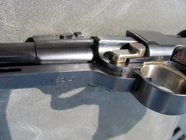

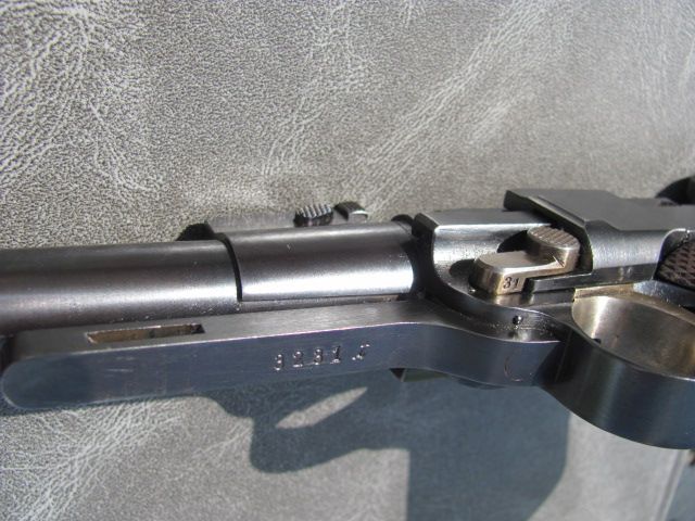

I decided to let you decide. There is just one serial number, no inport marks. I did blowups of the frame... The stock lug might me funky! ps You have a rare opportunity to correct luger history.

My question is why is there a t suffix on the underside of the compensator?

I am puzzled by the SN. Others on this forum, much more knowledgeable about the period will tell you that the SN falls in the DWM29 period and is literally in the middle of the range in Dwight's list that is dominated by Police sear safety guns.
Again, apologies but this is not my area of expertise so I cannot even speculate on the similarities of the SN on your carbine and the range of DWM SNs that are documented.
DWM were pretty careful about not producing guns that had the same SN unlike the Swiss who in the early days could have multiple guns with the same SN, e.g. the saga of the standard issue Military, the "A" series and the 'E" series. But I digress.
Sorry not to be of further help.
John

The only thing that I question is the lack of "GERMANY" Was it geered to domestic use? There also remain the "31' on the stock lug. It was pointed out that a mere 2 digit imprint was incorrect. Merci!

My best guess is someone made this up and stamped the numbers to match. Bill
Eric,
Good points. I am less concerned about the lack of "Germany" as these guns were made for many markets that did not require a statement of origin. But you are correct in that most guns shipped to the USA would have had Made in Germany or Germany stamped on them.
But..as I wrote, the serial number and the numbering is a puzzle.
