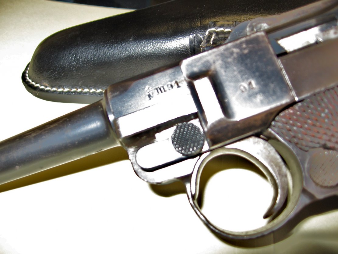

On the left side of slide is the crowned N with a M 91 to the right of it
M91 is on the front of the trigger guard
91 is stamped on All the parts except the above mentioned missing parts which I purchased from SARCO Arms in NJ

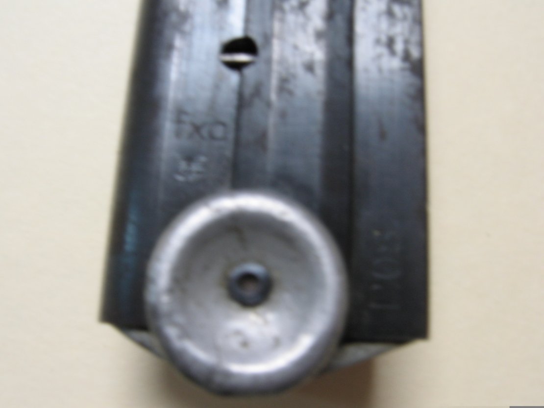

The mag has a alloy (alum colored) butt plug with 6334 stamped on it...it has P08 ... fxo ...a small eagle with 37 under it stamped on the closed side of the mag.

Crowned N with M91 on bottom of barrel
It has the stamped GESICHERT safety in the up position

Pete, would love to see close up, clear pictures of this M91 ??

cool, saw your PM to me, no reason to send pictures.
Totally wrong, unusual and cool.

Badmoonrisen, Thanks for your msgs, Your M91 is marked just like my M81. Maybe someday we will find out what this is all about. Bill Hughes
