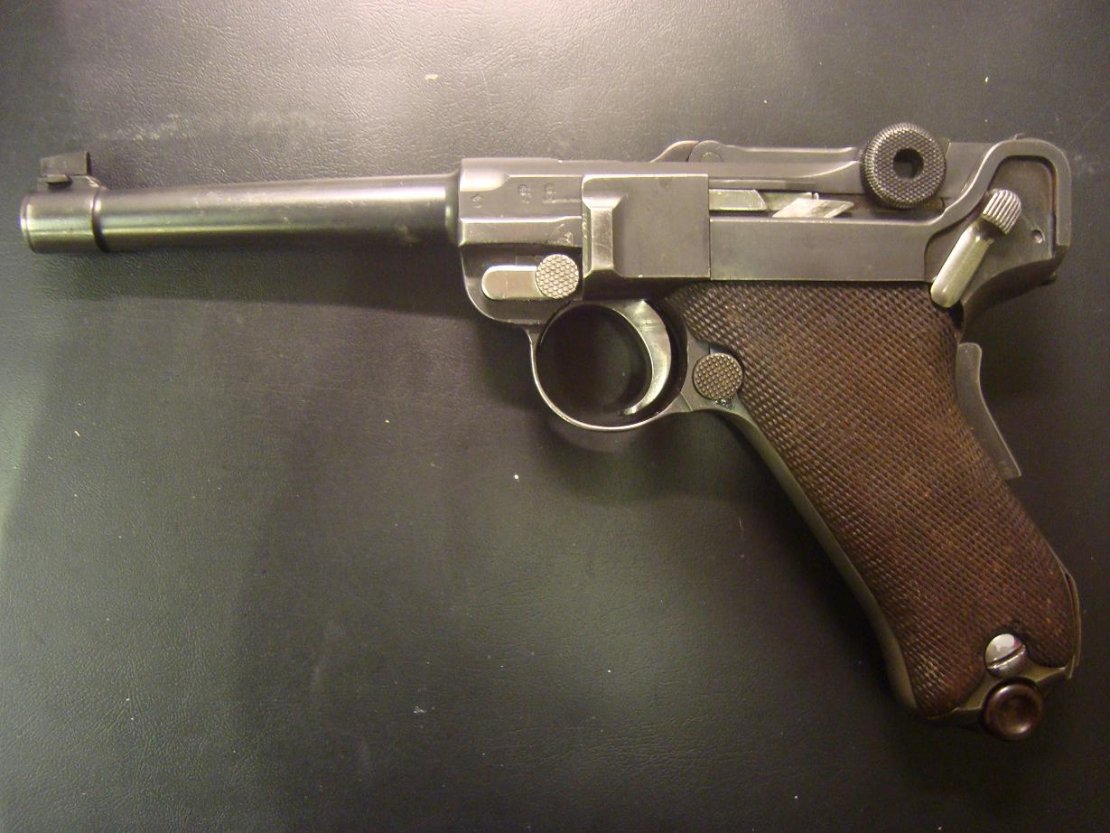

Hi, new guy here
I just yesterday got my P08, having bought it for the equivalent of $70 as a mismatched shooter. On closer inspection I can't find any obvious mismatches other than that the barrel is unmarked and the front sight looks odd. But then I don't know much about these pistols. I've been reading like crazy trying to figure out what it is I've got. Apart from a neat rather beat up gun with a broken ejector.. (It broke today on the range) I'm no collector, but I would still very much like to know how old it is and some of its history. Cheers Conny, Sweden |

The frame appears to be a 1906 Imperial Navy. There are people here who specialize in those, so I'll let them comment. New ejectors are available. Look up Lugerdoc on this Forum. Some overall pics of the left, right and top would be nice. FN Last edited by FNorm; 04-05-2011 at 05:32 PM. Reason: add |

Hi Conny, Welcome to the forum. Your "mismatched, shooter P08" is actually a very interesting and desirable Imperial Navy P04. True, it has a replacement 4" barrel and rear toggle, but still, it's an honest old sailor and it seems a shame to shoot it. Regards, Norm

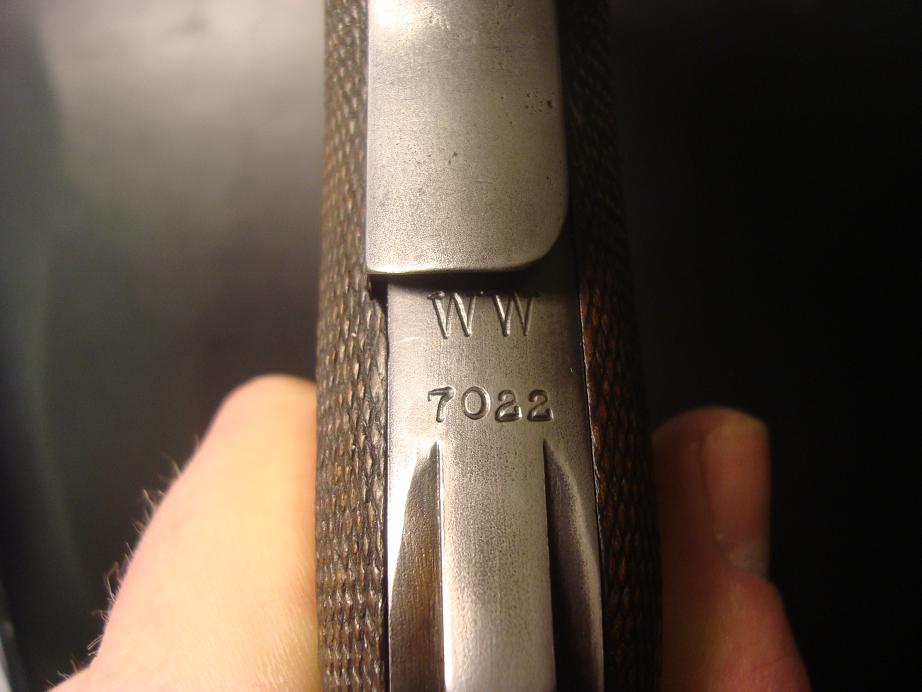

My 1906 navy is stamped ww7022 on the backstrap. I've snoped around and read that this would be a property stamp of the imperial navy indicating Wilhelmshaven Werf. Is it possible to find out if it saw service on a vessel, and if so wich one?
Also, if there is only that one property stamp, would this indicate that the pistol was used in ww1, and after the war somehow found its way here to sweden? If it had been used in ww2, would there have been a second property stamp? I'm getting more and more intrigued by the gun and this site seems a true wellspring of kind knowledgeble people. Lastly (for now anyways), why did they stamp two crown-over-m stamps instead of just one? I hope this is the right place for these questions. Pictures can be viewed in the newcomers section where I was helped identifying it as a navy: http://forum.lugerforum.com/showthread.php?t=25928 Cheers Conny, Sweden |

My advice is to go right ahead and shoot and enjoy this old sailor... It's value as a Navy Luger was destroyed when the barrel and toggle were replaced with newer parts. The front sight is also not original and the rear sight has apparently been modified to use the square front sight blade. I'll bet she is a tack-driver! Enjoy!

Are there any marks/stampings at all on the barrel? Also what caliber is it? 9 or 7.65mm. It very well could have seen action in both wars. Here's a description of one for sale that sounds a bit like yours: DWM 1906 NAVY 1ST ISSUE ALTERED; 9 mm; 60% blue, 10% straw, fair bore, fair grips, 4'' barrel, Matching except the unmarked Navy magazine. Modified for issue in WW2 by sleeving and shortening the barrel to 4", changing out the rear toggle and removing the grip safety. East Sea WW2 era unit marked Ɔ.1643' on front grip strap. The chamber has been scrubbed and a date 1920 in small numbers stamped. This pistol saw use in both World Wars. Finish is worn overall as are the grips. The left grip has a small chip missing under the safety lever., s/n 67xxa, FN |
