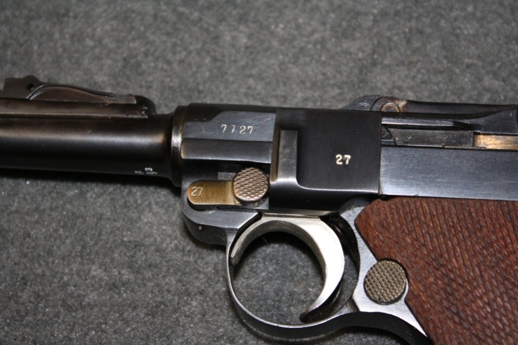

Thanks, Ed. Here are a few pictures to whet your whistle. I have other views of details such as proof marks, etc., if that helps.

I think I can say with some assurance that it is not a Luger 'Artillery barrel". The sight base is wrong.
Here is one on GB that has a soldered-on sight base. It looks a lot like yours. Artillery Luger sight bases were machined from the parent metal, not added afterward. Receivers were also notched to clear the rear sight leaf. There was no gap between the sight base and the barrel flange.

Ron, To answer your question directly..I would value your Father's Luger at around $600-700 .
It has it's share of problems that kick the value in the head. Restored..not too terrible a job, replacement grips, aftermarket magazine..long but weird barrel. It all boils down to a shooter Luger. Someone wanting this type...could be interested. Have you shot it? A good range report will help with the potential sale. If it shoots with no problems that news is worth knowing.

I agree with the assessments here. If the bore is good and it is functional, I believe the bidding would approach $1000 on an auction site as shooters do like the long barrels, and it is nice looking. Add a repro stock and holster and someone will be a hit at the range.
btw: That strange barrel has a proof mark on the right side and it looks like the adjustment part of the artillery site is missing?....

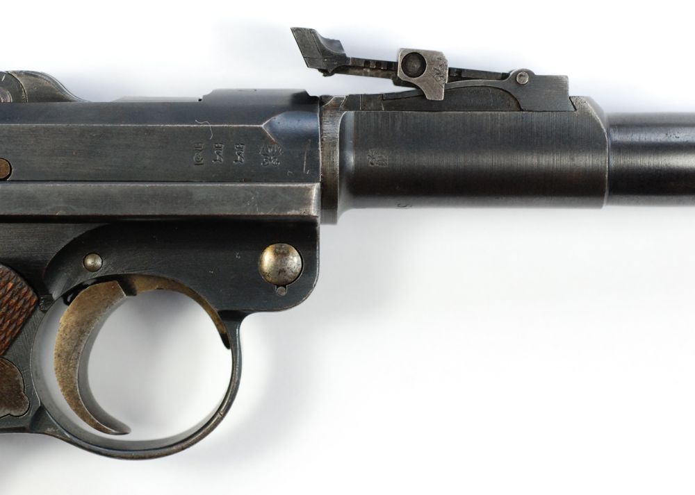

Actually, it does have the sight leaf. It just wasn't on the gun when the first pictures were taken. The sight elevator was broken and had to be replaced. Here is a close-up shot of the sight now.

Is there a rear sight on the toggle?
Nope, no sight on the toggle. Here is a closeup...
rdurling01 is offline   Reply With Quote
Unread 03-27-2011, 09:41 PM   #20
Ron, Thje sight is not found on the toggle but behind it..towards the rear of the pistol. Your photo crops out most of that area but shows some of it and I believe you are correct..it does not appear to be there?
