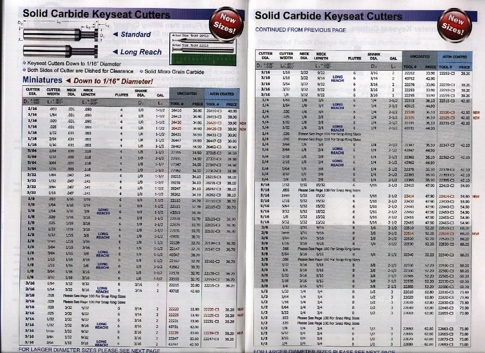

The company I ordered my dovetail cutter from, Harvey Tool, sent me their catalog...Idly browsing through it, I noticed they have very small Woodruff keyseat cutters...
I too need to cut a small "T" slot...I'll be ordering one of these cutters shortly...
www.harveytool.com

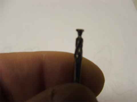

What a Mother! Having little in the way of exotic equipment, I had to figure out how to mill this little slot. Took a small..3/32(?) broken end mill, ground the broken part off, slowly (Boy, is that thing hard!). Chucked it in the lathe and with a Dremel reinforced cut-off wheel, I ground it into a tiny cutter. Put my 'cutter' in my flex shaft Dremel and Voila', cut the slot I needed. Works just fine for a little sear spring slot.
