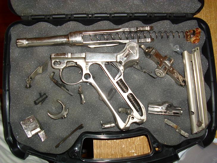

Hello all,

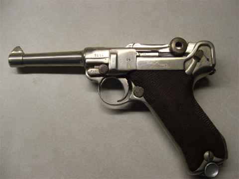

My mother picked up a luger a couple of years ago and recently gifted it to me. Problem is that sometime in its life it was chromed and not well. My goal is to de chrome the gun and have it re blued.

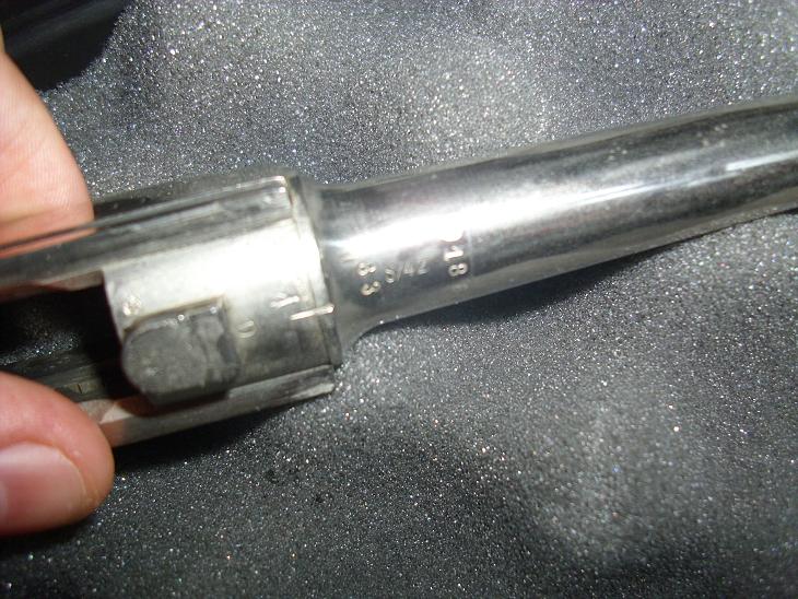

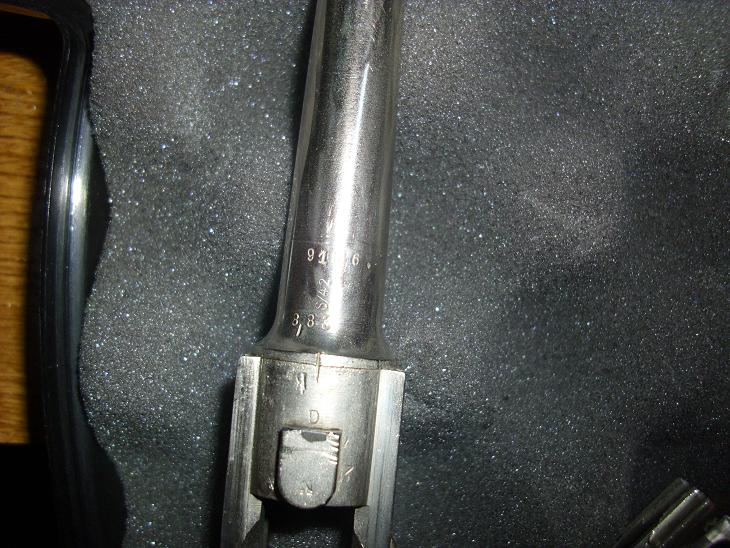

Firstly I was wondering, should the gun be salt blued or hot blued? If you look closely at the bottom of the barrel you will see a s/42 between the SN and 883. Could the "original barrel" not be original? The proof mark seems to be right and the SN font does see to match.
Secondly, what parts should be strawed or left in the white?

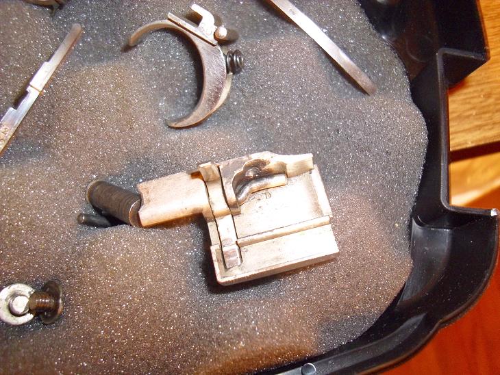

Third, I am having troubles disassembling the breech lock assembly, side plate, and removing the recoil spring. Any suggestions gentlemen?

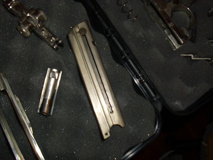

Fourth, I think the magazine is original but not sure. At some point someone thought it would be cool to replace the mag bottom with an aftermarket pearl/plastic one. Should the magazine be the color it is or should I also have it de chromed? and where should I drill the hole for the replacement wood bottom that I bought? The pearl/plastic bottom's hole was not done well and does not fit snuggly with the bottom of the magazine.

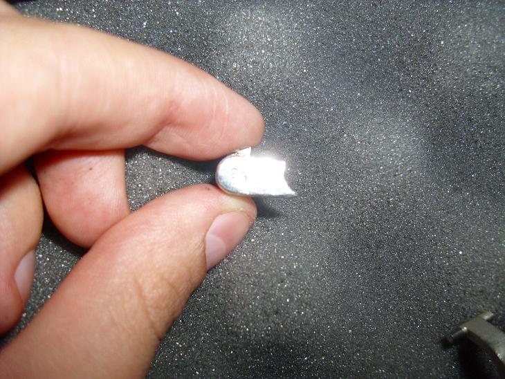

Finally, the locking bolt was broken at some point. Any ideas where I can find another locking bolt marked 86?
Early mags had their own nickle coating. I would leave the mag alone. You will find it very difficult to install a wood bottom properly. If you are going to go to the trouble and expense of restoring this pistol have GT in Phoenix do it for you correctly.

So the magazine has the correct finish. Check.
Anyone know about the s/42 marked under the barrel? Was this common for ww1 lugers that reentered service?
Also if anyone can give me the run down on how to disassemble the breechlock group I would be indebted to you.

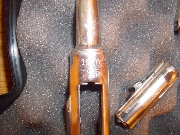

Am I missing something here, or isn’t the most significant thing about this poor unfortunate chromed Erfurt the fact that it has an original chamber date stamp of 1915.

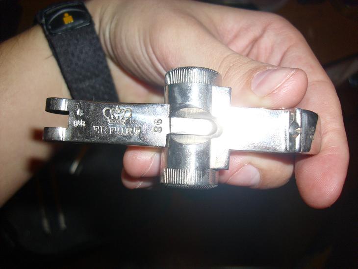

This gun appears to be matching; at least from the parts we can see # 9186. Toggle has an 86. If this is legit, this is extremely rare and worthy of a full on restoration. There has never been any authentic examples reported.

Note the "S/42" stamp between the barrel SN and the bore gauge. This was an armorer repair or rebuild post 1934. It would be hard to prove that this is a 1915 Erfurt. It would be debunked by advanced collectors as a rework.
GI's often had their war trophies plated in Germany at the end of the war. It could be done for the price of a few packs of Lucky Strikes.
As far as having it stripped and refinished for $200. I would be very careful. You could end up with a refinished gun of even less value. A good and correct rust blue refinish should cost much more than $200.

The 1915 dated Erfurt is neither rare, valuable nor an Erfurt. It is a parts gun and not, in my opinion, worth any further investment. Leave it nickled and enjoy shooting it.

Forgive me for my ignorance George but my understanding is that when a gun has all matching numbers it is considered original. While my pictures do not show all of the numbered parts all parts do match. How can you be so sure that it is a parts gun?

First of all there are no known Erfurts dated 1915; in 1915 Erfurt was overwhelmed by government orders for KAR98's and no 1915 contracts or orders were given. The barrel you show is marked S42 and was installed after 1934. I can assure you that with a 1915/1920 chamber date and without an artillery cut the reciever was made by DWM. It is a nonmatching gun as far as collectors go. It may have been renumbered and matched in the 1920's or 30's but collectors would not consider this an original matching piece. Save your money and enjoy what you have.

The fact that it has a 1920 property mark indicates that it was a Weimar era reissue. The S42 marked barrel was added during the Nazi era. The nickle finish is fairly common and most were probably thus enhanced by G.I.s returning from service overseas in the 1940's. Given these points it was quite likely assembled from parts in Germany after WWI and kept in service by the Germans through WWII. The nickle finish is part of its history and I would leave it alone.
Only if the pistol were an extremely rare one such as a 1910 dated Erfurt would I bother with restoration. In the case of the 1915 dated pistol above all restoration will do is add to your investment cost but do nothing to enhance collector value.
