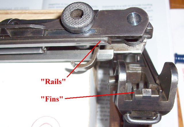

just so we're all on the same page...the 'rails' are the ~1/16" x ~4" long protrusions on the sides of the receiver that run inside the grip frame...Under recoil, the receiver only travels about 3/8" using these rails...
If these are what you are referring to, I would like to see a pic...
If they are the two 'fins' sticking up on the abutment at the rear of the grip frame, that Vlim referred to...I would still like to see a pic...
How did you ever manage to break either of these two possibilities???

The fins, that is correct guys, THANK you. I had several Lugers years ago that the things were long broken off, and they appeared to me as exactly how Vim you described it, they look like they serve no purpose whatsoever. A waste of a machining step. I studied it and studied it and was trying to figure out why they were even put in the frame.
I put 600 rounds through it, (I mean it is a 90 year old gun)and that happened. I have a back up ejector, I bought a extra firing pin, the extractor, I guess I will wait..And as far as how did I manage it? WHo knows, I guess she is tired, I seen a lot of Lugers and owned 2 that had one of these fins broke off.
