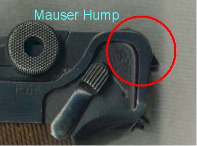

On Mauser receiver frames, the rear side of the "ears" are not flat. It's got a slightly rounded bump.

Unread 02-16-2011, 10:10 PM   #10
Mauser "hump"
