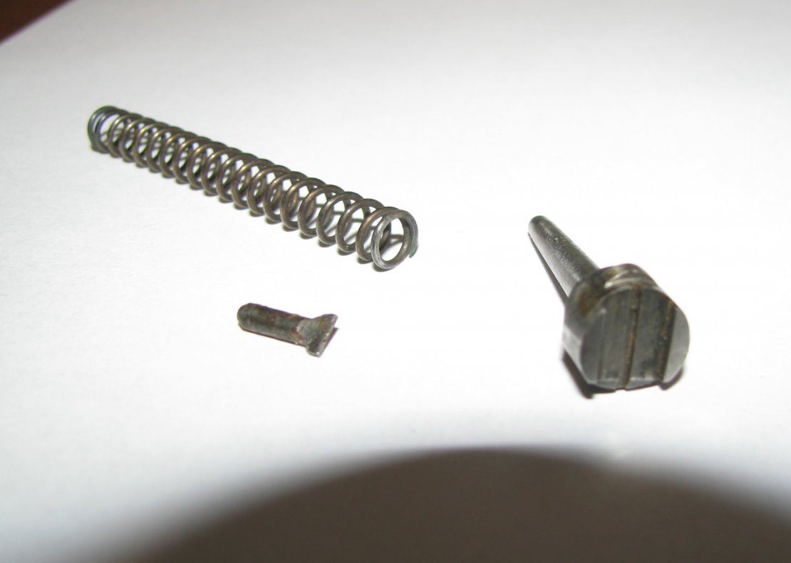

Thanks for the great info. My Dad is trying to retrace his steps after the Germans ran them out of the "Bulge". As you all well know, our guys came back and kicked their butts! He has maps and some of a journal/diary. The stories this gun could tell, uh?. I will post or somehow send along what ever my Dad can construct. My Dad stayed in the Army Reserve for another 40 years and retired as a full Colonel in the "Civil Affairs" unit out of L.A.. At the same time worked his way up from a school teacher to Superintendant of large school districts in L.A. County. His name is Royce Emerson Lapp. He is a survivor with a ton of energy. All four of his children are very proud of him on many levels.
Here is what we have of the firing mechanism, less the firing pin. Can anyone ID that little steel piece that I included in the photo? We're not sure if it was part of the luger or not but it was in the cigar box. There was a belt buckle in the box too so it could have been part of that.
Can someone also explain the "extractor" the might be missing?
I was able to slide a #2 pencil into the bore quite easily. I calibrated the bore with a simple tool and came up with aprx. 7.49mm. Didn't the factory make the bore change in the year 1900? Maybe this has the larger 7.65mm bore? I don't know.
Can anyone speculate at this guns dollar value for insurance purposes only? Thanks again to all. Your all very nice. Thanks too from my Dad. He appreciates your kind remarks. Later!

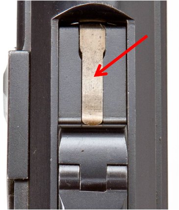

You can be certain that your Luger is 7.65mm. Here is a photo of the extractor that is missing on your gun.

Tom Heller (Lugerdoc) that has already been suggested as a source for a firing pin may have an extractor as well. Originals are difficult to find but there are some excellent reproductions that have been produced that look, fit and function as the originals. You do not want to get a reinforced Swiss extractor that is available however, as it is not proper for your gun.

The little piece of metal looks like the end of the original extractor that broke off. It is the end that is inserted into a hole in the breechblock.

You have the spring and the firing pin retainer. The other thing doesn't look like a Luger part. Belt buckle part is likely.
From the photo, it looks like the front "claw" on your extractor was broken off. A front photo of the breech block face will confirm. Also, a picture of the breech block rear can confirm that it isn't damaged.
So, looks like you need a replacement extractor and a replacement firing pin.
