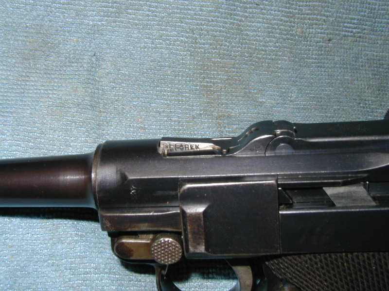

well I finally took the plunge, got my first luger and I'm thinking it might be a rather expensive mistake..I WANT MORE
anyhow this one was listed as a 1920 DWM commercial, however, theres no "germany / made in germany" stamping
it does have a crown over N stamping on the underside of the barrel and another one above the takedown leaver..
the finish looks like the orgional rust blue ( looks much better in person than the pic's show)
But here it is, in it's glory

Oh I forgot it's a .30 cal and any information anyone has would be helpfull..

the suffix on the front of the frame, under the number.
thats the weird part the front of the frame is blank..... nothing nada.. only markings on it other than the serial # is the crown over N..

Oh ,and the extractor does say Geladen
but I'm still trying to find out more about it,, I was told it was a "parts" gun rebuilt by DWM sometime back in the 20's and that it was refinished by them back then, as a way to explain why nothings marked? (no matching numbers ,actually no numbers other than the two places where the photos show)
but don't understand the lack of import stamp.

Hi Jeff,
The front of the frame was shaved back to remove the S# and possibly a 'Germany' stamp. You can still make out the remnants of the suffix on the curved surface. The last two digits of the S# are stamped on the bottom edge of the takedown lever (pictured) and should also be on the bottom edge of the sideplate (can't make it out in the pictures). If it is not numbered it is not original. The barrel is not original... no witness mark or S#. The S# added to the back of frame is most unusual. I could be wrong, but I don't think DWM made these changes to this Luger. It looks like a fine shooter in excellent condition.

the striker ( fireing pin?) has no grooves in it , and the mag's are "el cheepo" aftermarket.
and it does have a bolt hold open.
however, now that I've learned how to take this little guy apart,,( whew ) I did find more #'S there is a #93 on the back of the side plate a # 28 on the underside of the takedown leaver, and a # 55 stamped on the back of the bolt face.
"whoo-hoo" there is markings.. mismatched , but it did gobble up 50 rounds of Fiocchi ammo and it was sending them where I wanted them too..and with NO jam's or stovepipes...

the fact those parts are mismatched DOES not mean it was not assembled this way originally from the factory. ANYTHING CAN HAPPEN WITH THESE GUNS, anything! iF THERE ARE NO OTHER SERIAL ON IT, NO PROOFS, it can be original regardless.
Hi Henry,
This is not what I have learned.
Many tens of thousands, Alphabet DWM's (formerly 1920 commercials) were exported to the US. Most all of these are serial numbered the same way on the external parts, with matching numbers on the same parts. The commercial series began in 1900 and continued until 1929 when Mauser took over production of Lugers. The serial numbers are continuos, even though the system was changed to the military style of numbering by adding an alphabet. Whether the parts were military surplus or new manufacture, they would have been finished and numbered to match. I don't beleive DWM would intentionally let one out of there door with mismatched and unnumbered parts. WWI military reworked Lugers sold to the commercial market are well documented. IMHO this is not one.
Mike C.

The blueing on the side plate actually usually fades quicker than on the rest of the gun. So comparing the state of the blueing is not the best way to determine whether a part left the factory together with the gun, or not.
Basically, in some 90 years many things can happen to a gun and trust me that most of that has nothing to do with the original manufacturer. The 'Germany' or 'Made In German' marking was a requirement, dictated by US law, for import guns.
That said, there are many guns which were deliberately anonymized by removing serial numbers and property markings for many reasons. We see them pop up now and again in Belgium and France, where people from the resistance removed serial numbers (or even hacksawed 2 inches off of navy luger barrels for easier concealment).
On the other hand it may just be a gun smiths attempt to create a somewhat matching pistol from a bunch of parts. It's a nice looking gun that would make a pretty shooter.
