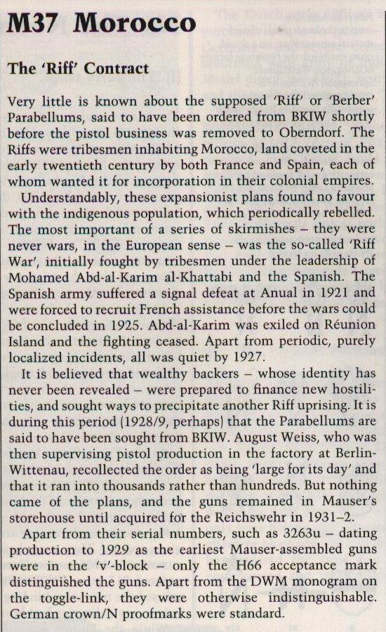

Walter's "The Luger Book" also has a short paragraph on pg 175 about the Morocco/Riff Contract.

Don Maus drew my attention to this thread, asking if my translation of August Weiss' handwritten notes "a few thousands" cannot be misunderstood.
This is the text in German which was written by August Weiss at te end of 1972 (August Weiss Files Document 26):
"P. Riff. Vordergelenke ohne Firma von D.W.M. Berlin Wittenau nach den ersten Weltkrieg um 1927 - 28. durften aber nicht geliefert werden Baron von Gontard & der Regierung wurde es zu riskant & wurden von der Polizei übernommen"
(August Weiss Files Document 26a - same date)
"Es waren aber etwas mehr Vordergelenke in Berlin ohne Firmenzeichen gefertigt, welche später in Oberndorf für P.P. verwendet wurden und wohl für Polizei geliefert wurden, aber keine grosse Stückzahl."
(August Weiss Files Document 44 - Notes of an interview with August Weiss, handwritten by Dr. R. Gminder on 03/21/1972)
"...Riff Kabilen: paar tausend...".
The quantity of "a few", or "a couple" thousand has not been written down by August Weiss, but was noted by the director of Mauser Jagdwaffen G.M.B.H, Dr. R. Gminder during one of his interviews with August Weiss, the former head of Mauser's pistol production between 1930 and 1946. Mr. Gminder (now a retired Professor, living in Heilbron, Germany) recalls the many visits he paid to August Weiss. "The man had an amazing memory, but before he would answer one of my questions, he would look first in his dairies, in which he had noted practically everything. Mr. Weiss wanted to give me the facts. The quantity of the Riff pistols was not in his dairies. Therefore he could not give a exact number - but speaking from memory he mentioned "a couple of thousand".
In our book "The Mauser Parabellum 1930-1946" on page 340, left column the next text is printed:
About the Unmarked Toggles
Document 26 (1972):
"In DWM Berlin Wittenau after WWI (around 1927 - 1928), we made a few thousand Parabellum pistols having no DWM marking for the so called Riff tribe in Morocco. These could not be delivered; (DWM's CEO) BAron von Gontard and/or the government thought this was too risky. These pistols were later taken over by the police in Berlin".
In this text I have added the "few thousand" from Dr. Gminders notes to the text which was composed from the shorthand written by August Weiss.
I can't help correcting two things that were written by John Walter in his "The Luger Book" (see post above).
- The unmarked ex-Riff pistols did not go to the Reichwehr in 1931-32 but to the police in Berlin 1928-29.
- ... Apart from the DWM monogram on the toggle-link, they were otherwise indistinguishable. German crown/N proofmarks were standard. ...
The Oberndorf proof house did not use the Crown/N stamp, but instead used the Double Crown/U proof stamp.
This was a great help for our research; some 4,000 Luger pistols came from Berlin, most of these had been test proofed in Berlin, having the three C/N stamps. A few mixed stamps are reported.. In that case Mauser had changed the barrel (for many A.F. Stoeger pistols). Only the replaced barrel was stamped with Cc/U, the receiver and the breech block will have the C/N stamp from Berlin.

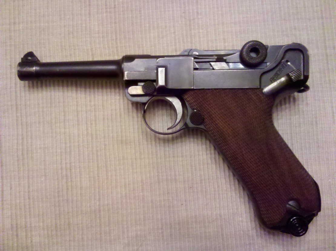

Unread 03-31-2011, 11:55 PM   #18
FAST46BIRD
Posts: 4
Default Sneak questions

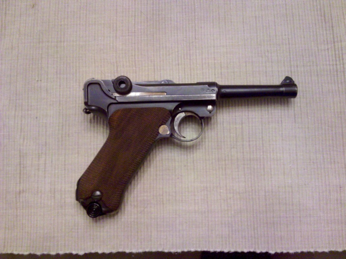

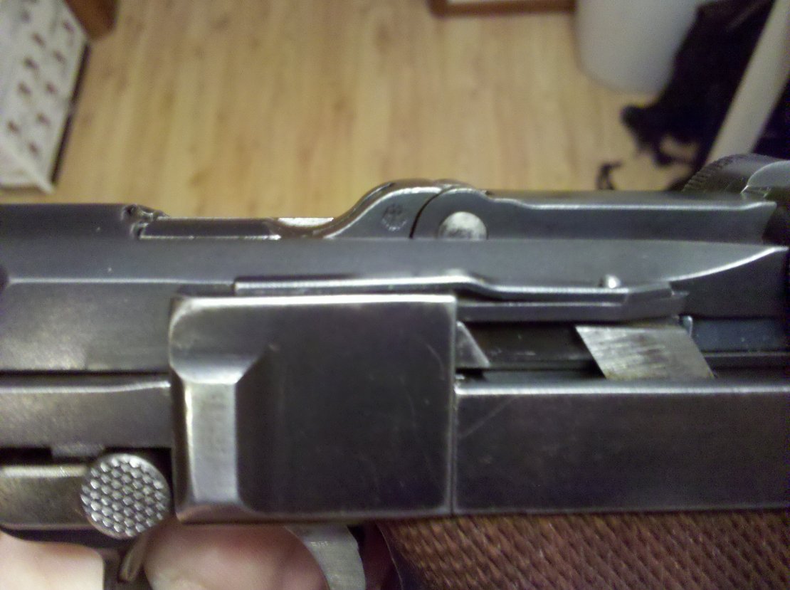

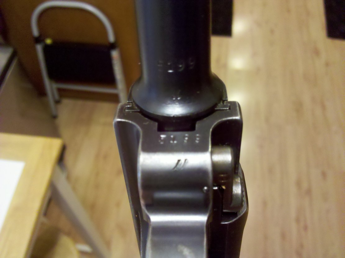

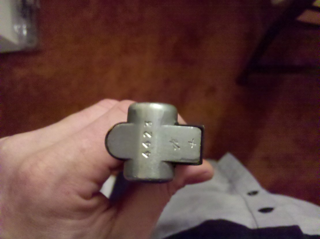

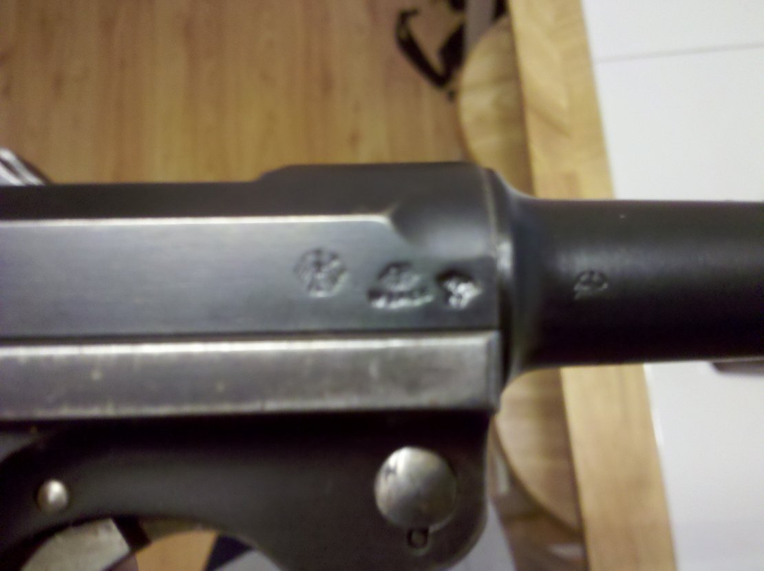

hey guys. I got my first luger a few weeks ago as a gift from my father. I have been trying to date this thing since. This site is a great tool and has taught me a lot since. here is my question and what I think i have. It is serial number 5199, it has a U stamp on the barrel and on the front receiver, it has a blank toggle and no date stamp. All the internal numbers match (99). I believe it is original blueing. the magazine is not matching however period correct (4423). The second proof mark along top has WaA66 under the eagle. it also has a period correct holster with no numbers or stamps. I think this is a "sneak" (based on lots of reading posts around this site). now to the questions. It also has L.D.134 stamped on the front of the grip strap. Does anyone know what unit this was? As far as age when do think this was manufactured? I also figured it was a Mauser based on reading other posts on this topic. I will try to post some pics and see what you guys think. Also around what do you guys think its worth? I plan on shooting and enjoying this piece of history just wondering what I have.
FAST46BIRD is offline   Reply With Quote
Unread 04-01-2011, 12:45 AM   #19
Don M
Don M's Avatar
Join Date: Aug 2004
Location: Houston, TX
Posts: 1,429
Thanks: 67
Welcome to the forum, William. You have a very nice example of what is currently called a 29 DWM. It was manufactured in 1929 by BKIW and was among the last Lugers manufactured by them in Berlin before shipping all the production equipment to Mauser in early 1930. Yours is one of the approximately 9,000 issued to the Prussian Landjägerei (rural constabulary) - in this case the Landjägerei of the administrative district of Düsseldorf.
Yours is a very collectable, apparently matching Luger. You may want to think twice about shooting it. If you break a numbered part, you will seriously hurt its value.
Don
donmaus1@aol.com
Unread 04-01-2011, 02:34 AM   #20
FAST46BIRD
Posts: 4
Thanks for the info. I do know the grips have been replaced with aftermarket wood replacements. When my dad got it he said it had white plastic (possibly bake lite) grips. Did any lugers have white grips originally? What price range would you estimate this example at. Also looking at some of the other examples on the site some police units have a dimple above the magazine release and the left grip. What was the safety modification and should mine have had that as well since it was a police/commercial? Was that only on the reworks?
