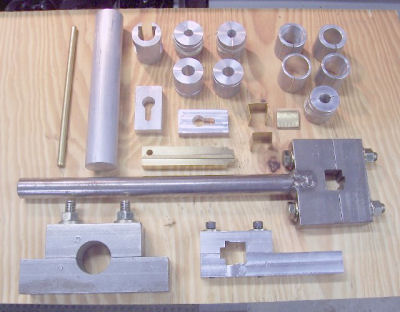

Here's a quick & dirty guide to barrel swapping...
We get at least one post a month asking about swapping Luger barrels...I have a receiver with a 4 3/4" Tikkakoski barrel on it, I want to swap in a 5 7/8" barrel...here's what I use to do it...
- Barrel vise
- Action wrench
- Receiver block [brass]
- Squib rod [brass]
- Receiver shield [brass sheet]
- Receiver/block bolt
- 3/4" wrenches
I clamp the barrel in the vise with the squib rod inserted up to the breech face. Barrel has a turn of masking tape so the finish doesn't get scratched. Squib rod keeps the barrel from collapsing from the pressure of the vise. Receiver block is installed with bolt. The block keeps the receiver from twisting while unscrewing. Brass shield draped over receiver to prevent scratching, wrench is attached.
Receiver is unscrewed. One sharp smack with my hand on the wrench usually breaks it free.
5 7/8" barrel ready to go in. All threads cleaned. Threads get a light coating of grease. Masking tape on barrel again.
Receiver is screwed in by hand until it won't go any further. It has ~1/16 to 1/8 turn until the barrel/front sight is perpendicular with the receiver [or one extractor notch width]. Just right.
Receiver block installed again, wrench attached with brass shield. Receiver tightened until it is perpendicular with front sight.
Everything taken apart. New barrel installed & ready to go.
I sometimes use a special fixture that clamps to the front sight base to attach a spirit level (not shown), and another spirit level laid across the receiver to get the barrel and receiver perpendicular. Here's a pic of an artillery barrel being leveled/installed using the spirit levels (but not the front sight fixture). Also, for clarity, I have left the brass receiver block off for the pics (but it is used for final assembly).
Some slight tweaking may be necessary to get the F&R sights aligned after leveling/installing.
That's it. I spend about an hour doing the whole job, including cleaning. There are other ways to swap barrels, but this way works for me.

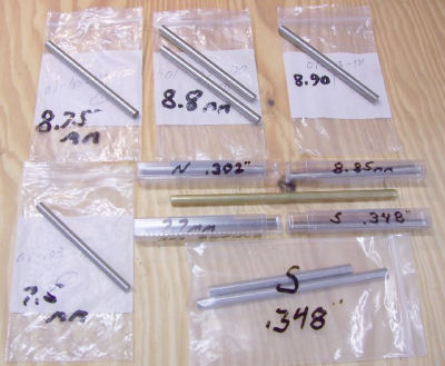

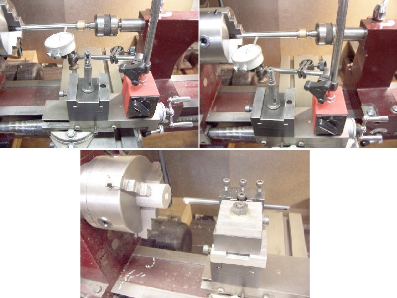

Edit: I've added some more inserts for the barrel vise, more ground drill blanks for the barrel reinforcements, and use a dial indicator for the taper. I replaced the Grade 8 bolts in the barrel vise with Grade 8 studs and nuts/washers.
A few of the two-piece inserts are for Nambu, Lahti, Mauser, and M1911/Star BM/Tokarev. The single-piece inserts are for rifles that I will never own (they came with the barrel vise).
Because different Luger barrel lengths have different tapers, I make my own inserts. I use 1 1/2" 6061-T6 aluminum rod bored to the specific taper of the 4, 6, 8 inch 9mm barrel; 30 cal 'pencil profile' uses different inserts.
I reinforce the bore with ground steel rods [drill blanks]. If you don't reinforce the bore, it will squish.
Figuring the taper for the odd insert is easy. I mount the barrel between centers and mount a dial indicator on my compound rest. I run the dial indicator along the barrel taper and adjust the compound rest until I get zero along the entire length of the taper. Tighten down the compound rest & tool post, drill out the chunk of aluminum rod to about 7/16", then bore the taper using the compound rest travel. Perfect taper for that barrel.

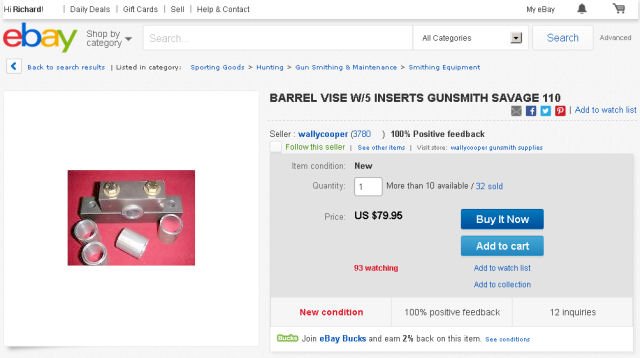

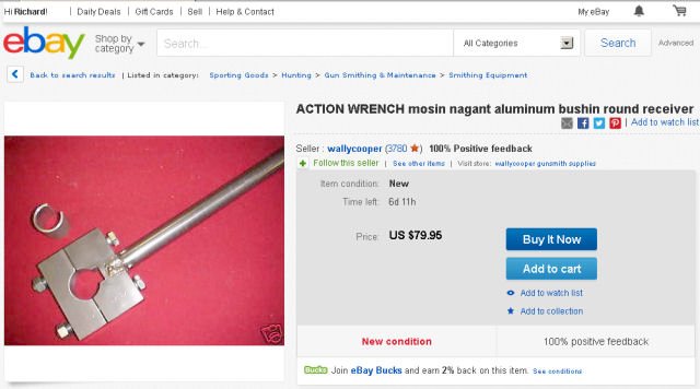

The eBay username of the maker of the Luger Action Wrench and Barrel Vise is wallycooper. He makes the wrenches and vises for dozens of different firearms. He does a run of a specific firearm tool and then moves on to another. Here's a couple of pics of what he has currently on eBay. An eBay email about Luger vise/wrench availability should get you an idea of when they will be available.
Barrel reinforcement rods ['drill blanks'] are available from Travers in a variety of sizes - Metric, number. letter, and fractional. The barrel needs this support during clamping.
The wrench, vise, and barrel reinforcement rod are what I consider bare minimum of tools to swap out Luger barrels. I make my own vise inserts now, since Luger barrel tapers can differ. And I still wrap the barrel in one layer of 2" masking tape to reduce/eliminate marring the finish.
