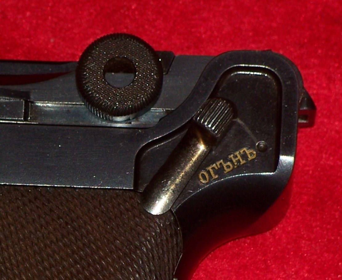

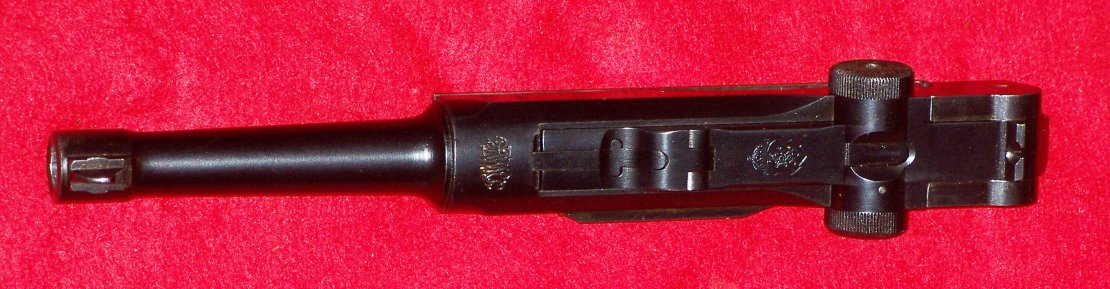

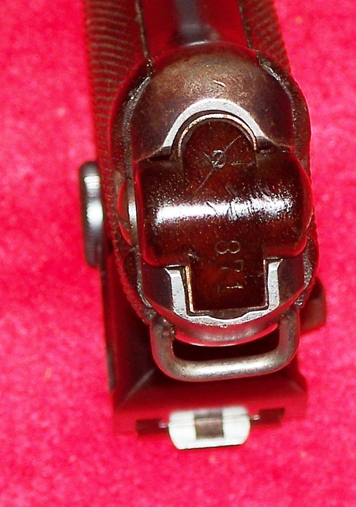

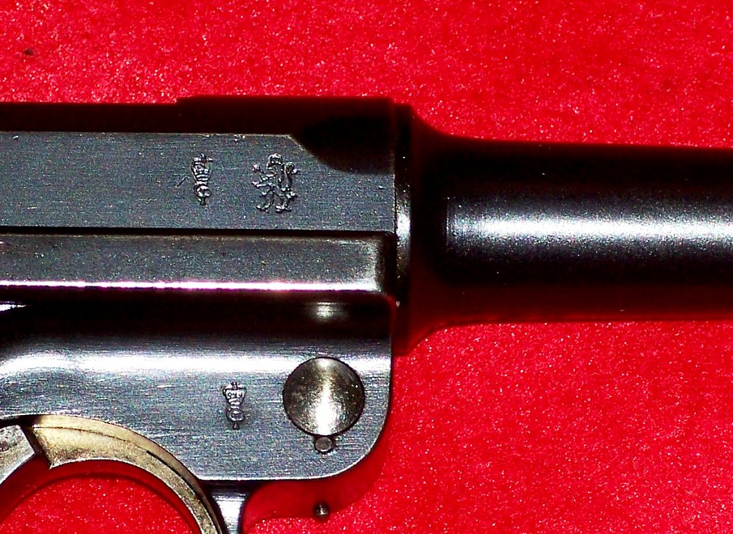

ALL..... I HAVE A 1908 BULGARIAN ( ALL MATCHING INCLUDING MAG, ORIGINAL BLUE ) THAT HAS A PROOF ON THE RH RECIEVER THAT I DO NOT RECOGNIZE. ANY HELP FROM ANYONE ? THANKS BUNCHES !!

Nice! Could you show side pics??? I don't think I've ever seen the lanyard loop at the bottom of the grip frame...
Old 01-11-2011, 04:03 PM   #3
Postino,
Only the Bulgarian contract Lugers had the lower grip placment of the lanyard loop if memory serves me correctly. Consequently no stock lug on these pistols.

Nice looking Bulgarian!!! The Crown/GP is a British (London) proof. According to one reference I have, its use dates clear back to black powder days, since 1637. Evidently it spent some time in the land of tea and crumpets (seems a bit odd that it would have that particular proof).

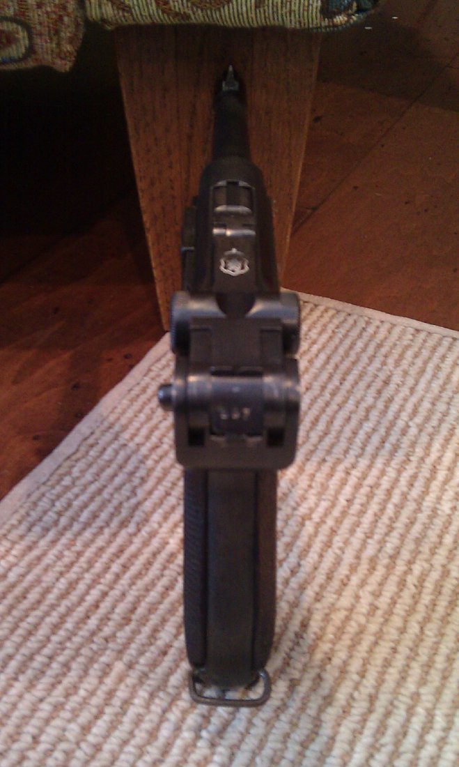

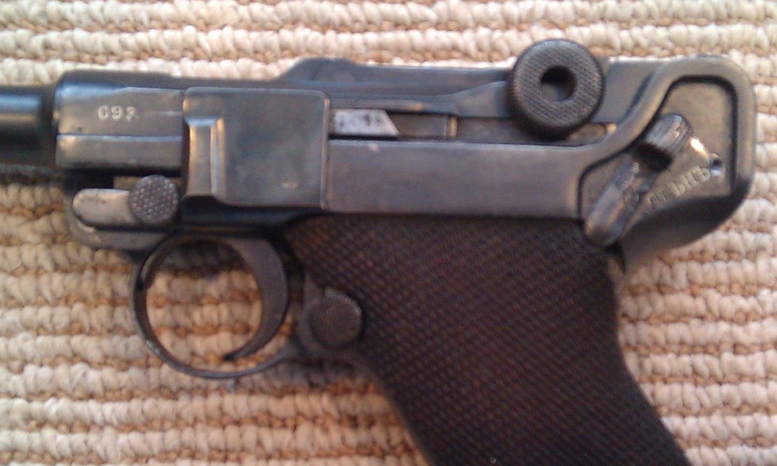

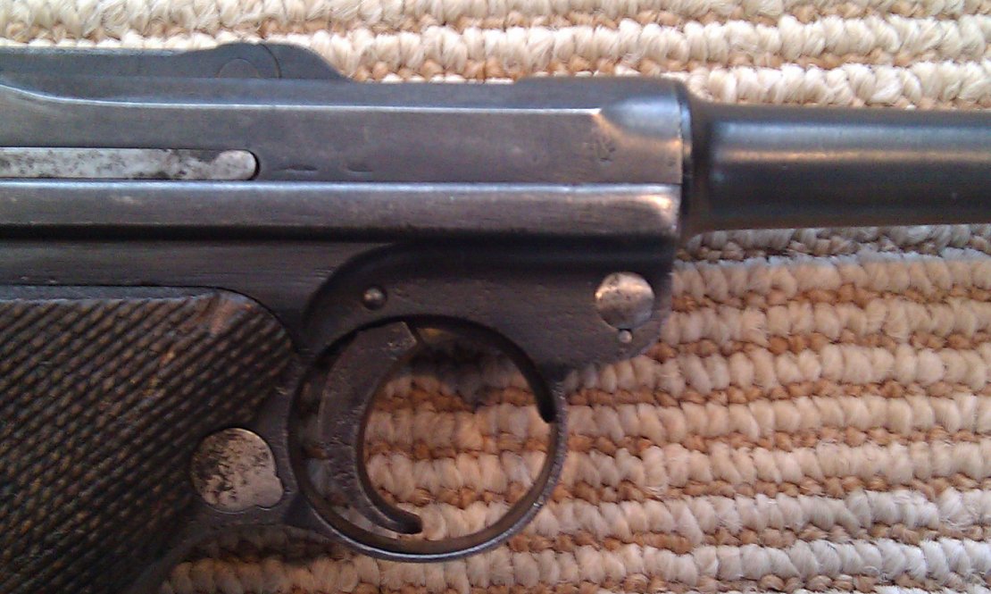

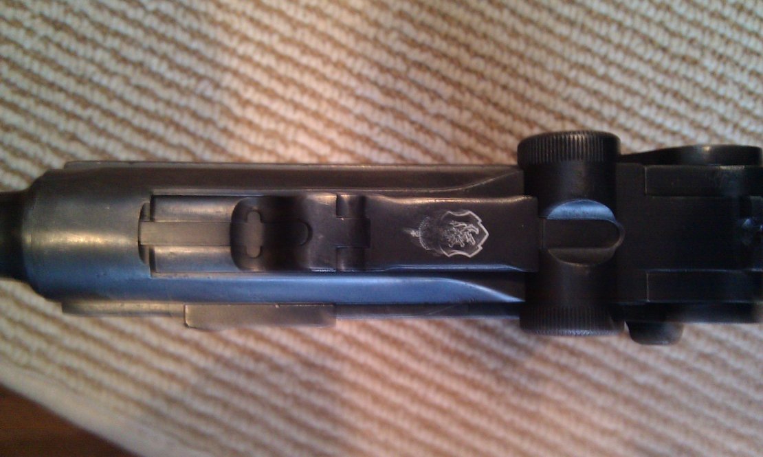

I have attached some photos of my 1908 Bulgarian. This gun appears to have been through hell and back. I am sure it has action in multiple wars, and has been refinished at least once. There is no remaining straw and the DWM on the chamber was removed at some point. The grips are mismatched replacements, but otherwise all parts are matching except the magazine. The lanyard on the previous gun seems to be welded to the frame whereas mine swivels. I don't see the proof mark that was previously inquired about, but it may have been removed during a re-work.
I found this gun in West Virginia while my father was undergoing bypass surgery. I had some pretty tense hours of time to kill, so I purchased a free-ad publication in the hospital gift shop. This gun was advertised and I bought it. I consider it my dad's good luck charm. Even thought the gun is rough, I figured it may be a while before I come across another one in any condition.
Thanks for looking.
Doug

Hey Doug, Nice find. The corrosion on your ejector tells me that it might be the most likely part to fail if you shoot this gun. you might want to source a replacement ejector for shooting purposes.

The majority of these pistols were purchased from the Bulgarian government by Interarms, who had a warehouse in Manchester, UK. That might explain the British proof mark.
The guns that were in the worst condition were purchased by Erma in Germany, who appearantly lost quite a bit of money on the deal, because of the extensive reworking needed to create guns that were functional and safe to shoot.
Vlim...... thanks so much for the info ! I'm putting all the help like this with the gun so it's history will travel with it wherever it may go.
