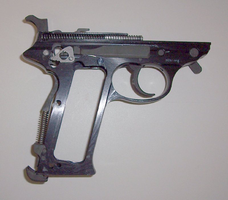

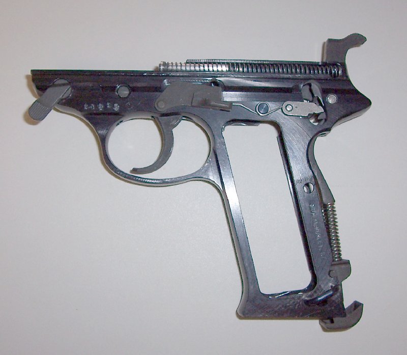

Frame is marked "GPC W.HURLEY NY" under left grip; "GERMANY" above front of right trigger guard. This frame appears unused, only scratches on it are from me...Bright shiny black finish, sharp edges [ouch!], late hex reinforcement for locking block, serial 38137. All steel parts on frame (except springs, pins, & sear) are Parkerized and appear unworn.

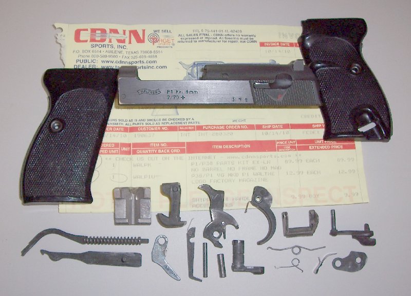

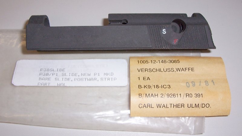

CDNN parts kit came with everything except [stripped] barrel, magazine, and frame. Slide was received built up, dated 7/79, "Kal" caliber marking, Parkerized finish, paint still in safety markings. Cartridge indicator cover is quite worn at front, nowhere else. Circle/dot on left side; square containing eagle (?)/413 on right side. 3-digit serial 179. Rear sight is a "U" w/white square underneath.

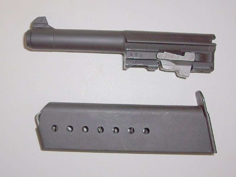

Barrel appears new unused, marked "INTER ORDNANCE MONROE NC" over "WALTHER P1 9x19 GERMANY" on bottom. Bore bright & shiny; no pits or frost. Locking block & actuating pin in raw metal (no finish). Circle/dot and square w/eagle-413 on front. Front sight is a "3" w/white dot. This is a late P1 barrel with the flanged (not pinned) liner.
Extra slide is marked 7/81, stripped, Parkerized, no wear, paint in safety markings.

Magazine is Parkerized, marked "WALTHER" over "P1 9mm" on left bottom; "1005-12-120-0892 12/65" on bottom rear spine.

Because the frame was semi-built up and the spare slide & 1 set of grips was included with the frame, I ended up with a lot of spare parts. In fact, everything in the pic of the CDNN parts kit (except built up slide) is spares.

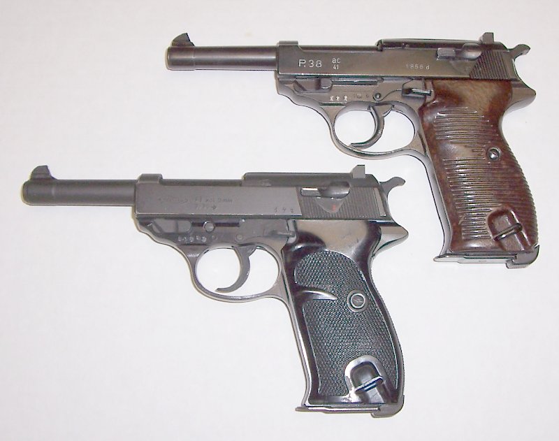

The P1 grips feel flatter/thinner than my P38 grips (last pic)...I
think I need a set of black fluted P38 grips...
BTW: Both slides are the wider style with the high sidewalls.
