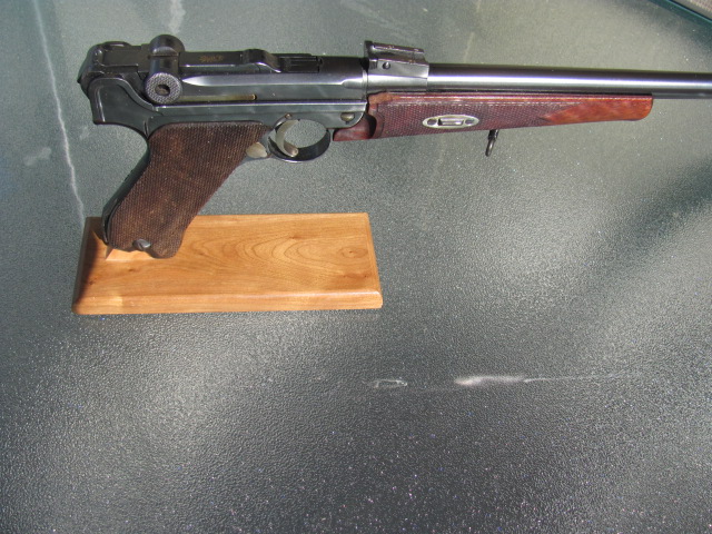

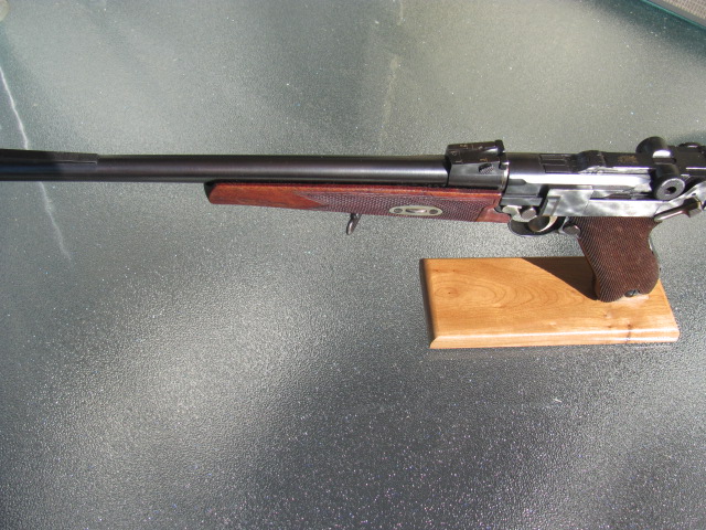

Although I will never fire my 9mm carbine, I wonder if there were special rounds made specifially for the carbine due to long barrel

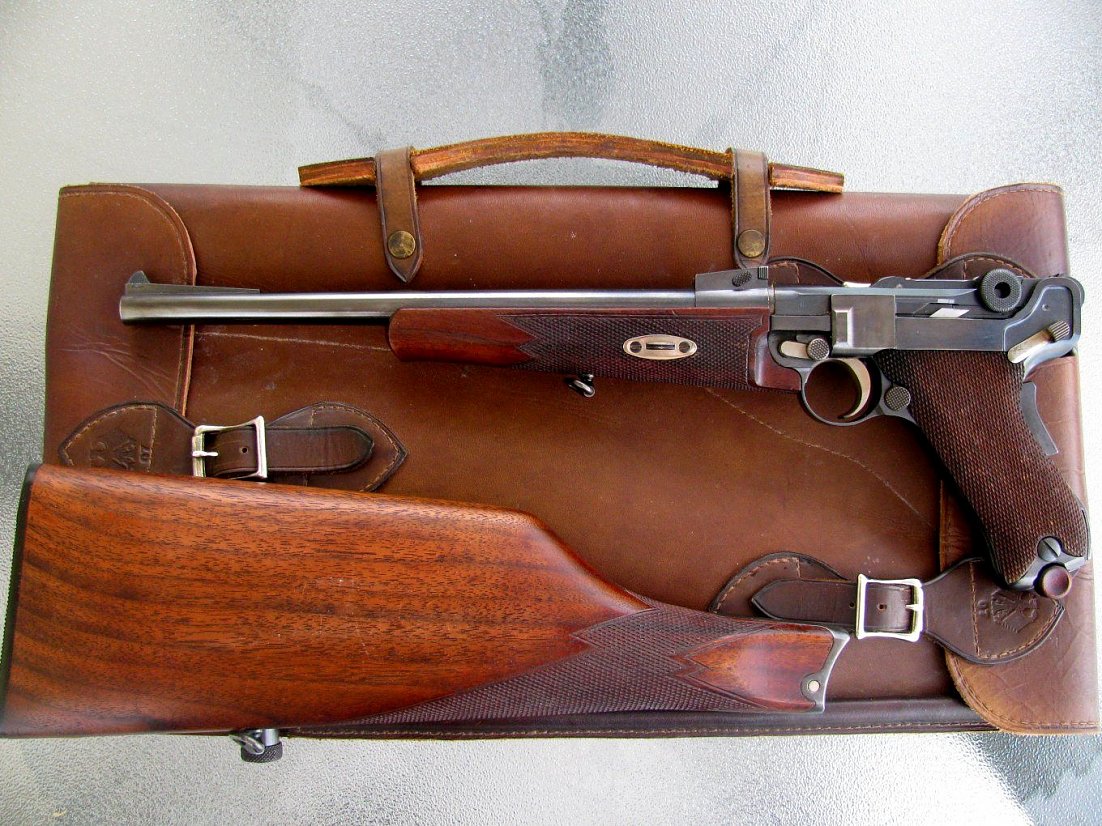

Unread 12-07-2010, 08:13 PM   #4

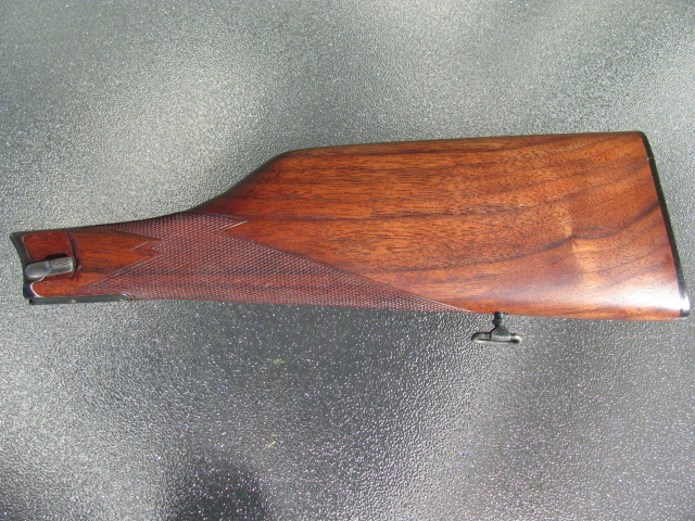

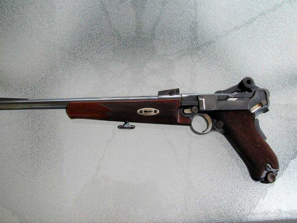

Default It has to be a full load as its like a small rifle
I know I do have a box somewhere when Ralph Shattuck sold it to me! The carry on case was hand made by Jerry Burney. There are no import marks anywhere, GERMANY!

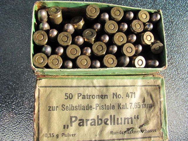

The carbine had a special high power load. These were dangerous to fire in a regular luger so the cases were blackened. The head of these was marked DWM 471. This at least applies to the 7.65. I am sure others know a lot more about this than me. Bill
Unread 12-08-2010, 10:32 AM   #6

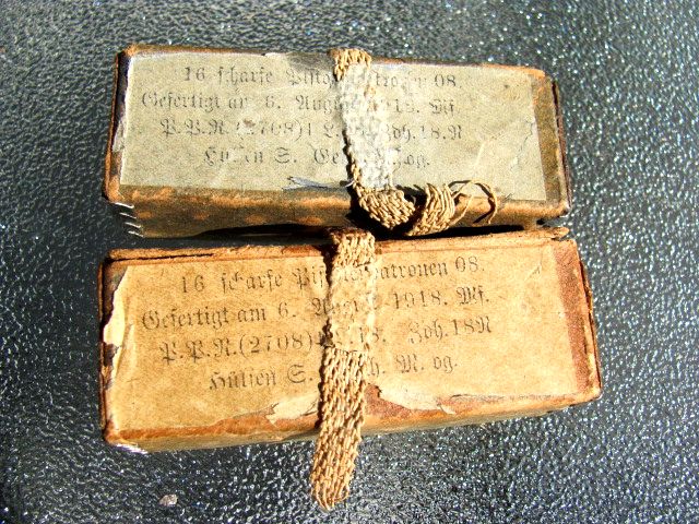

Default Your right on the ammo Gramps included with His carbine!
Almost full!

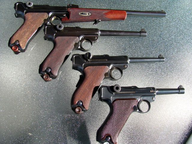

Unread 12-08-2010, 11:28 AM   #7
Default Different barrels
Im asking santa for an artillery

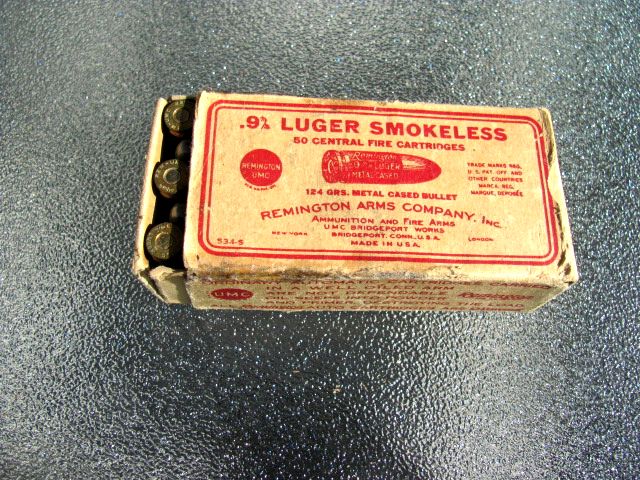

Default These are the only ones i've cam across
What would You suggest?
Unread 12-08-2010, 01:45 PM   #10
I would suggest a commercial brand of 9mm ammo from the 1920s for showing alongside a carbine.
For an Artillery (LP08), the WW1 boxes are the best option.

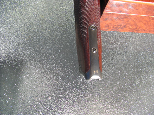

Unread 12-08-2010, 02:12 PM   #11
Default Its Real
Any more proof just say so!I have never shot any of my lugers. Somedaye I find a shooter. Maybe an artillery!
